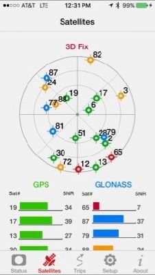

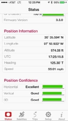

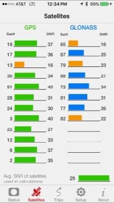

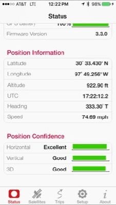

I was out today and had the time to do some testing using a SkyPro XGPS160 receiver to check the speedometer accuracy against a high-accuracy GPS unit. It's not military accuracy but it's very good.
During the tests, the unit was reporting Excellent Horizontal accuracy with 29 satellites being tracked and an excellent signal-to-noise ratio. It was tracking a combination of GPS and GLONASS (Russian) satellites at the time as shown in one of the photos below. My tires are Michelin Pilot 4S's with a few hundred miles of wear. The road was either a wide-open high-speed Texas toll road or an access road next to it.
Samples were taken at a number of speeds. At each speed, the cruise control was set and when the car was on level road with the speedo reporting the set speed I took a few screenshots for each speed. If there was a little slope and/or it wandered above or below the set speed I didn't take the screenshot. Here are the results:
Car reporting 55 - GPS Average 55 (54.89, 55.01, 54.55)
Car reporting 60 - GPS Average 60 (60.19, 60.19, 60.07)
Car reporting 65 - GPS Average 65 (64.90, 65.36, 64.67, 65.25, 64.56)
Car reporting 70 - GPS Average 69 (69.74, 69.05, 69.85, 69.39, 69.16)
Car reporting 75 - GPS Average 75 (75.03, 75.49, 74.46, 74.69, 74.69)
Car reporting 80 - GPS Average 79 (79.40, 79.17, 79.06)
Here are a few of the speed and quality-related screenshots:
Damn, that's probably about as accurate as you can get. Since there's no longer a restriction on the data, it's probably as accurate as most any GPS, even military stuff!
