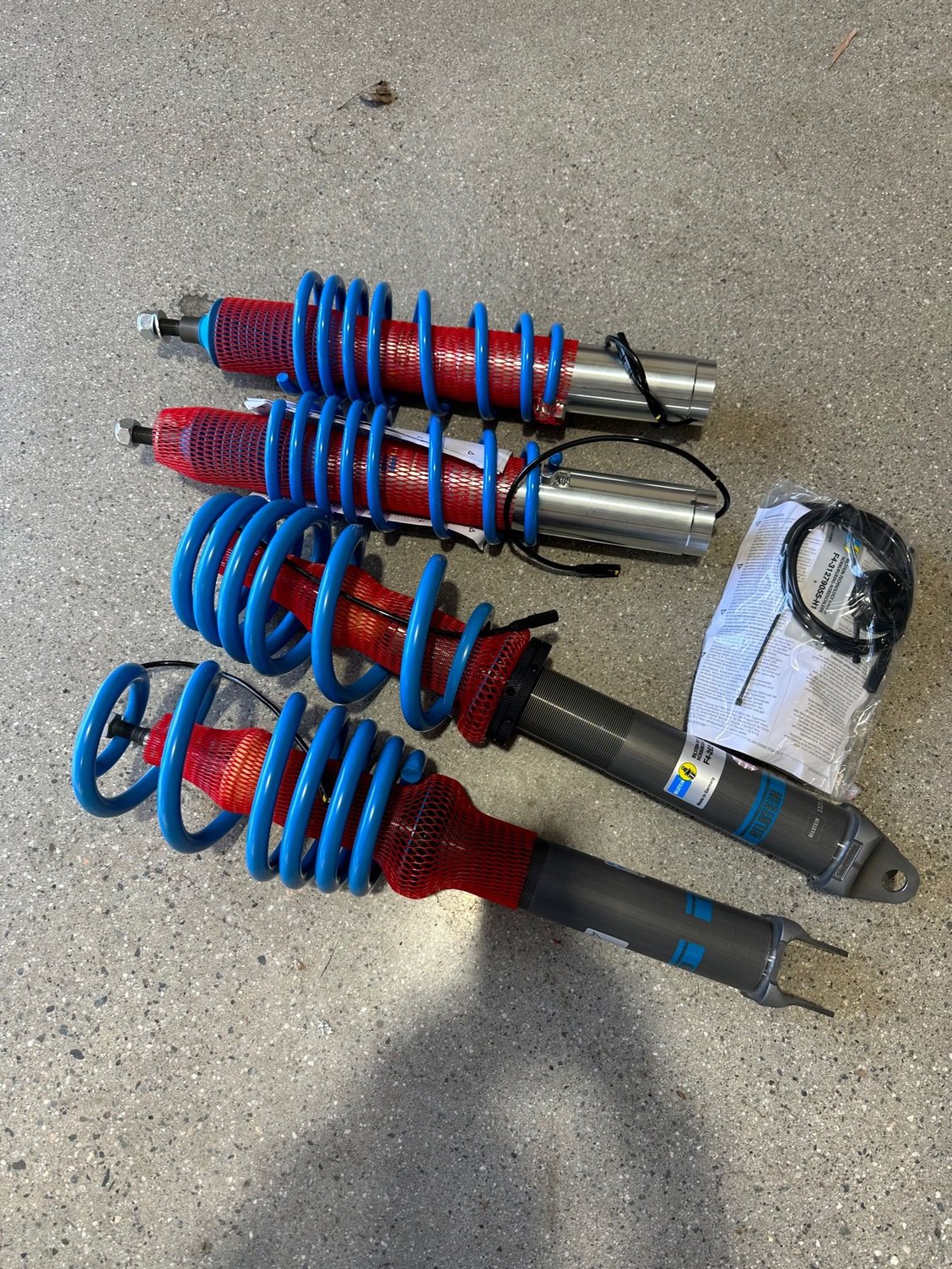

Just got mine lowered with a full kit from Bilstein. Very happy

How do the B16's ride compared to factory suspension?

6Speeddave - the ride is very comparable to stock, very nice and comfortable, even with this lowered stance. its an immediate feel and response. Hit the sport suspension, hit the canyons and the car flattens out brilliantly. Such a huge visual and driving difference. Car doesn't lean or wash out anymore, very flat and forgiving. The alignment after install are stock specs. I'm going to enjoy it and then take the time to figure out what else I would like.
