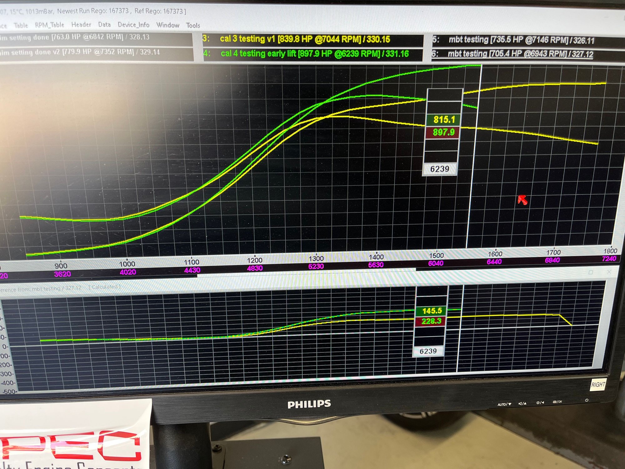

Welp, one of the turbos blew yesterday during final tuning and testing while trying to slowly turn it up. It blew up at around 28-30 psi. Evospec ordered a new CHRA and will try to get it in tomorrow to finalize everything for me. So dang close, I was supposed to pick up the car tomorrow lol. Oh well, it's the name of the game.

I think the CHRA just seized up or something, he said no damage to compressor or turbine housings so a simple CHRA swap will do it. I'm just happy to see the power curve, it looks really damn good with a nice powerband from 5k to redline. Plus DA was about 5k yesterday and 115* in AZ. Once I get the car back to Cali I'll test it on our dynojet with the cooler weather and better DA. I think 1200whp is going to be the max this can make, if that.

The number on the bottom of the Graph is boost in KPA? What fuel are you getting these numbers?
I thought with G30-770 the car should be making upwards of 1.200 whp at 30 psi, if I am not mistaken.

No, it's some sort of difference calculator to show the difference in power between the graphs. I saw a log of that run and it was at about 28psi. Not sure how aggressive timing is, but they did MBT testing so I assume it's the most it's got. I've seen about 32psi to hit 1kwhp with similar sized turbos on this engine. I'm on full E85.

I think it will require 36psi to get about 1100whp with these turbos. Which is on par with some of the stuff I've seen with Sambos XR kits. Keep in mind the ambient temps during these dyno pulls are 115* in Arizona heat. Once I get the car back and dial it in a bit more on the streets and CA cooler weather I will strap it on our in house AWD dynojet to see what it makes
