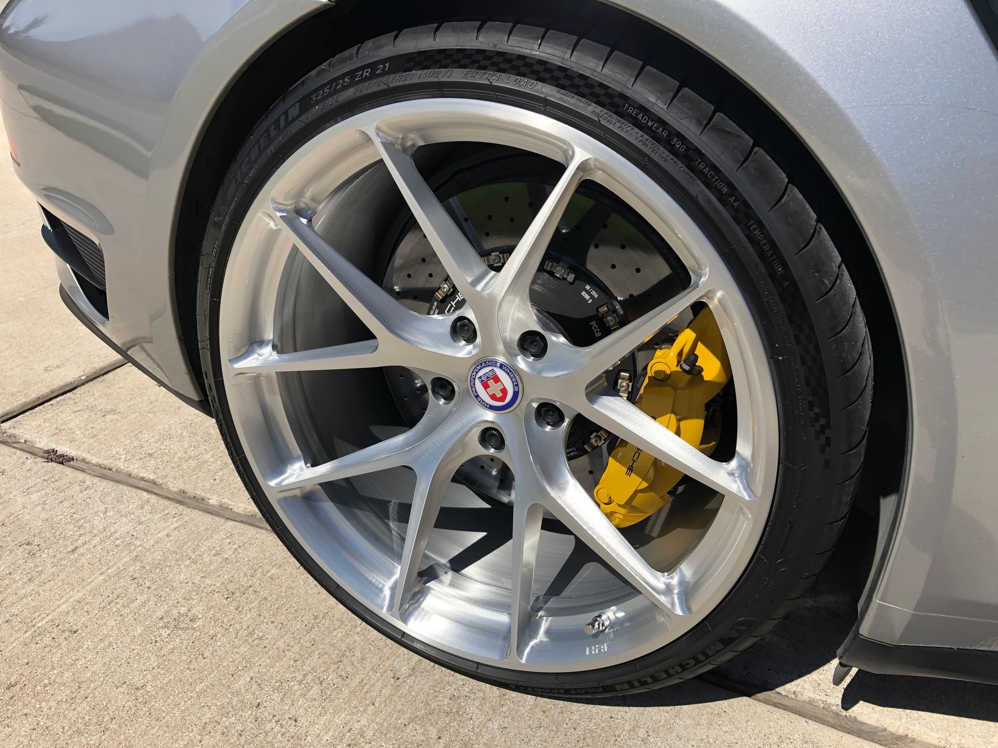

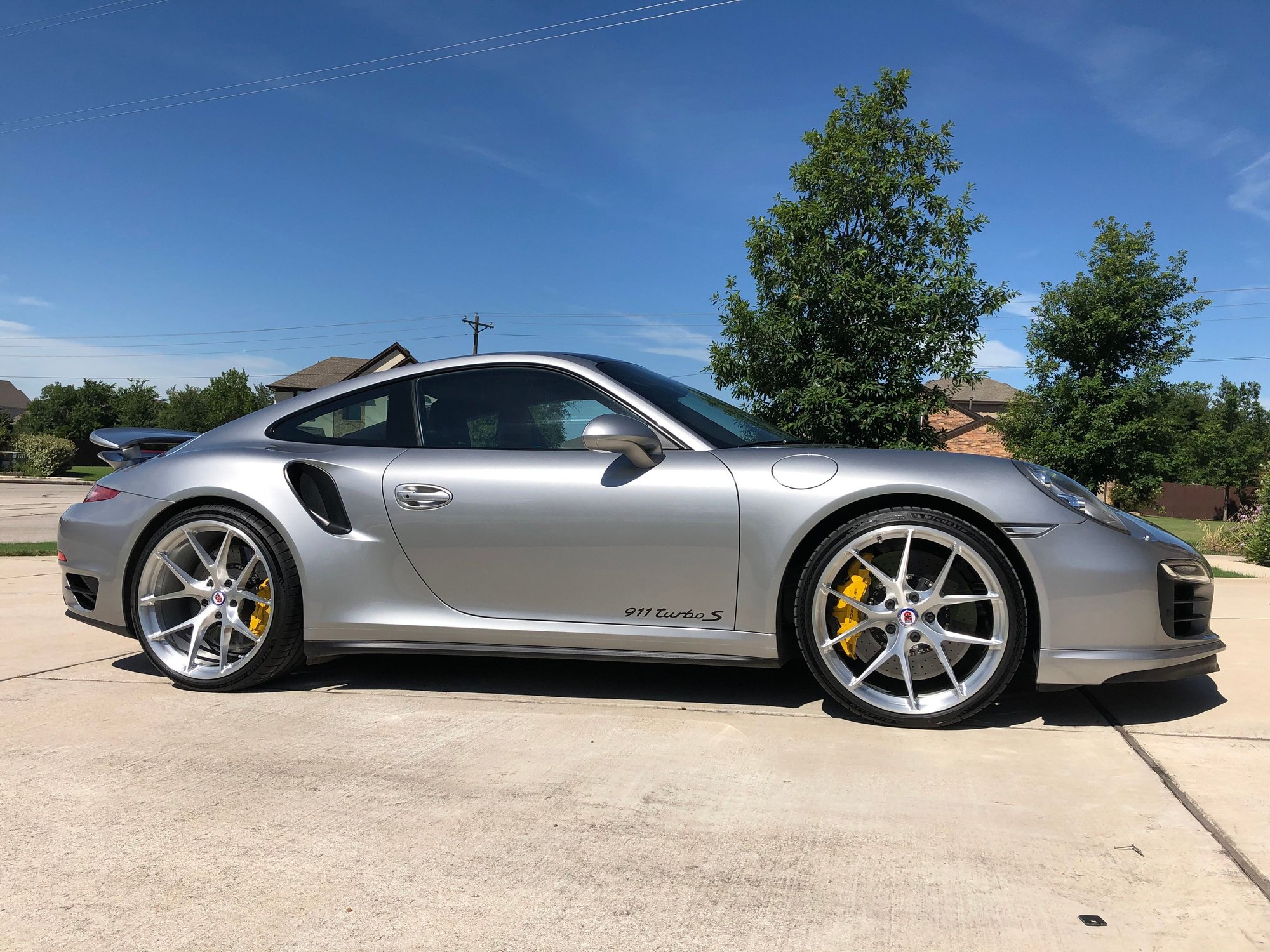

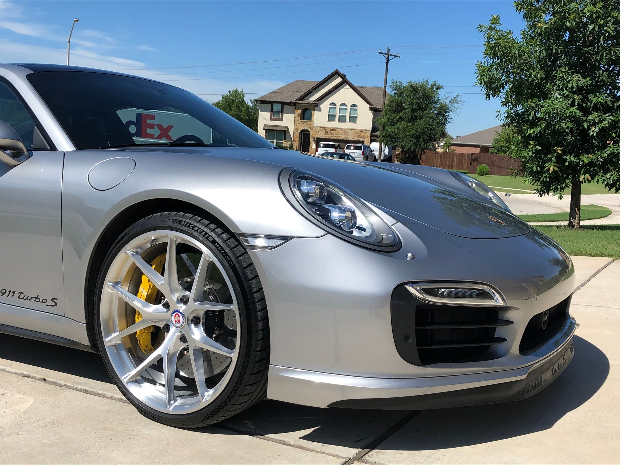

I applied Armor Shield IX by Avalon King. Easy DIY, and only $45 delivered, after the coupon code. I pulled the wheels and, after a thorough cleaning, applied to the barrels and face of the wheels, as well as all the car paint. I’m pretty impressed. Pics were taken with an iPhone.

It’s easy. First wash the car in a car wash soap that removes all wax, I used Chemical Guys Wash & Gloss (Autozone), then clay bar the paint. Then a wipe down with Wax & Grease remover (Dupli-Color from O’Reilly’s). Then just a quick wipe down with Isopropyl alcohol. After that, apply to about a 2’x2’ ft section, let it sit for a minute and wipe off. I let it cure in the garage for a couple of days, and avoid water for 7 days and that’s it. No need to wax for 3 to 5 years based on use. The gloss is really noticeable.
