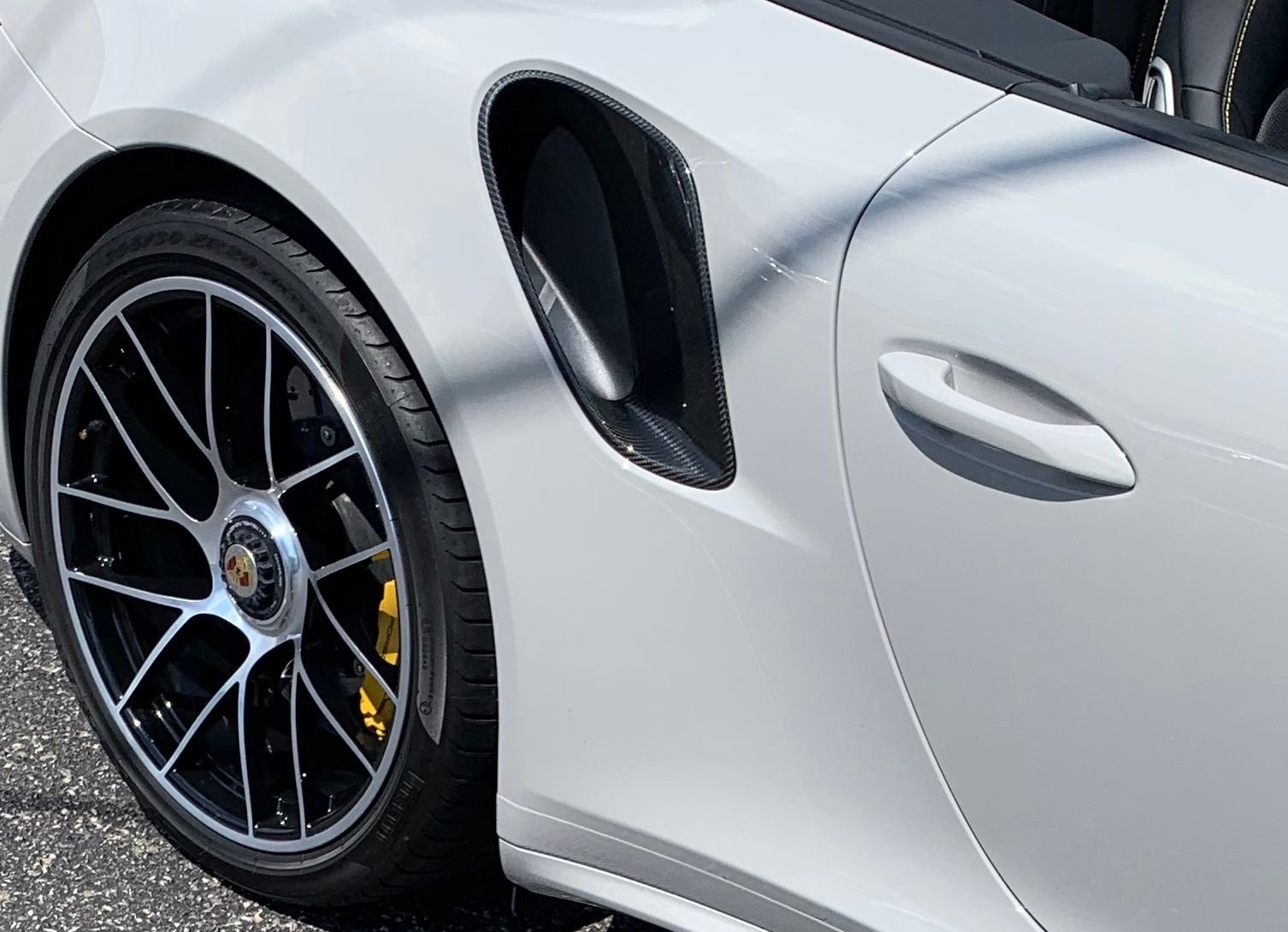

Old inlets out new inlets in. Put the RS inlets in last night. Easy out and in. Great fit, I really like them.
I thought I would prefer them in carbon but now that I see them I really like the look of the satin OEM pieces.

Very easy install. Pull forward to remove the old ones. Can be stubborn but they will come.
Line up the pins and push in the new one. Fit is quite good. Look is bolder than original.
