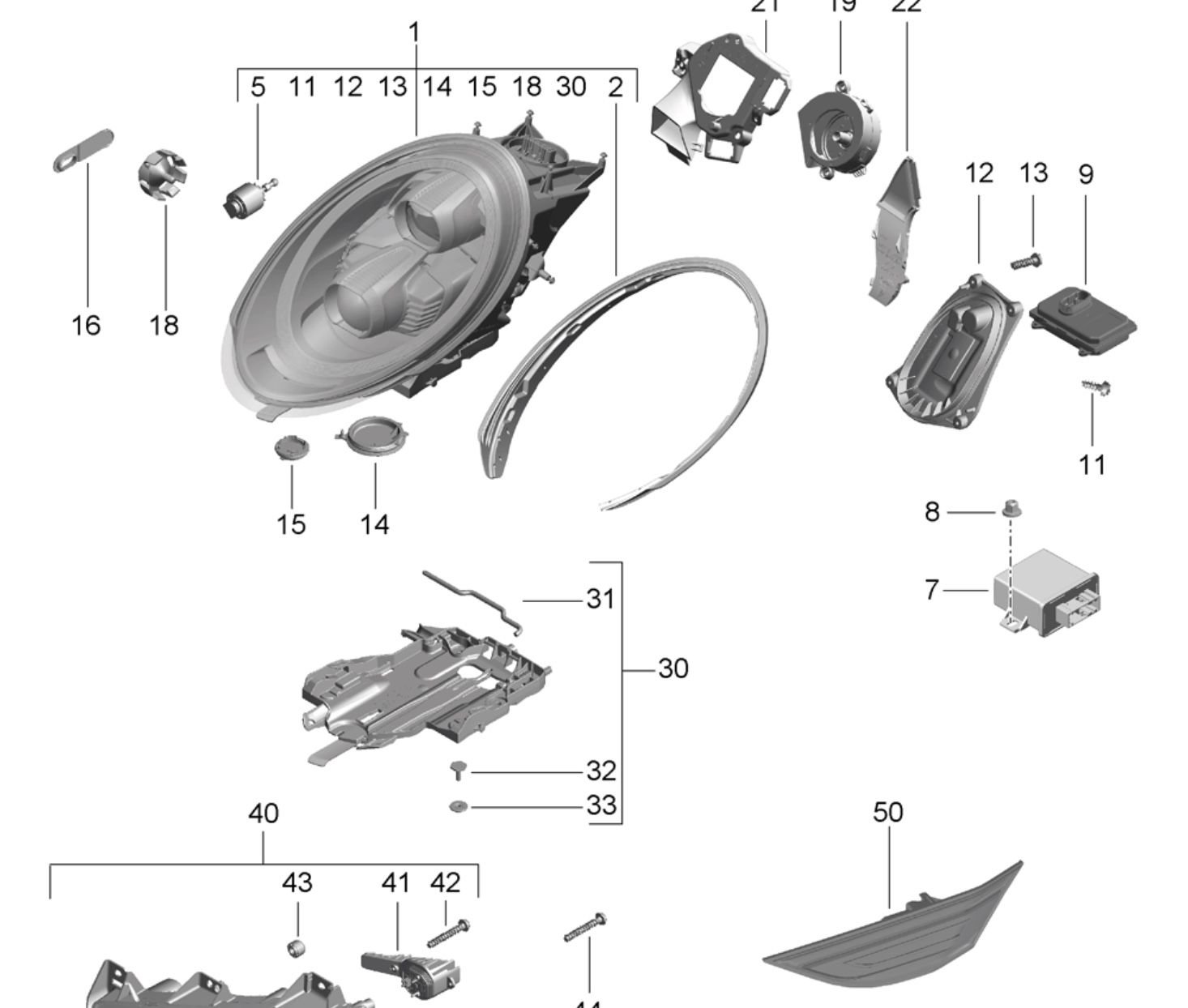

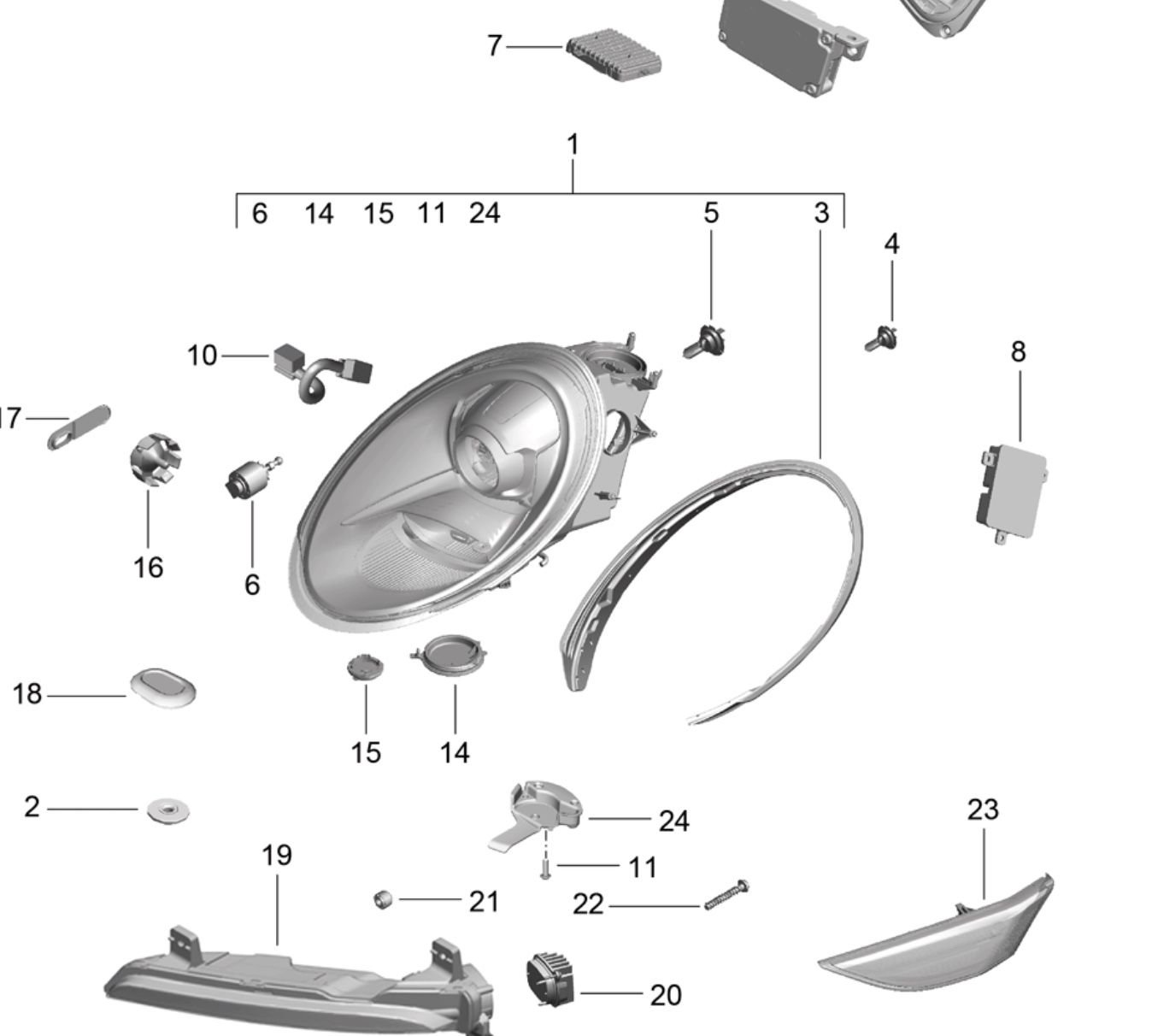

Looking at the PET, the headlights are different part numbers for the .1's and .2's. The .2's are bolted in, and the .1's have the locking mechanism. Maybe you could add the locking mechanism, but you would need to get a look at the 991.2 fender to see what they've done with the head light mounts. Might be able to be done, but wouldn't be plug and play.
Took a look at the front fenders and they are the same for the 991.1 and 991.2, which means the headlight mounting area is the same. I would bet just adding the locking plate would allow the .1, lights in a .2
991.1 - item 30 is the locking system
991.2 headlight
