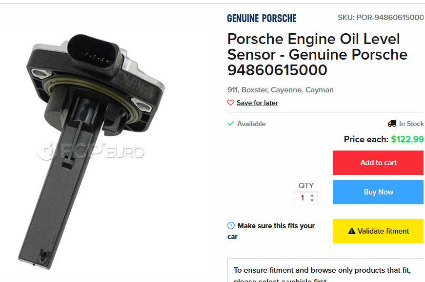

I'm fairly new to Porsche cars and was surprised/alarmed to 1) no dipstick to physically see/check the oil, and 2) the oil "gauge" is not really accurate. Neither is the coolant temperature "gauge", but that's another thread.
My car is parked in a 1 car garage, and I have a wheel chock to stop it at the same spot. So, I know when I use the computer to check the oil, the car is consistently at the same level. The other day I came home and as soon as I got it parked, ran the oil check (which we know takes about 1 minute). It showed 1 bar low. I shut it down, took the groceries inside and put them away, which took about 5 minutes. I went back out, started the car and initiated the oil check process. It showed full - all 4 bars.
I guess that makes sense if the time I went inside gave the oil a chance to let gravity do its thing and drain down to wherever the sensor is. I'm not clear on how the sensor works or where it's located, but this seems like a plausible theory. I guess the point of this is, don't trust 1 reading of the oil status - take multiple readings. I think I'll do some research about the oil sensor and how it works...
Edit to Add - I found this description; "The oil level sensor is a long plastic rod that extends into the oil in the sump. It has 4 wiring connections (in a common plug) where the sensor emerges on the top of the block. Two wires measure a resistance corresponding to oil level and the other two wires measure the oil temperature".
It appears letting the oil drain back to the sump for a few minutes before running the oil level check will show you a more accurate level. What the part looks like -
