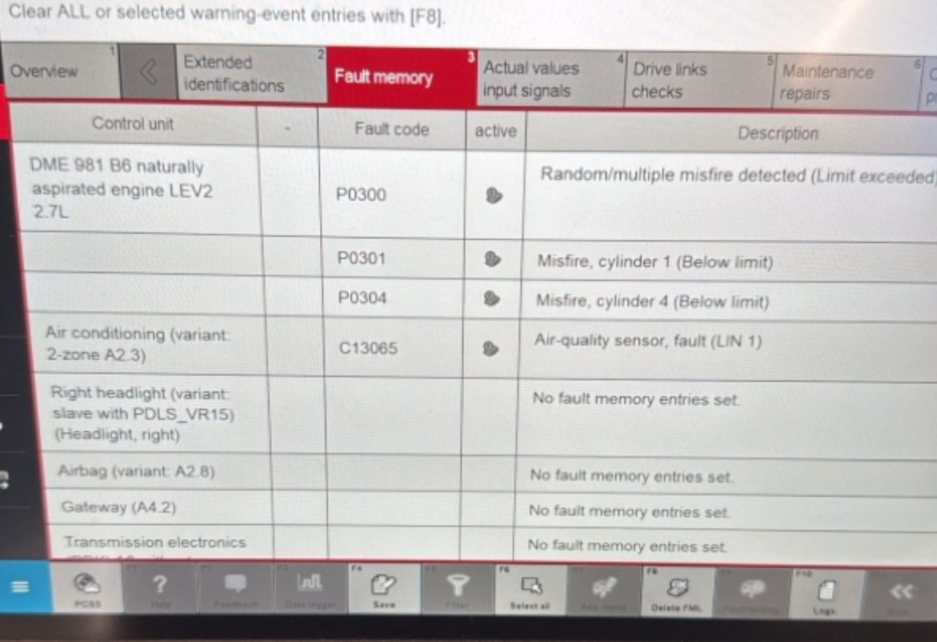

Photo of error codes from the first service center:
Initial engine codes

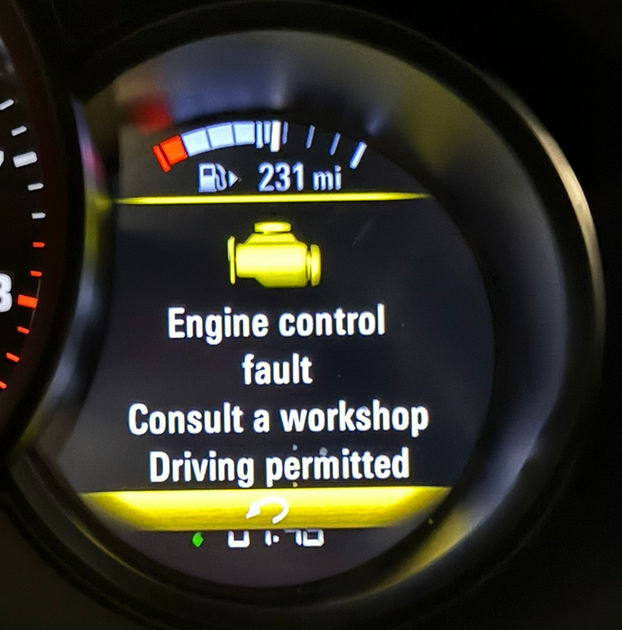

Current Situation: Less than 4 days later, I turned on the vehicle to a "Engine Control Fault, Consult a workshop, Driving permitted".
Dash code after first service

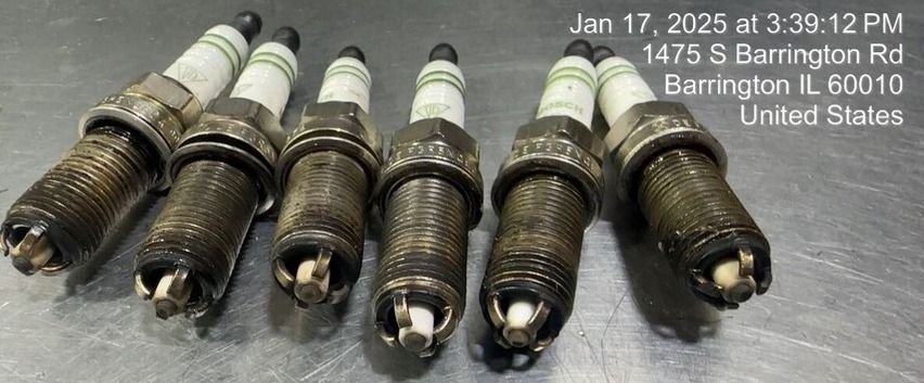

They performed a leak-down compression test ($987) which they said passed with flying colors and they replaced the spark plugs again. The dealer provided a photo of the spark plugs they pulled out which should be a week old. They appeared dirty and eroded, suggesting the first service center may not have replaced them. The dealer claims the coil packs were replaced in 2023 about 15,000 miles ago and that they have minimal wear and tear and don't need to be replaced. They claim the diagnosis is not covered under the warranty, and that they can't replace the coil packs since they have to provide a report to the warranty company which proves exactly whats failing and the coil packs are fine. They still have my car, "vehicle is currently not misfiring what so ever. We would like to let the vehicle sit over the weekend and perform one final quality control check before releasing it back to you."
"1 Week Old" Spark Plugs:

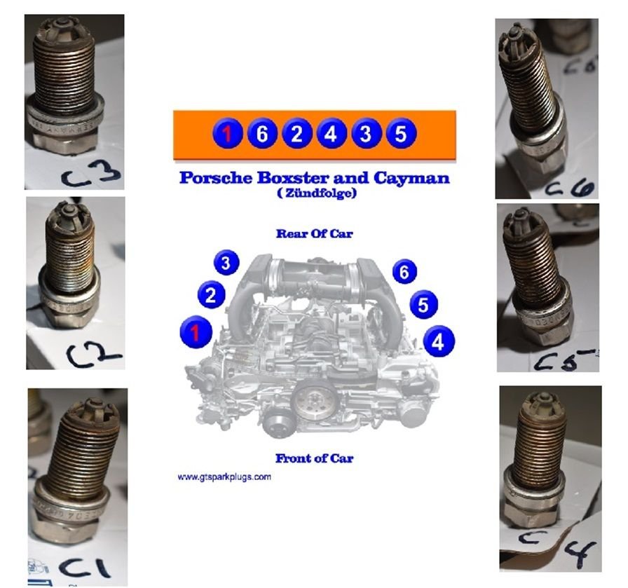

For a comparo here's a pic of my old spark plugs changed out last Oct. 2024.
They were 5yrs + 3mo old and had 21,665 miles on 'em. (DIY cost from FCP Euro was $289 + my time ..for the entire job).

Thank you for the pics and the diagram, super helpful! I am slowly getting more and more confidence to just do this myself. I was looking into getting the Durametric reader too, so I can read my own codes. I’m sure there’s a post on this forum, but is there anything special post install of the coil packs and plugs I need to do?
