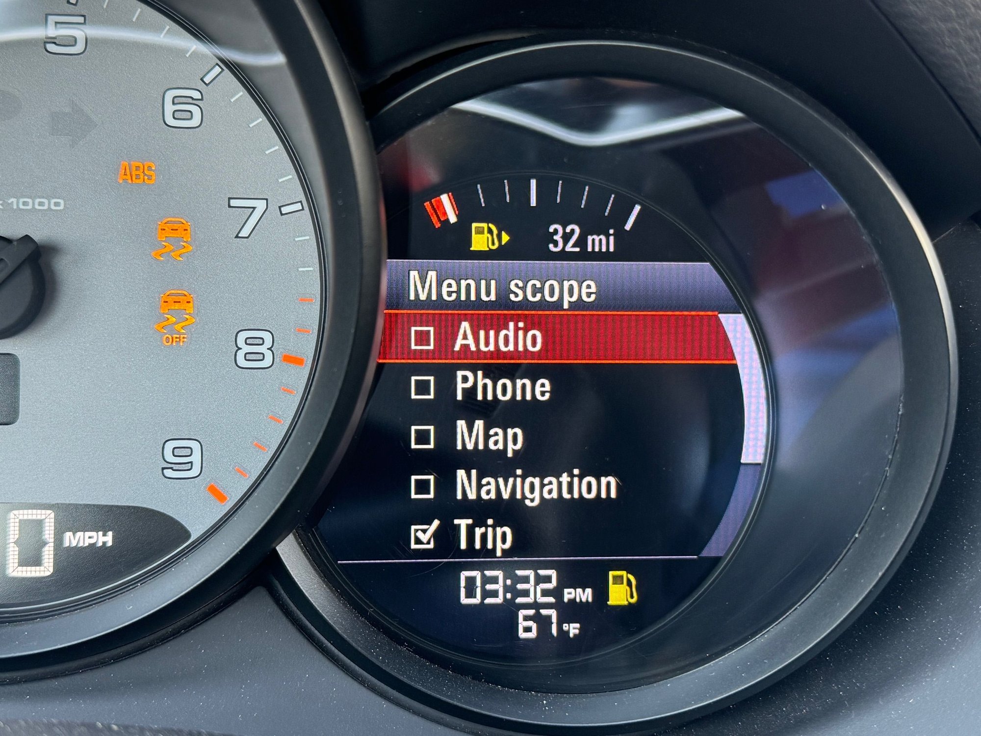

You state that you have unchecked all that is related to speed limits, but you don't say which ones you found. You must be missing one somewhere. I assume that you did the one on the actual display as in the photo. This is where I would guess it is coming from. You should also have all the map, navigation, and phone info turned off since you can't get that info from your new HU. If you have those unchecked and you are still getting the error, then I would guess that the PCM has some setting that was still set to send that info out when you removed it, and the display is still looking for that info. You may have to put the PCM back in the car and find the setting on there and unselect it, then remove the PCM and put your new unit it. I am running an android HU in my 981 and I don't have that issue, so I know there is a way around it. Do you have an aftermarket HU that was made for the PCM replacement that has a canbus unit to communicate with the car, or do you have a standard double din aftermarket unit that works in any car?

This is my best understanding of this info, but I'm not 100% positive on it. Someone please correct me if I am wrong.
The speed limit display information comes from the navigation maps on the original PCM head unit. If you removed the original head unit, then the car will not be able to get the speed limit information which is why you get the error message. If you programmed that out of your car with a PIWIS and are no longer getting the error message, then you have done all that you can do. There is no way to get the speed limit to show up with an aftermarket head unit (until someone comes out with a head unit that has that information programmed into their canbus).
The speed limit display is available on all 981s with the PCM3.1 which has navigation. It is considered an option on the car and is not activated on all the cars that have the PCM3.1. That is why some cars have this issue when changing head units and others don't. If you get this error, then you need to turn off the options on the display as well as possibly program it out of the car with a PIWIS, Thinkdiag, or similar.
