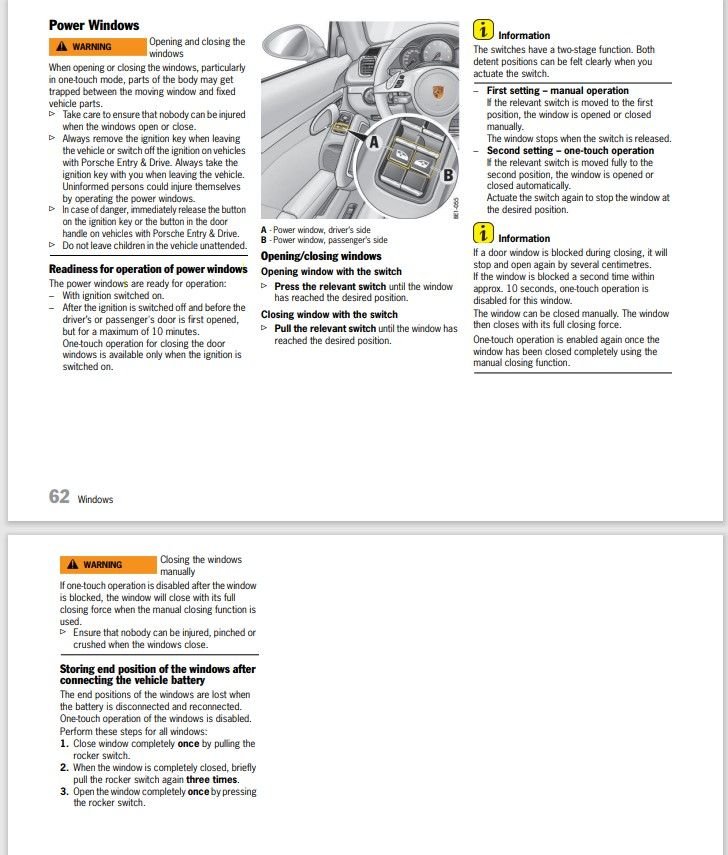

Have you verified the new switch has the 2-position on down? The switch has 3 actual positions; one is open, two is close, the third is the "one-touch operation".
You may just need to reprogram the position of the window.. Here's the relevant page(s) from the owner's manual that tells you how to do this..

Yep, it's a cheap, Chinese, knock-off alright. Neither window switch is two-position. Hence, the automatic function doesn't work.
Heads up. guys! If your switch breaks, beware, the cheap one doesn't have all its functionality! And thanks to saabin.

I think dav9515 lucked out and got a switch with full functionality. For sure, this one is just single position. In short, I won't be buying any more $50 switches. :-)

Welp, I've got to 'fess up. I recently pulled up on the window switch that I had accused of being just one position and ... it is two position after all. All this time I just wasn't being assertive enough when pulling up or pushing down. I guess I was afraid of breaking this one too. Oh well...
