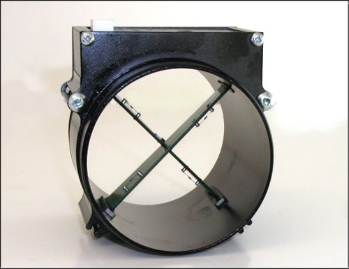

Hey what about a Lindsey aftermarket 951 upgrade MAF? Designed to replace the AFM on a 951. $454.95. Apparently it has adjustable output voltage, so it might need to be adjusted to match the stock MAF? Not sure whether it would work properly...
