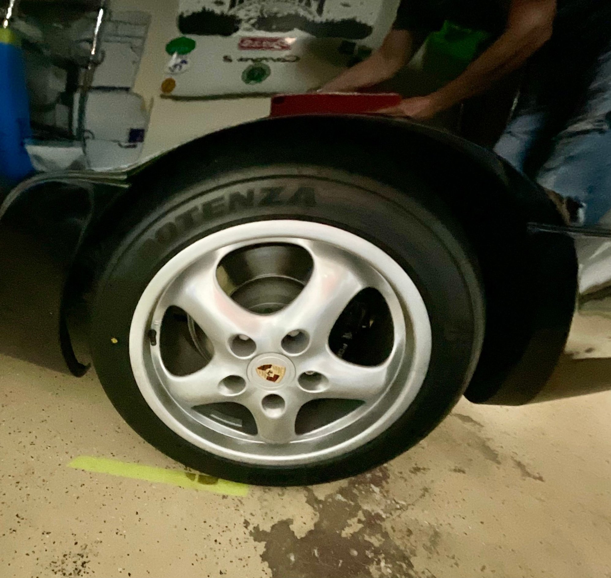

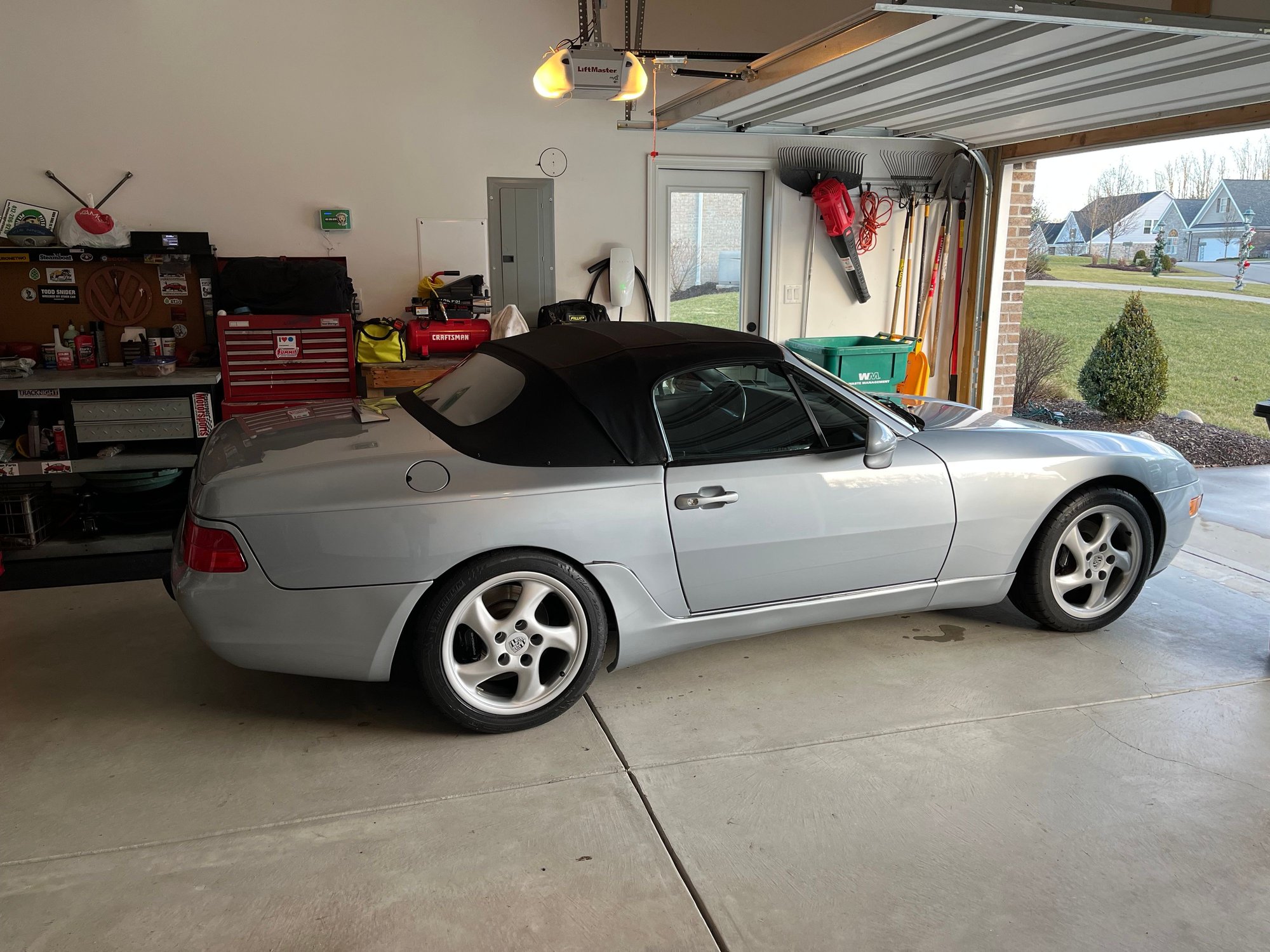

I am purchasing a 1994 Cab and the window sticker states 17” Light Alloy Wheels, cost $1378. Pictured is what is on the car. Correct?

No. The window decal is referring to the wheel known as Cup II. Those on the car are a newer wheel and what I call Boxster Turbo Twist. There may be a more correct name. And are those in the picture 18"?

Thanks Cliff! The wheels pictured are 17”.

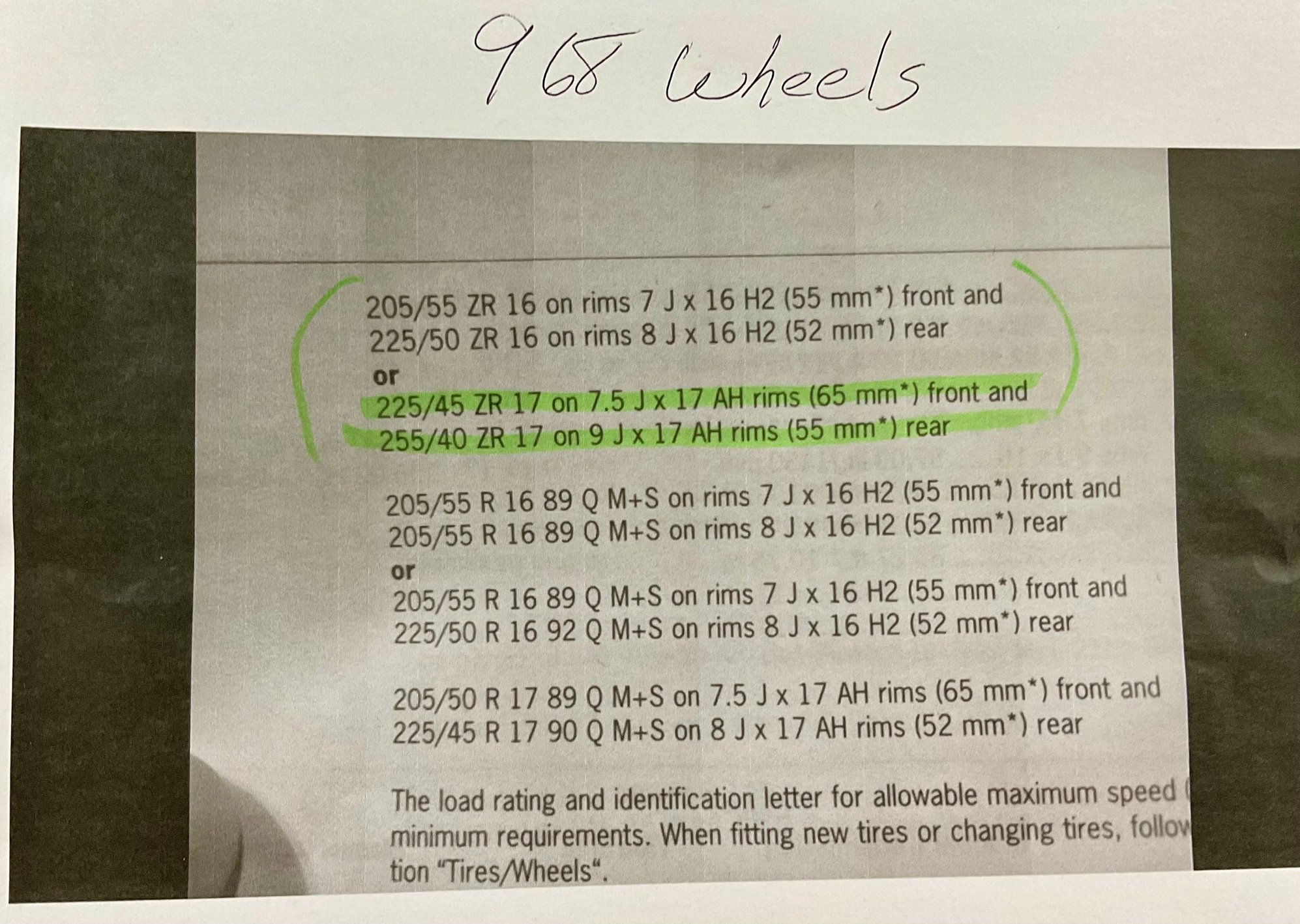

As mentioned, the wheels you have are likely from a Porsche Boxster. Unknown what their width and offset is, but you can see the proper width and offset for the proper cup 2 wheels in the image of the wheel size below. A lot of of 96 817 inch wheels disappeared because they were in demand. Note that the front wheels are different width (7.5" vs. 7" and 65 mm offset versus 55 mm offset for the 7 inch wide wheel) than the much easier to find front wheels on a 911 of similar vintage.
There are serial numbers embossed on one of the spokes on the backside of the wheel, also the width and offset are embossed next to the valve stem hole (one number on each side of the hole). The numbers don't show up well in my photographs since it's a bit dark in the garage.

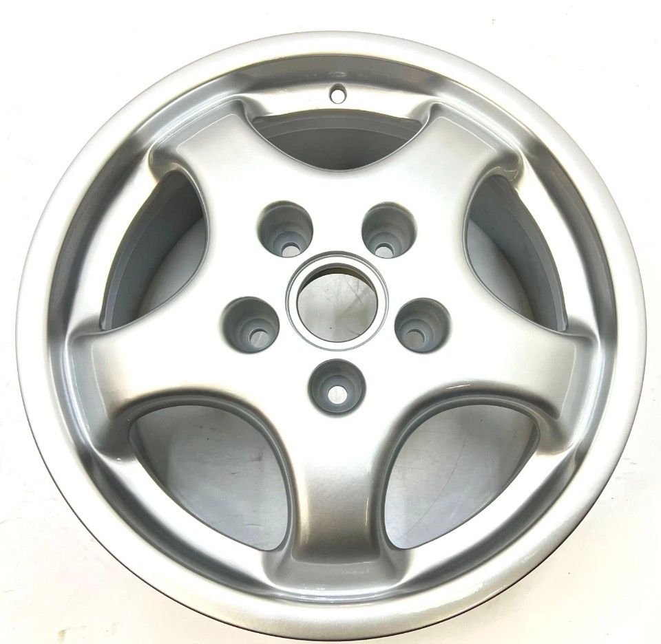

I've been watching BaT for 17" wheels to replace the 16" Cup wheels on my '92 Cabrio and decided to create a "late offset era" quick reference for myself based on what I've seen across various owner forum posts and the 968 V-Pages. Sharing here in case someone finds this info useful:If anyone one has a correction or question, I've added a number to the upper right of each wheel image as a shorthand reference
