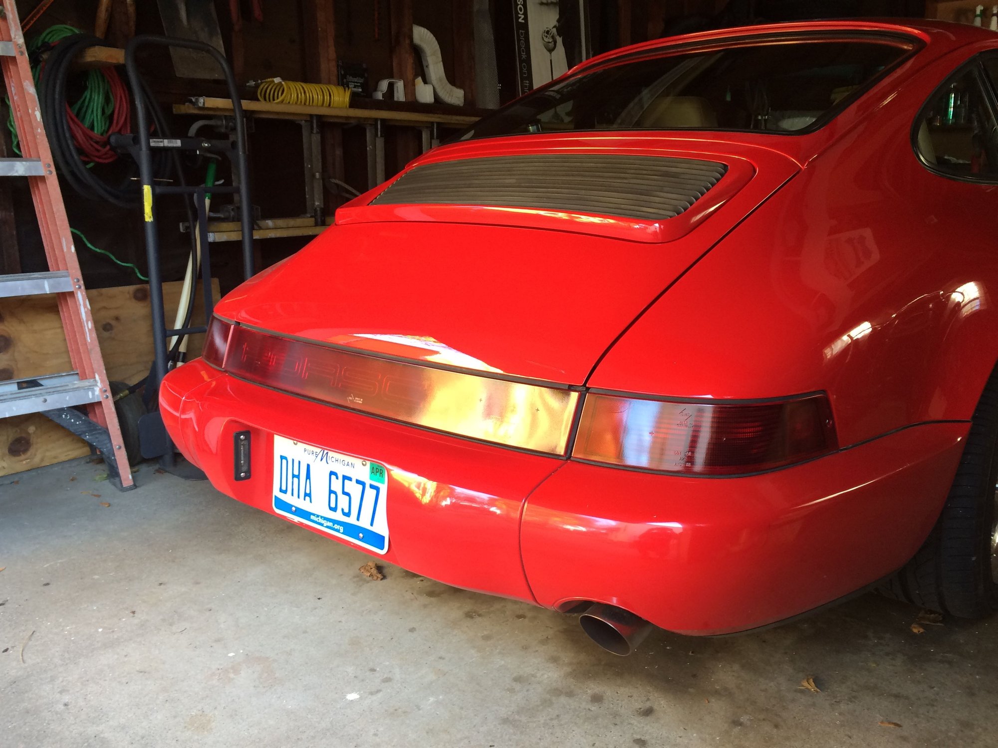

Gotta say I'm happy with this product. Also used a UV protecting clear coat.
Before:
After:

Can you show the blinker? Does it show up red or orange still?
Same for the back up lights?
Thanks!

I was worried about the too, but it's still Amber.

Did my tail lights the same way. Give it a wet sand with 2000 grit and a quick polish and they'll look even better!

I am pretty happy with the results of the product, too. I used a two part clear on top of the VHT, and I'm pretty darn happy with the results. Wet sanding with 2000 grit will definitely help get a more polished/finished look on the lens. It can also help even out spots if you get heavy handed with the VHT. Just make sure you mask off/removal the rubber seals, if applicable based on year, and take your time applying the VHT, and in particular the clear coat if you're using a two part.
