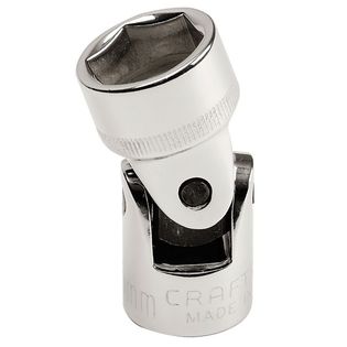

I've been lucky on both of my engine's exhausts. Use penetrating oil and give it time to soak in. The other advice is use good quality tools, you don't want to round or strip a nut. I have a 8mm 6" long Snap-on tool for removing the heat exchanger nuts and a Craftsman 13mm swivel socket. On other cars, I've used a MAPP torch to loosen rusty nuts/bolts.
