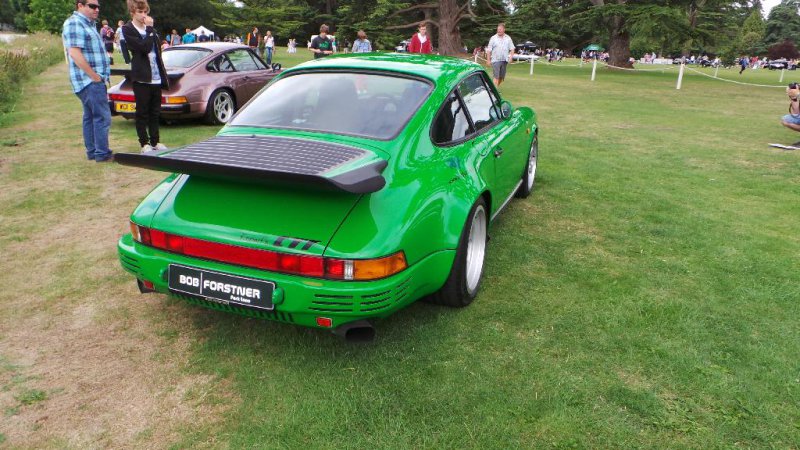

Old May 18, 2014 | 12:51 PM
Lemass Automotive's Avatar
Lemass Automotive
Joined: Nov 2011
Posts: 1,466
From: Stoke Poges, UK

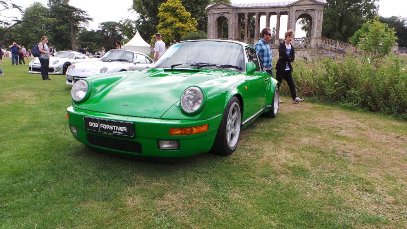

I thought i took some closer pics
