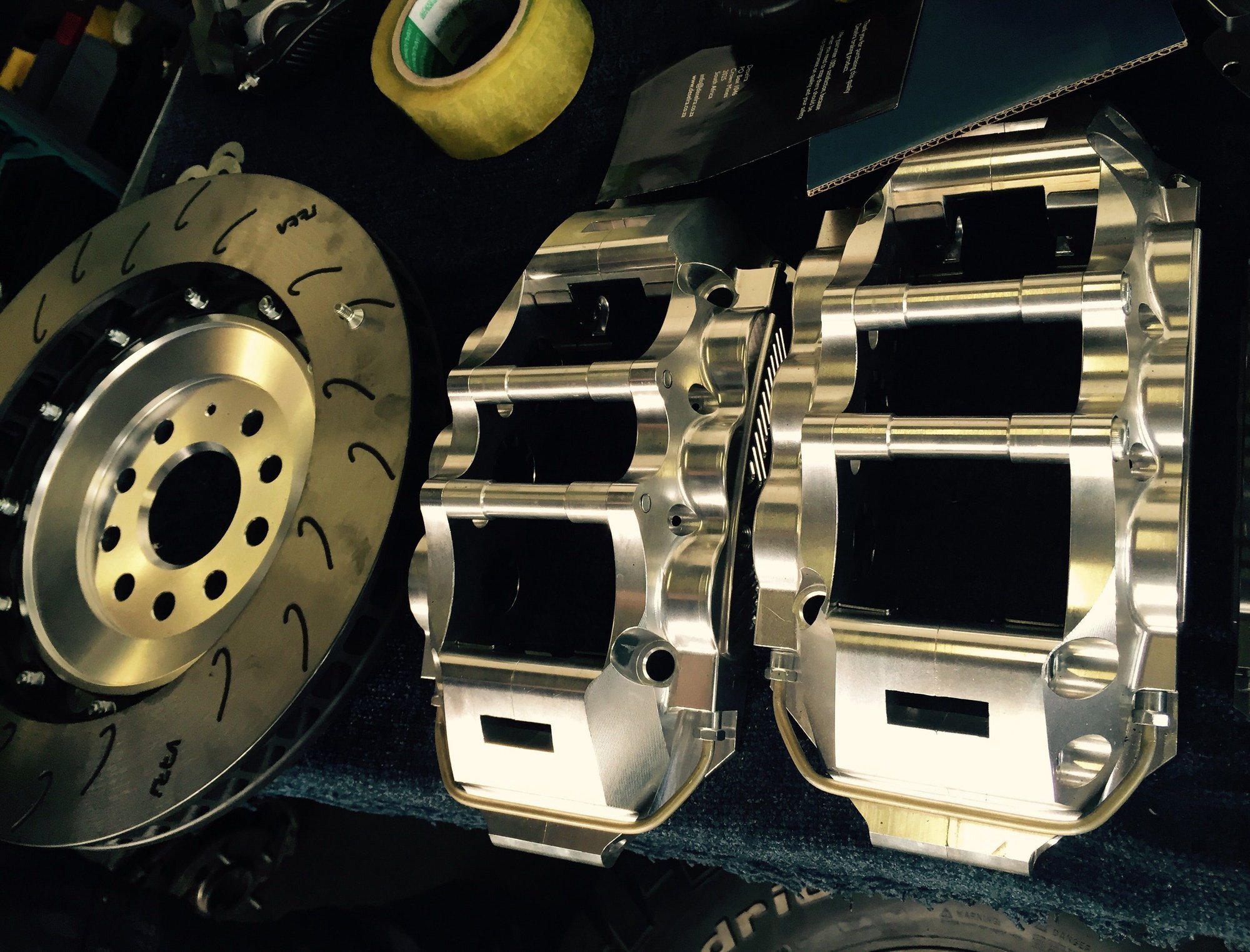

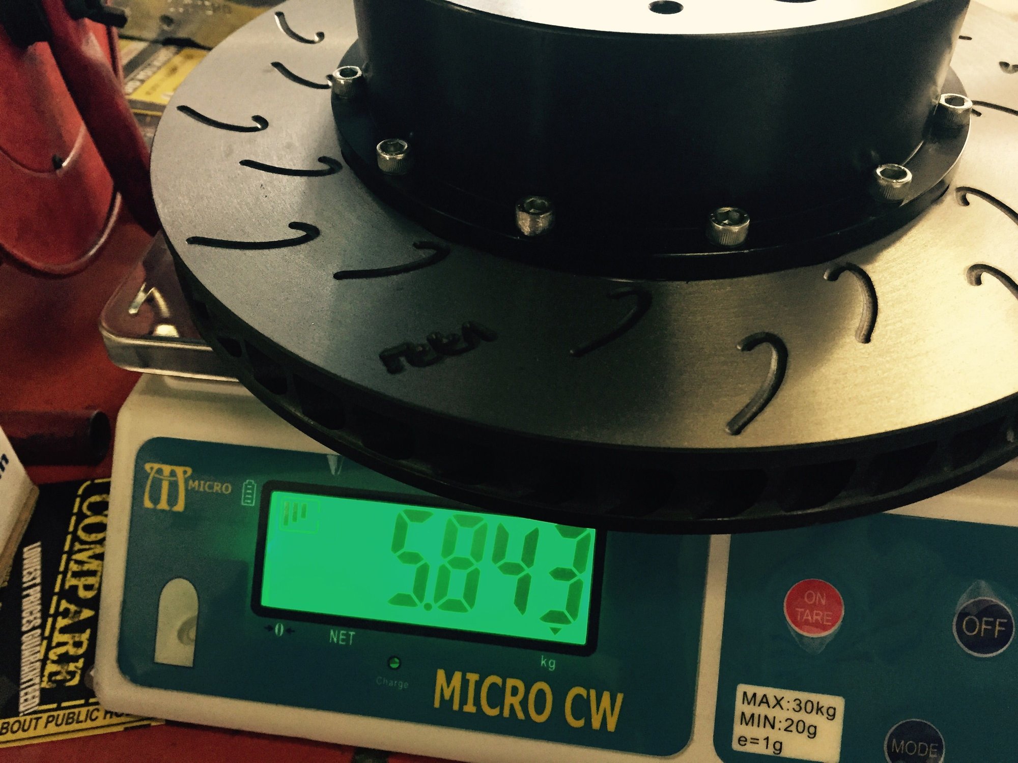

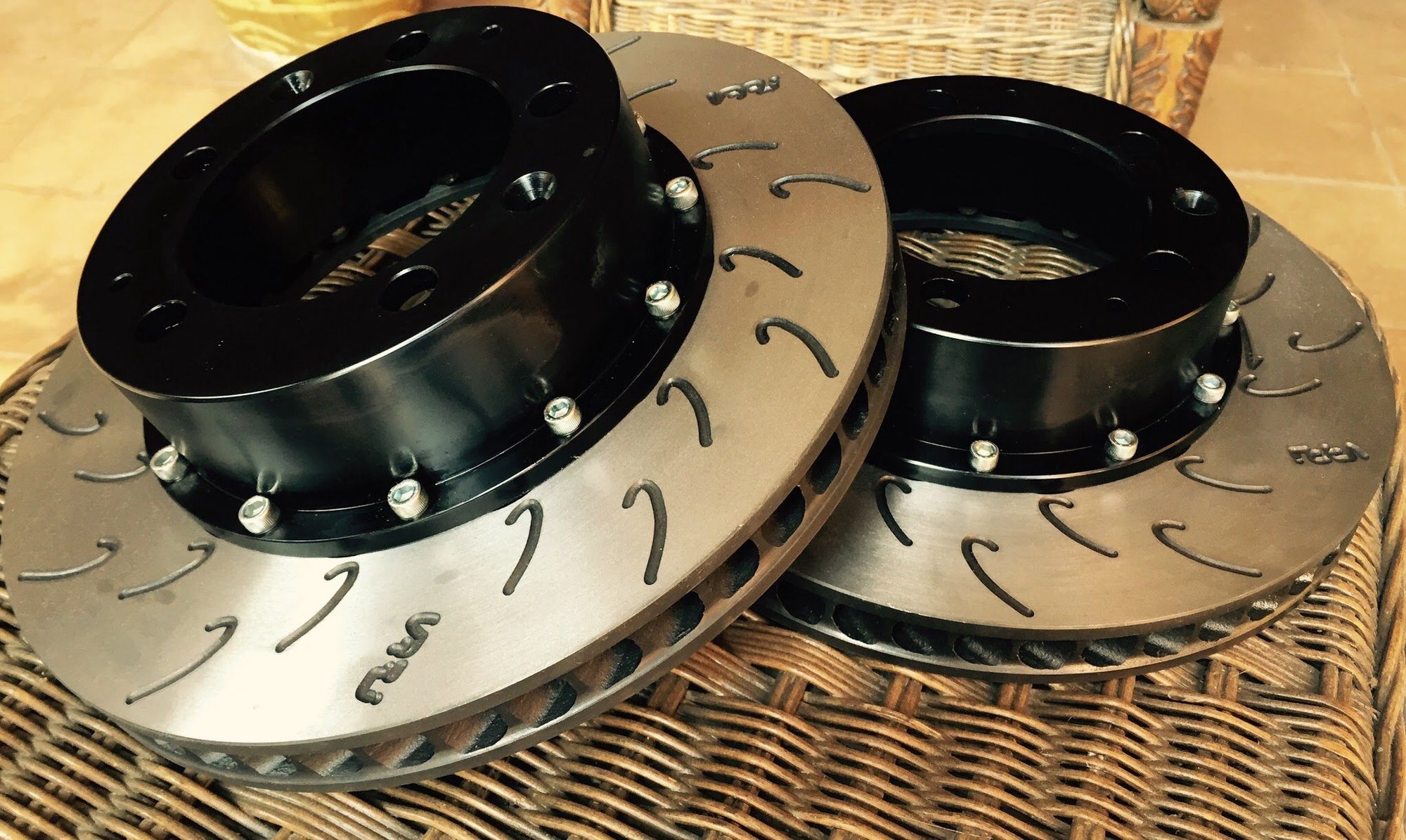

Picked these up from. Guy who makes the calipers and rotors for a few of the one make / specified series here and in Oz
..made to my specs based on the Zimmerman drilled RS spec rotors I had on the car .... But that is to the Ali hats and thinner vanes the results are a couple kg lighter per corner ... Ahab do you subscribe to the 4x idea for the impact of unsparing weight vs sprung?
Pretty bits require pics! Billet especially!

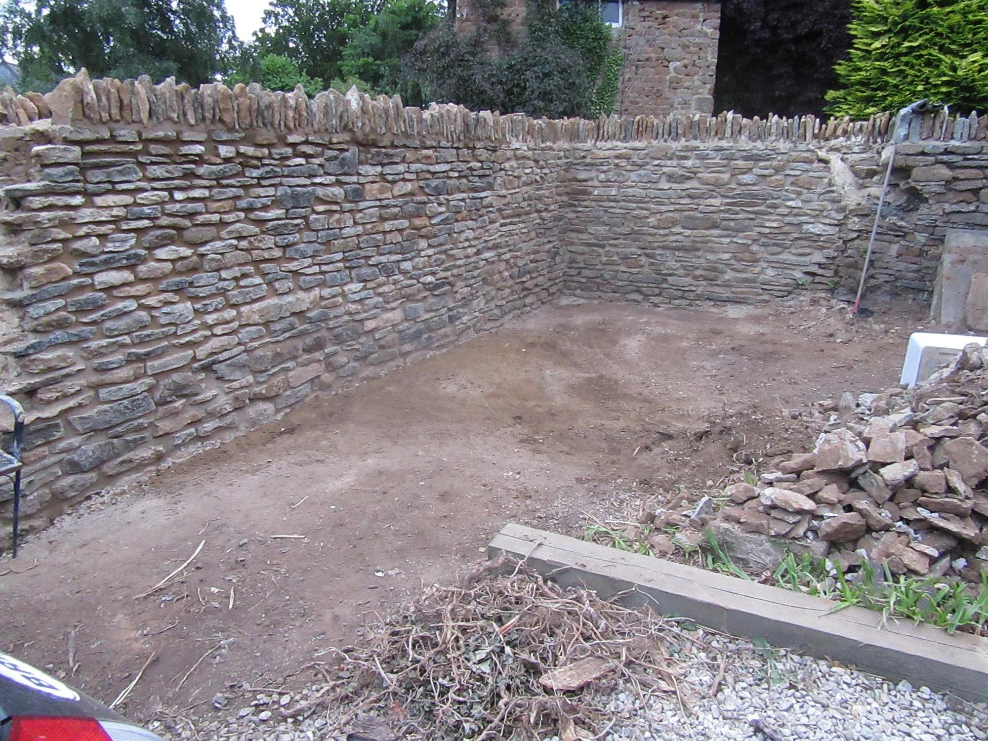

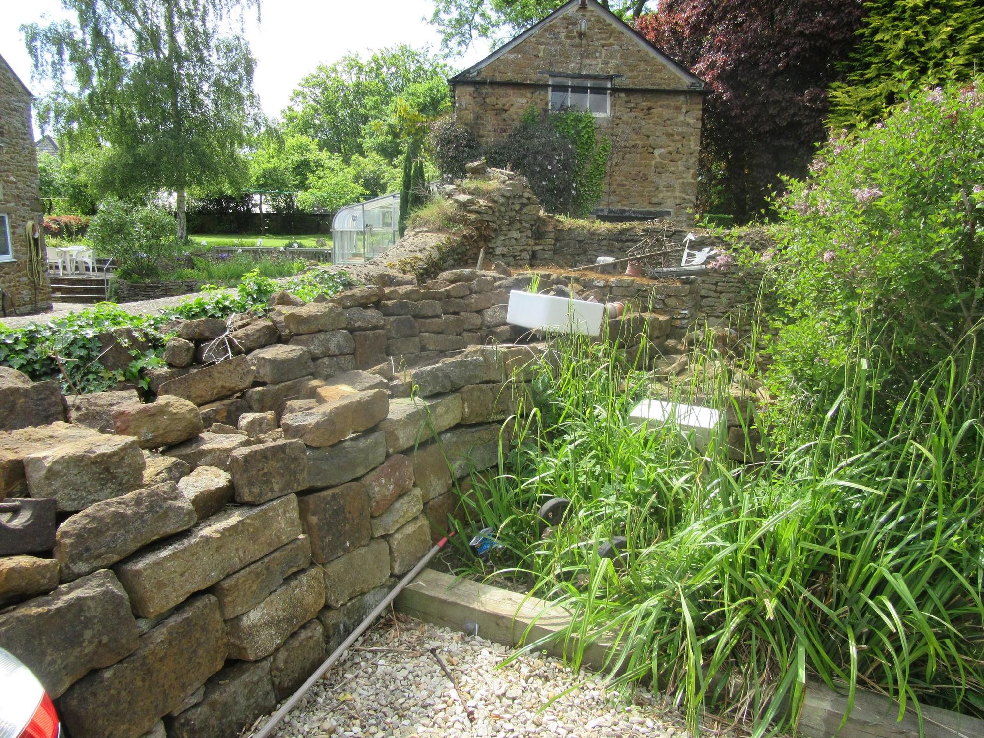

Here is my summer project, zombie proofing my garden, will finish it up end of Sept. and over the winter plan to get stuck into my car. Oh and there is also the small matter of finding a new job.

Originally Posted by HiWind
Agreed this is an epic and it's only just begun
wow HiWind, beautiful, brake eye candy, they look fantastic and 6 pot's too, a much more inspired choice than the big red route
I've discussed the unsprung vs sprung question with car handling experts (not mechanics but cone heads, real clever computer simulation whizz kids) and read everything I can find on the internet.
Lots of numbers out there but I think it is impossible to pick one as it really depends where the weight is removed on the unsprung parts of the car. 1kg from the tyre will have a much larger affect that 1kg from the wheel carrier due to rotational inertia.
Unsprung is one area of my car I will really concentrate on for removing weight, I spec'd my brake calipers so I can upgrade to PCCB disc's one day when they are affordable, until then I will have cast iron disc's with aluminium tophats, same as yours. I have gone small on my brake set up as I'm hopinbg to ducting enough cooling air to keep everything happy.

Nice garden Capt. Are you close to Stowe?
I hope your projects inc the job hunt go well - patience is usually rewarded
Re the cooling - I especially like the j curve slotting on those discs and the directional vanes ... He also says the flex in the billet calipers (which I haven't bought as I refinished mine) is much less than the cast ones hence their value add.
But the discs are 40% cheaper than OEM and I run them on my 05 cup where they are still strong after 2 seasons so I'm convinced they'll do the job. Running blue stuff EBC pads from your fair shores for the first time ... will update my dev journal once tested.

HiWind, good spot on the local stone colour, I am about 20mins north of Stow

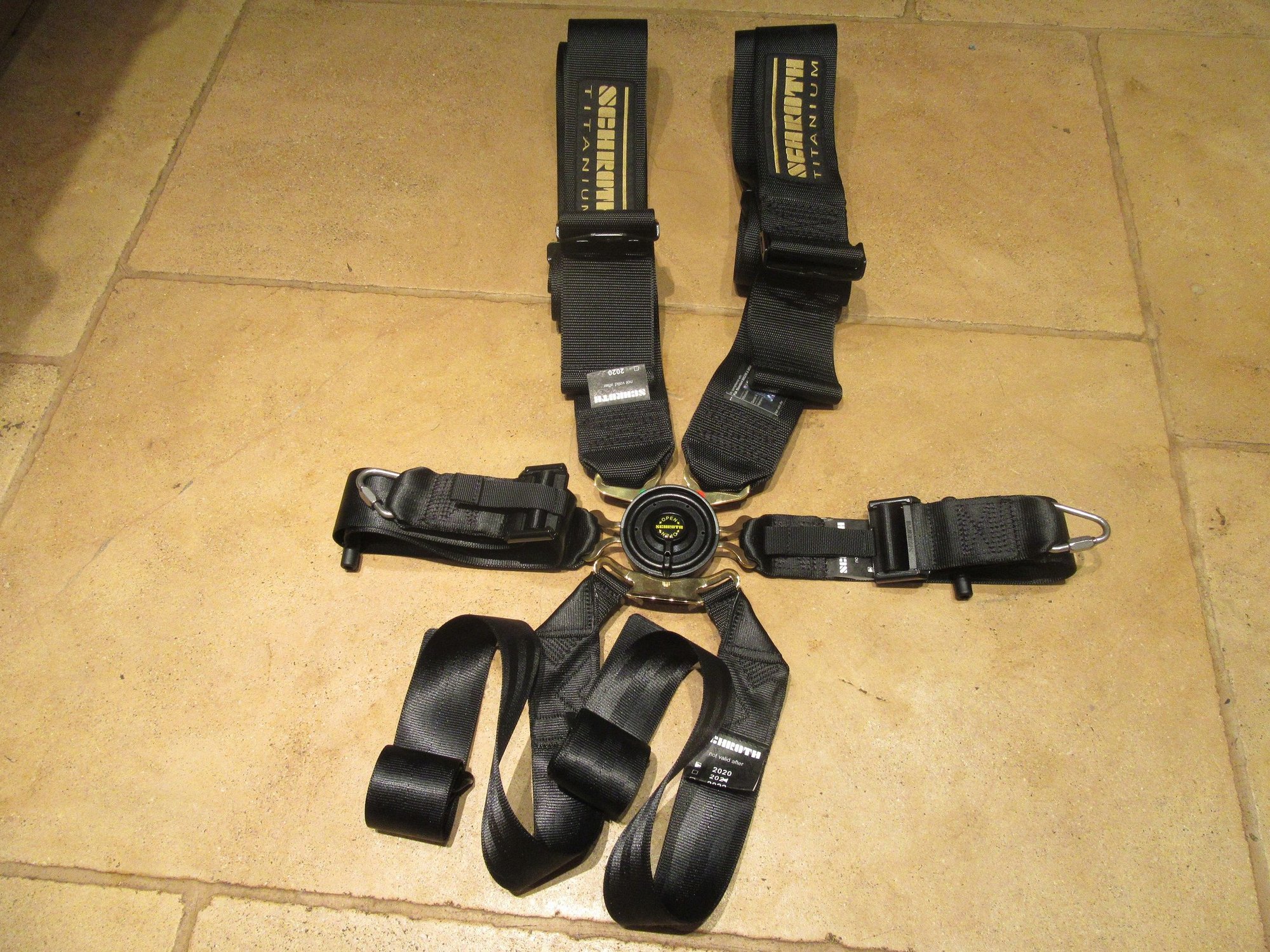

been away and found 2 sets of these waiting for me.....
Titanium Profi II-6 are the lightest weight off the shelf seat belts I could find, 1.558kg a set, metal latch plates are titanium and titanium nitride coated for a bit of extra gold sparkle
took a lot of umming and ahhing to convince myself the 1.5kg weight saving over normal 6 point belts was worth the extra but now having them in my hand and seeing the quality and finish I'm so glad I over spent
just for comparison a set of F1 seat belts weigh in around 0.5kg

Finished my summer project which mean I can finally have some Porsche time to myself, I think 2ft thick should keep out even the most determined tank driving zombie. Well pleased with the end result considering it is our first time building a wall.
My handy work
Mrs Ahab's handy work, it the neater face and our side too, what a doll she is

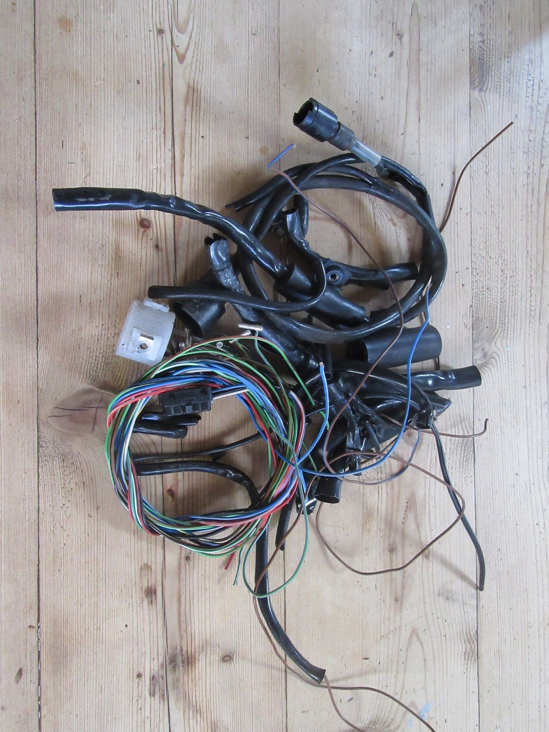

Strip back redundant wiring/connectors and rewrapped loom, a nice cheap job

Today after a long absence I launched into the wiring loom starting simple with the passenger door loom. I only chased the wires back to the plug in terminal under the dash near the A-Pillar, will remove beyond this another day. I just kept the electric window wiring and this is the pile I didn't want to keep
0.360g passenger door mirror and central locking wiring loom

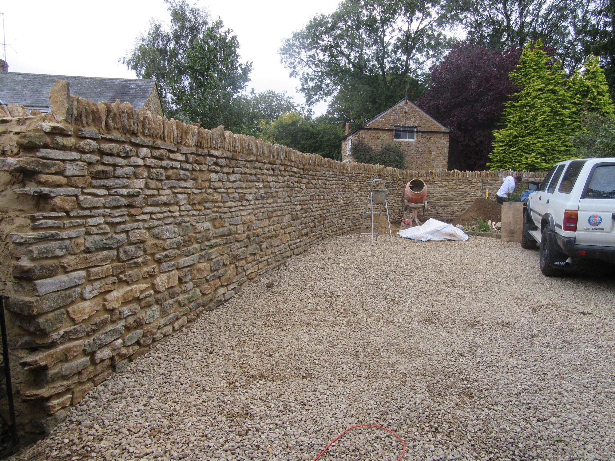

Forgot to mention my wall building lightened me by 6kgs, all useful weight high up
