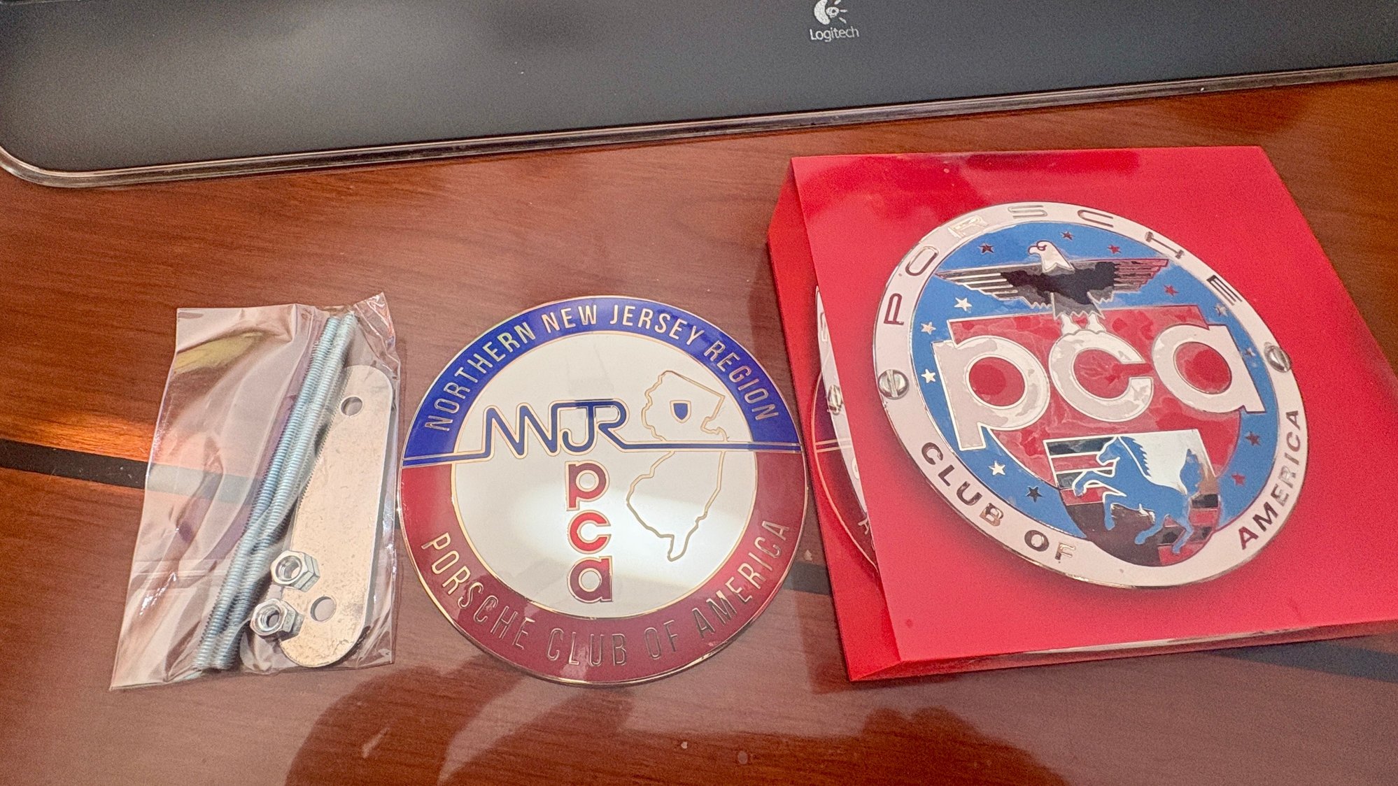

Glad to see someone still mounting these on their cars. I have our local NNJR badges made by the same people that make the PCA ones. I believe like ours they now mount from behind with studs vs the holes. Also that appears to be an early vintage PCA grill badge. I have one from 84 encased in lucite on my desk and it has a line through the horses main. Do you know what year that one is from?

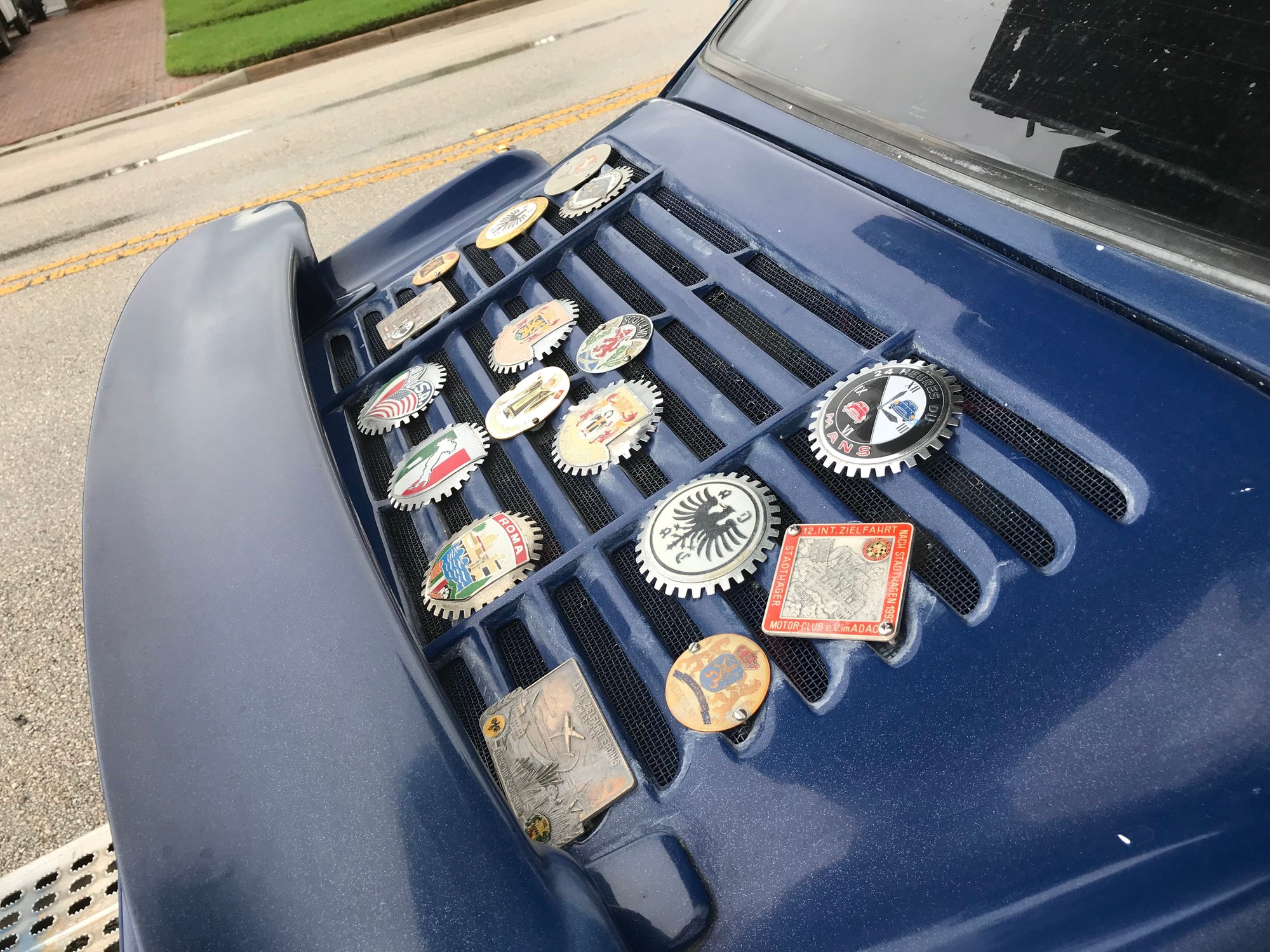

Old Mar 4, 2026 | 09:13 AM
jeff33702's Avatar

Just sayin!

Originally Posted by jeff33702
Just sayin!
Impressive! Is the mesh under your hood stock or did you install that to make the badges easier to install?
I'm not responsible for what's going on here except that I bought it this way I've finally removed the while lid and test fitting two other ones I have, which will be badgeless in the end.
