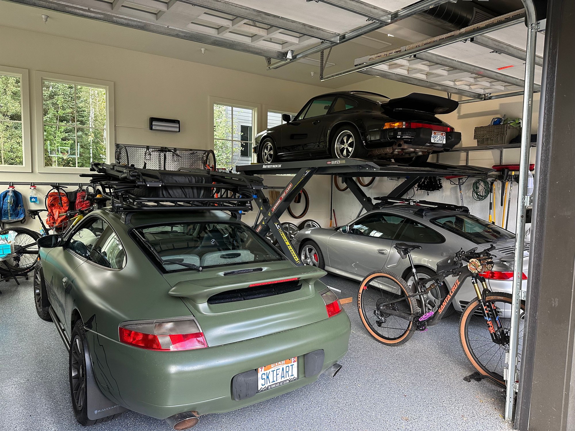

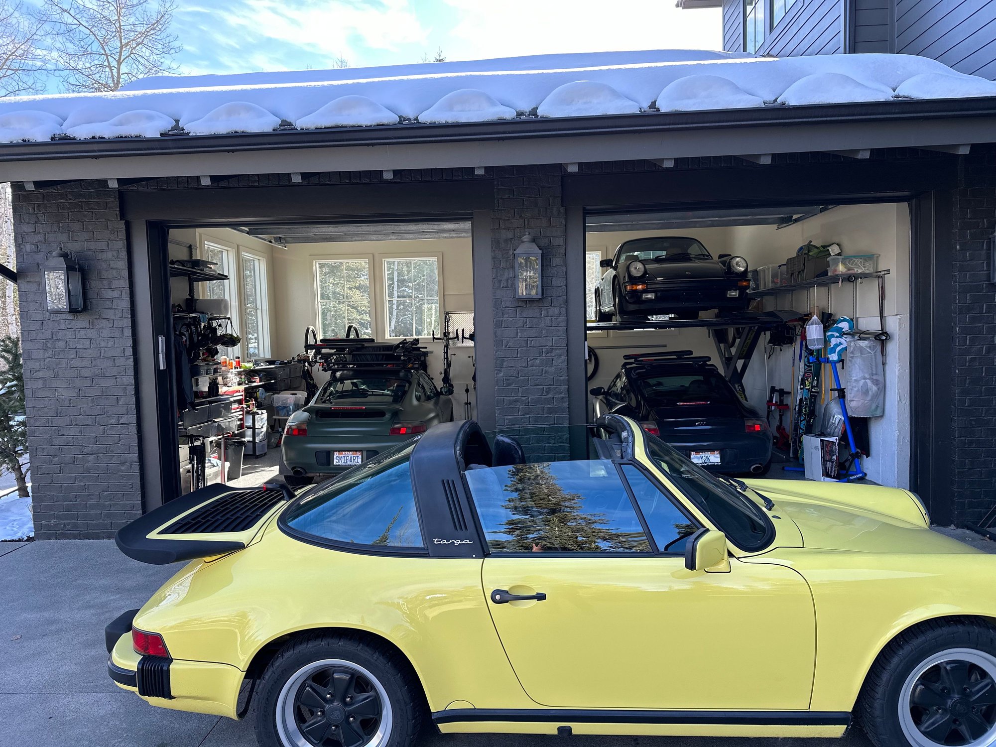

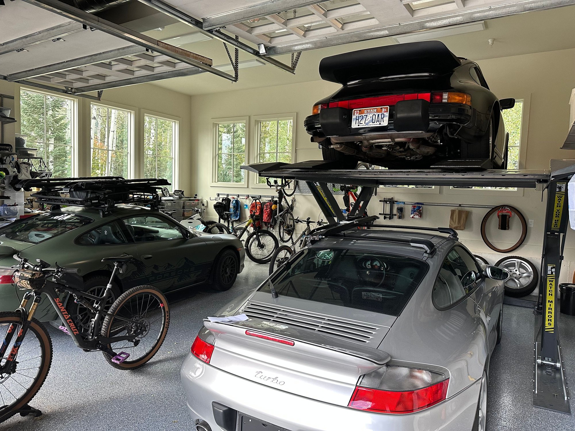

Love my Bendpak - photos - I don’t work on my cars but for storage, etc. - simple and efficient - note that my garage as center drain so they need to put some blocks in (bolted down) to level the lift.
