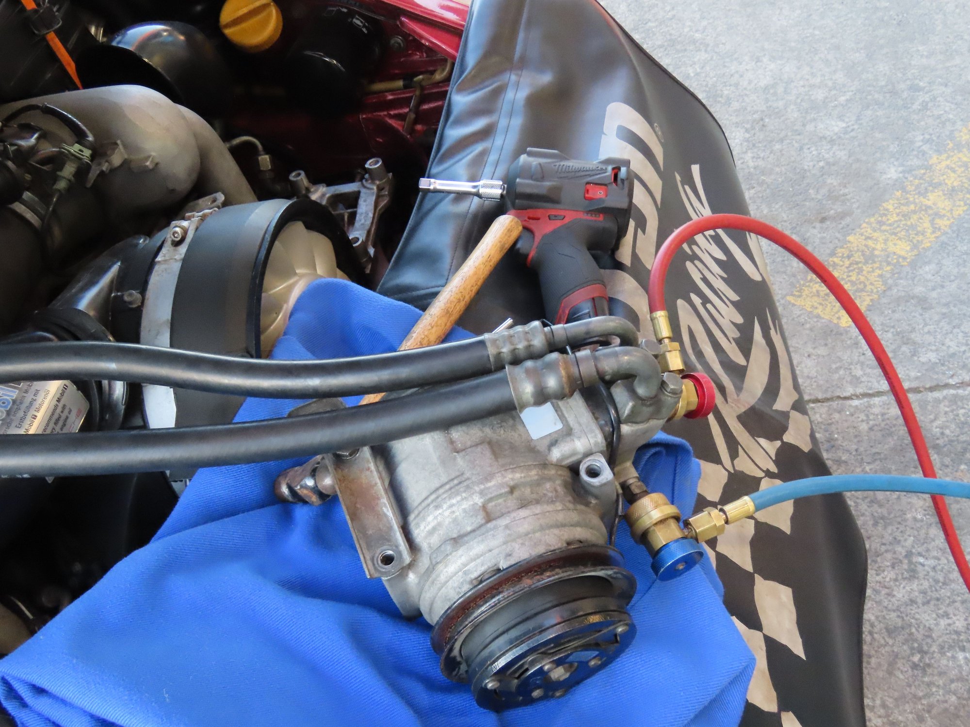

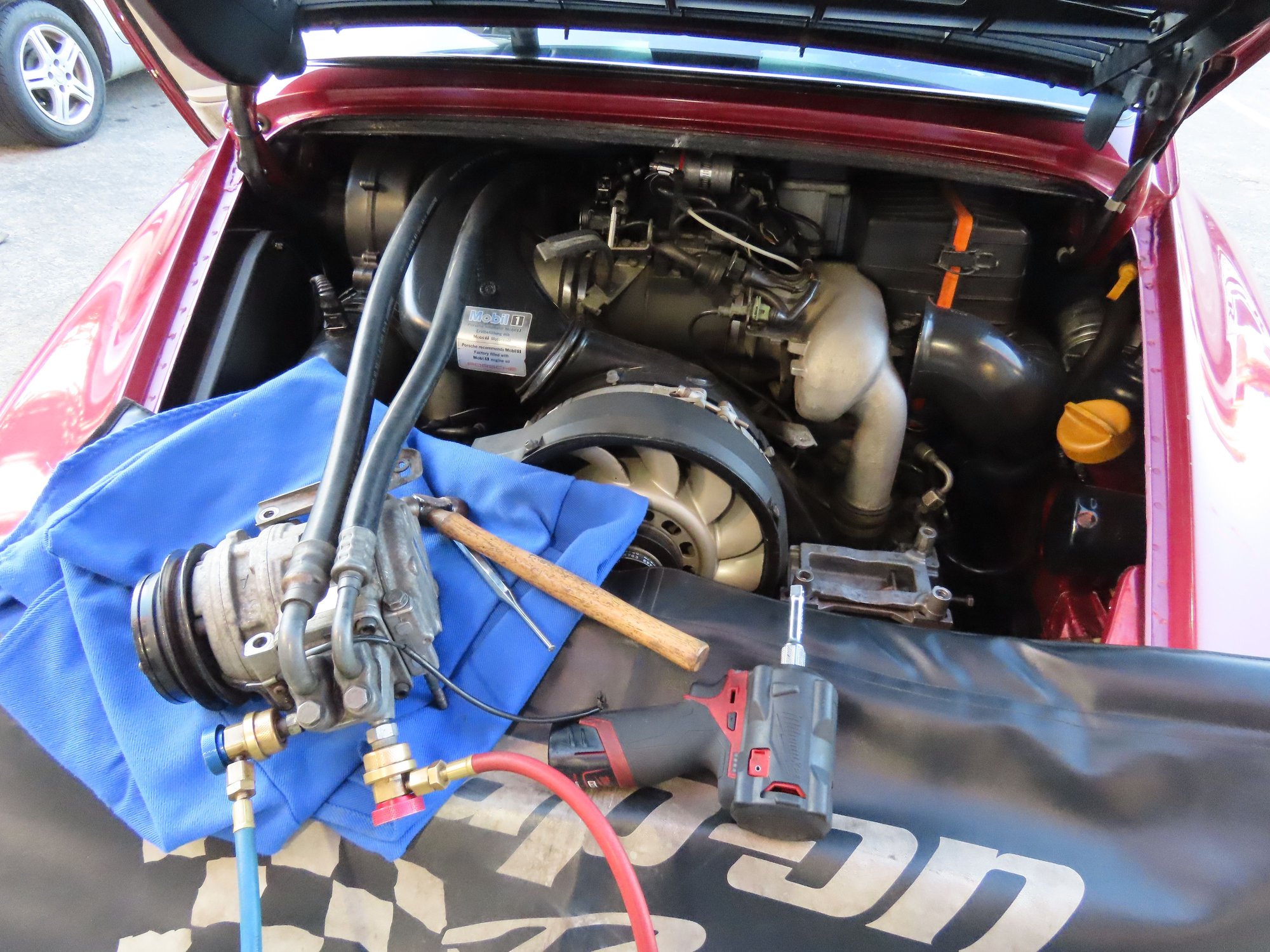

Obviously the first step is to make sure your system is evacuated to get rid of any remaining R134. A local garage did this (wasn't anything much left in there anyway - ok, nothing.) and I took the opportunity to remove the compressor as the red hose fitting wouldn't quite fit (not enough room between the connection and the oil filter).

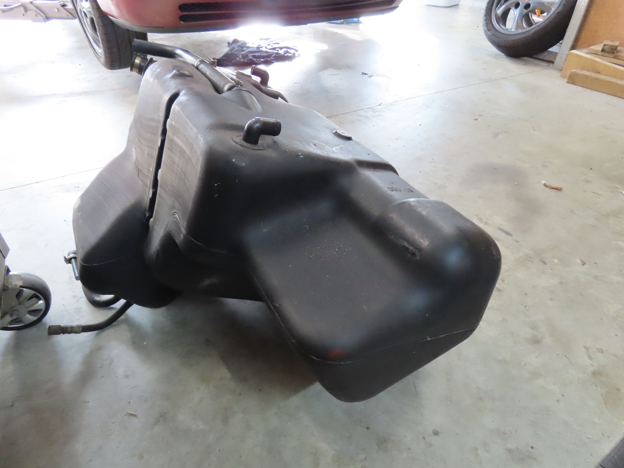

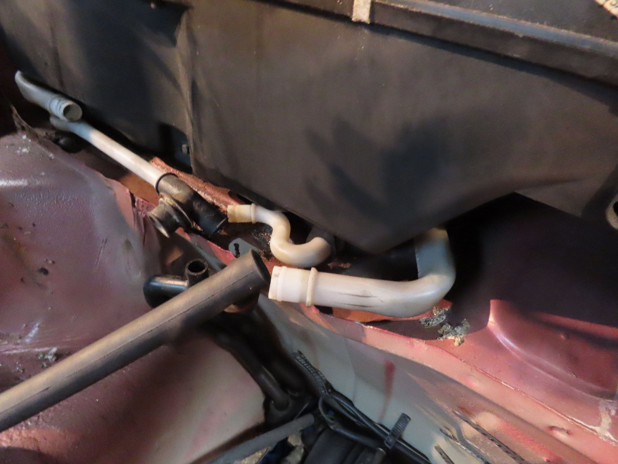

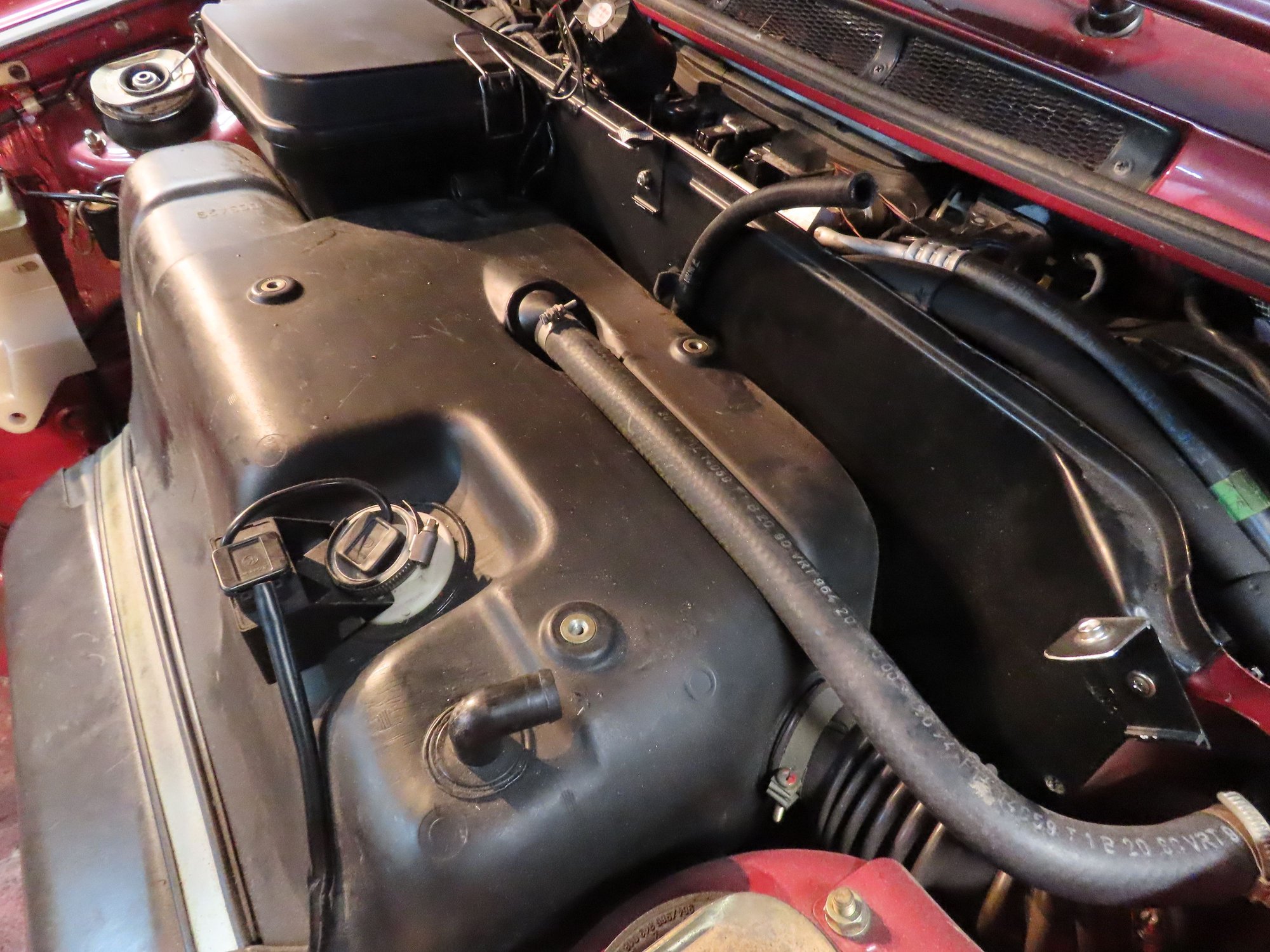

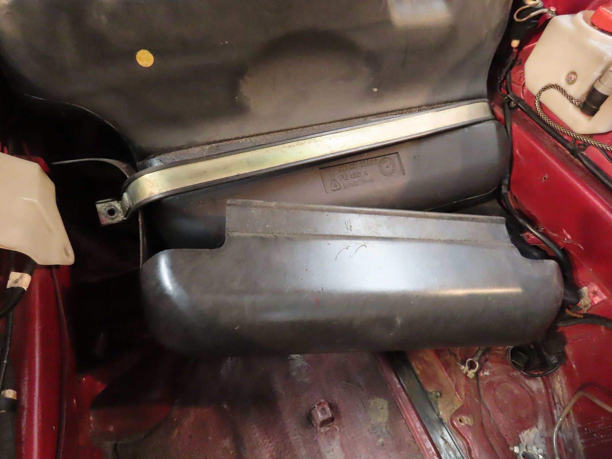

I also removed the small tank on top of the main tank. Not necessary but I intend to replace some of the hoses and want to know where they all go. This is held down with 3 x 10mm bolts. Beware of the black spacers between the two tanks.
Unplug the fuel level sender and unscrew the 50mm hex top. Trying to siphon the last of the petrol out via this hole proved fruitless (not keen on getting high....really, I'm not).

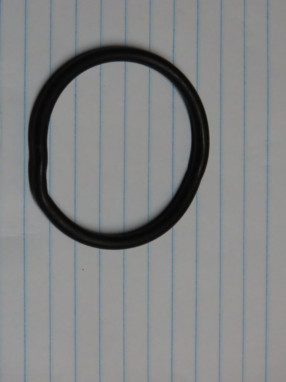

Also discovered the source of the faint petrol smell I would get occasionally when opening the frunk.......the O ring for the fuel level sender was kinked and clearly not sealing well.
Best option is to drain the tank via the petrol pump.
Undo the hose clip on the left side (red circle.....I know sh** photo), pull the hose out while crimping it and make sure you have a suitable container to catch the excess fuel (I had about 8 liters left). Oh yeah, wear eye protection and keep a couple of rags handy. There will be splashes. Undo the return hose (yellow circle) with a 17 mm & 19 mm wrench. There will be some fuel still in this line.

Undo and pull away the fuel filler and overflow pipes.
Remove the 13mm bolt from the tank strap, the plastic protective cover falls out, and then with a bit of wiggling the strap will come free from the other end. The tank should come free with a bit of jiggling although I had to go underneath again and feed the fuel hoses up past the fuel pump a bit. Easy to do as I have a hoist.

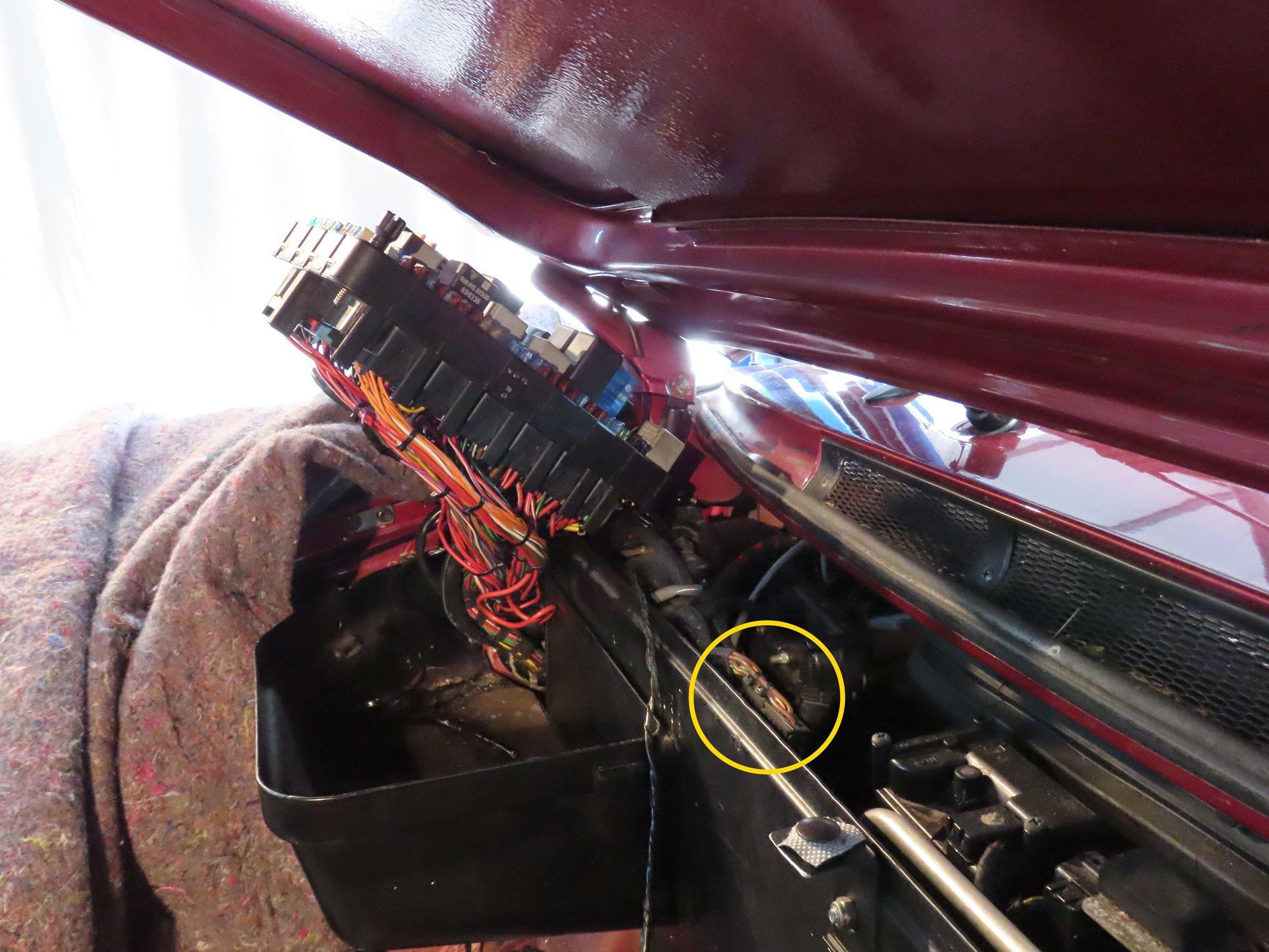

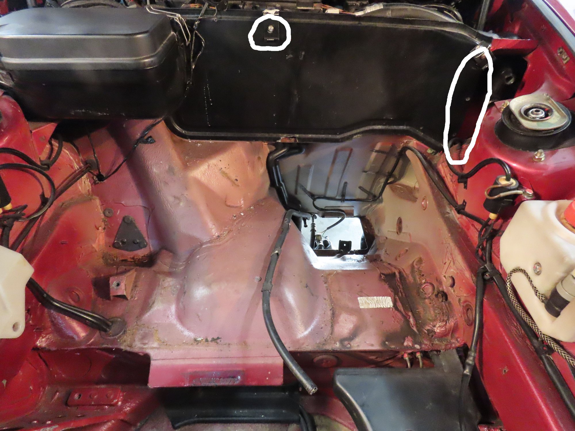

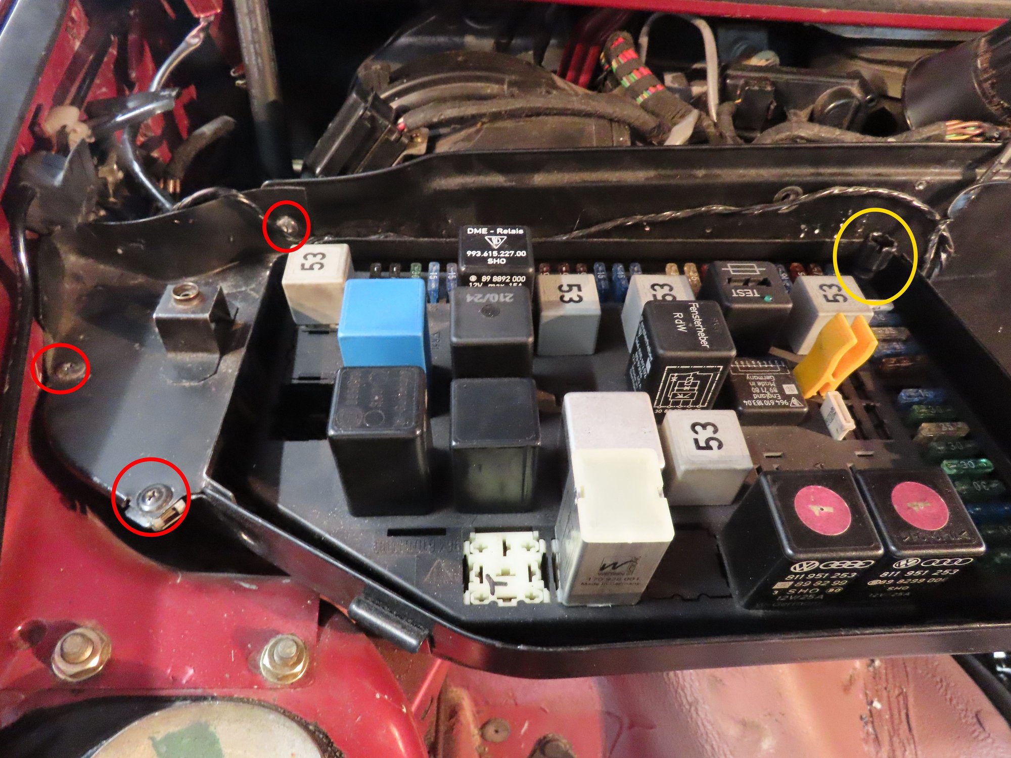

Next is the relay/fuse box and the firewall. Remove the 3 screws marked in red and remove that small panel. Underneath that are two 7 mm screws to be removed. Undo the screw fitting marked in yellow and then everything should be able to be pulled aside.
The firewall itself has a few screws down one side (white marking) and an electrical plug in the center (marked in yellow.). It should then come out easily.

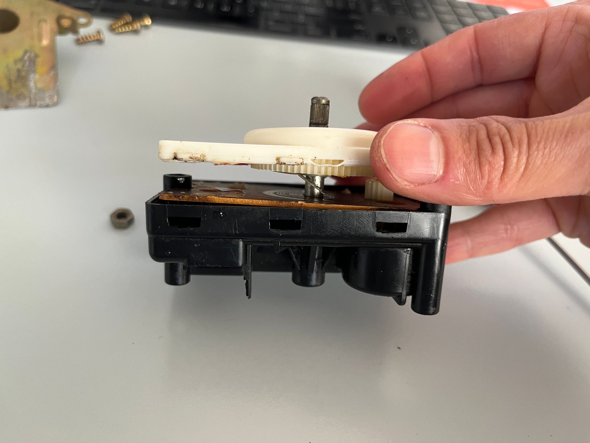

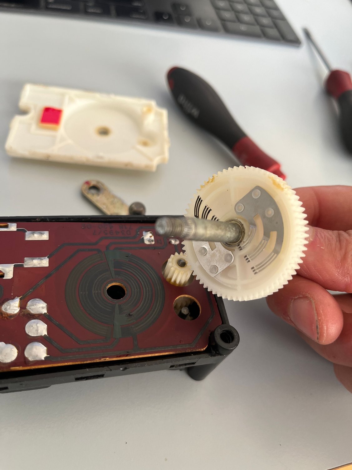

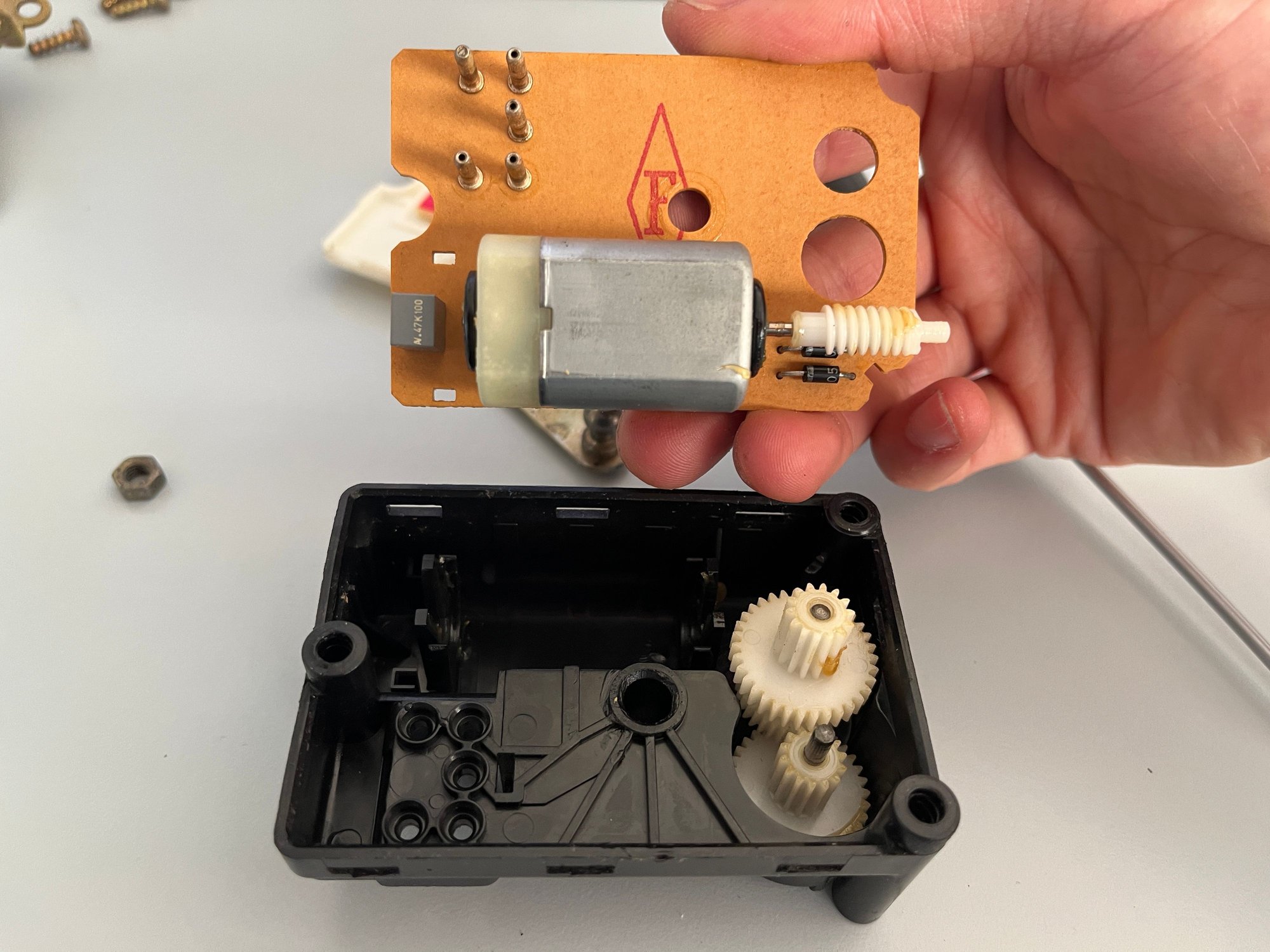

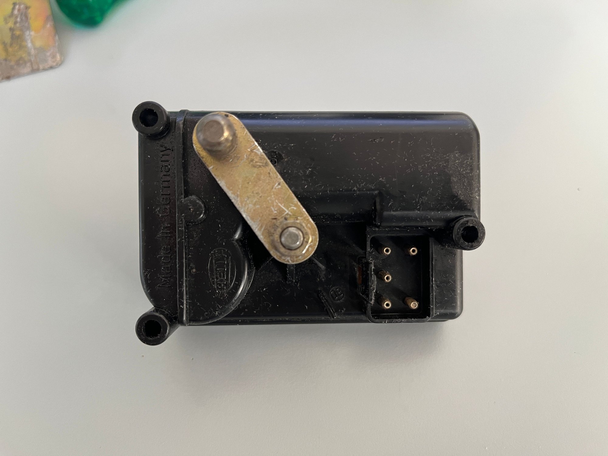

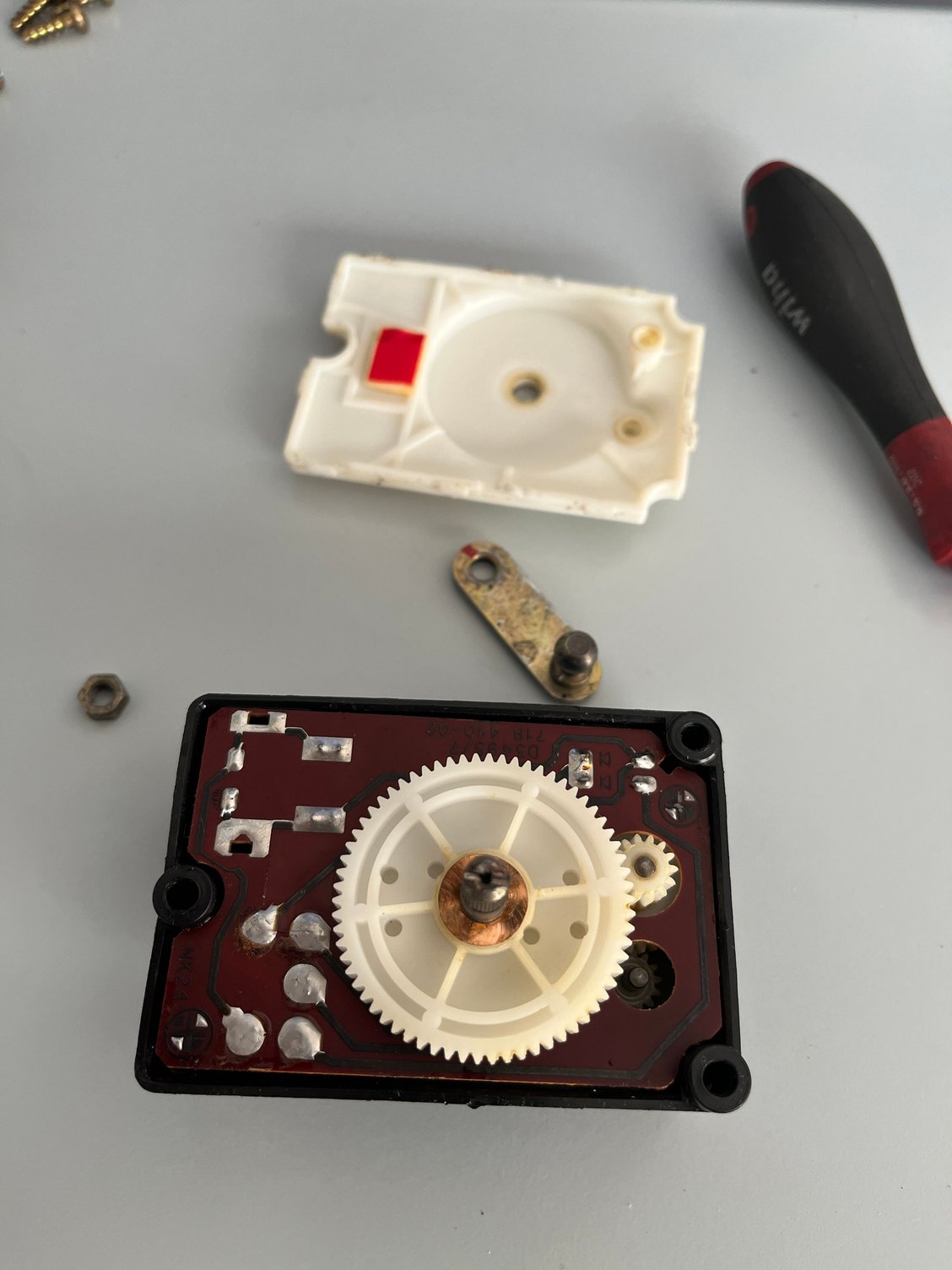

Off to a running start! I'm subscribed for pix of the suitcase guts, notably to see how you fix the seals around the mixing servo motor flaps to prevent unwanted heat. I'm also here to help where I can as I've done this in bits and pieces. Last nite I refreshed the servos themselves, which are of a remarkable familiar construction to anyone who has refreshed the AFM, but unlike later I don't believe a new "wiper track" is available as a spare. If I'm wrong please say!

Hold my beer......................yes there is a solution for the servos. New bits. Pics/instructions/info coming.

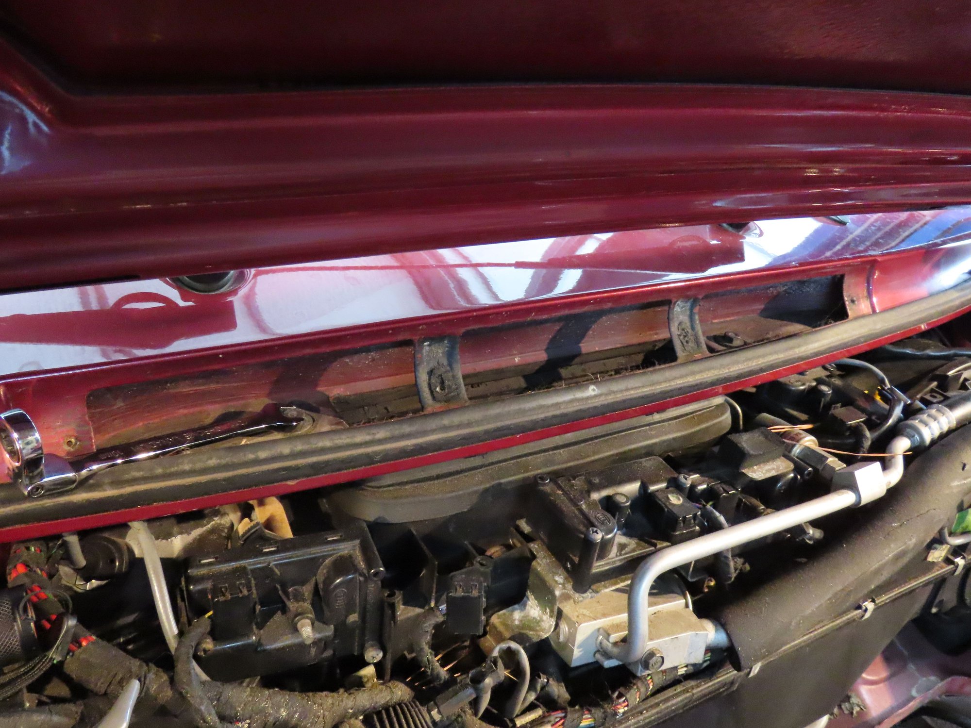

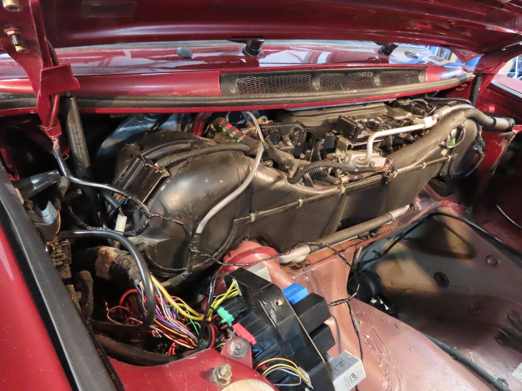

Semi-naked suitcase with firewall removed. Someone has definitely been here before. The wires to the blowers had been cut and repaired. The fuel hoses look to have been replaced as well, but will redo those and the fuel pump anyway as this must have been worked on about 20 years ago.

I'll be on the lookout for the suitcase pics. I'm trying to understand what makes the L/R heat blockoff flappies stop blocking off the heat. Here are a few pics I've collected from the innernet.

Great pics. Cool to see the scuttle drain pipe routing. I understand clogs there are common cause of water-in-car.

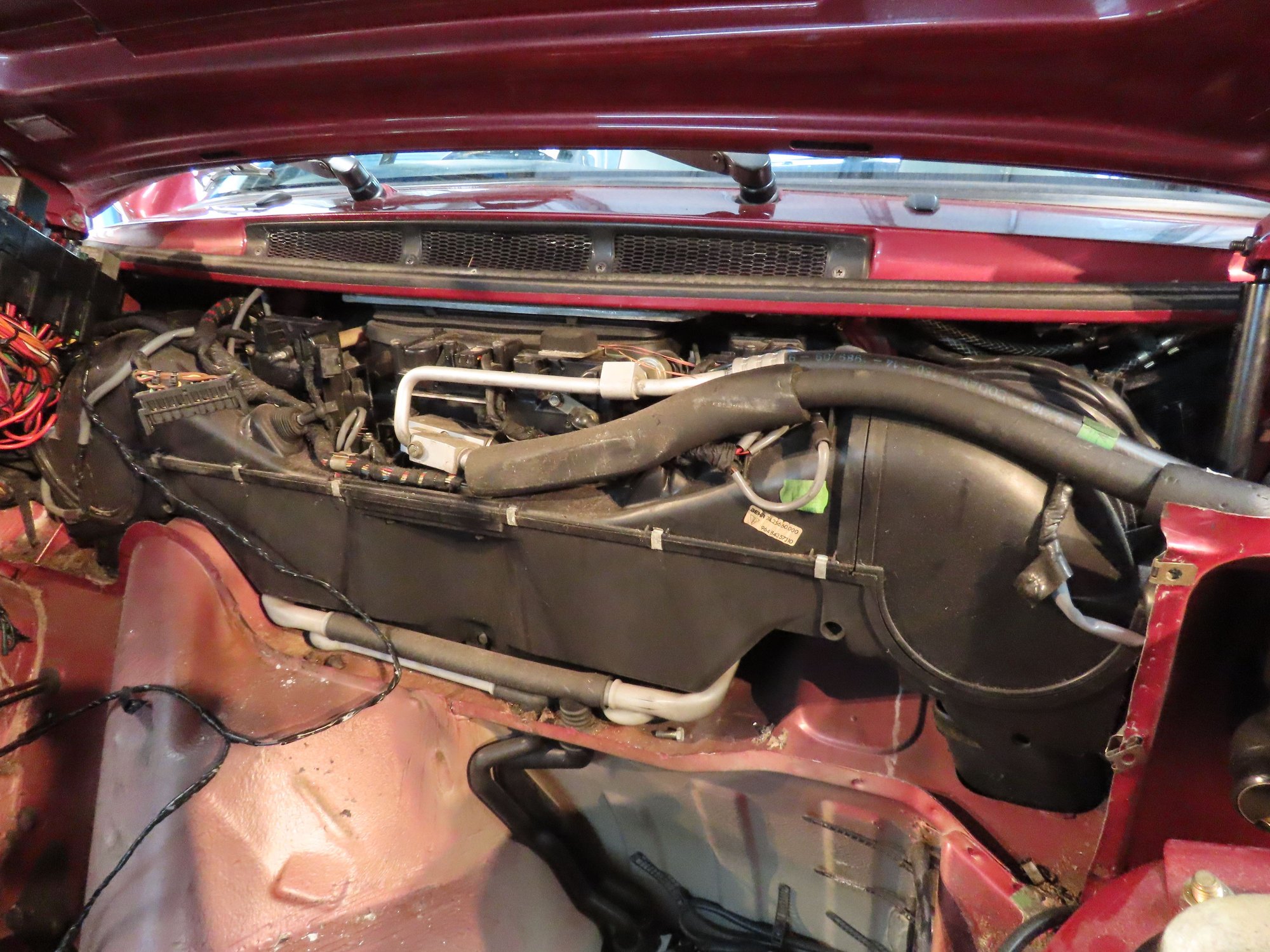

Remove the vent/grill above a/c unit as well as unscrewing the 2 screws behind the grill.

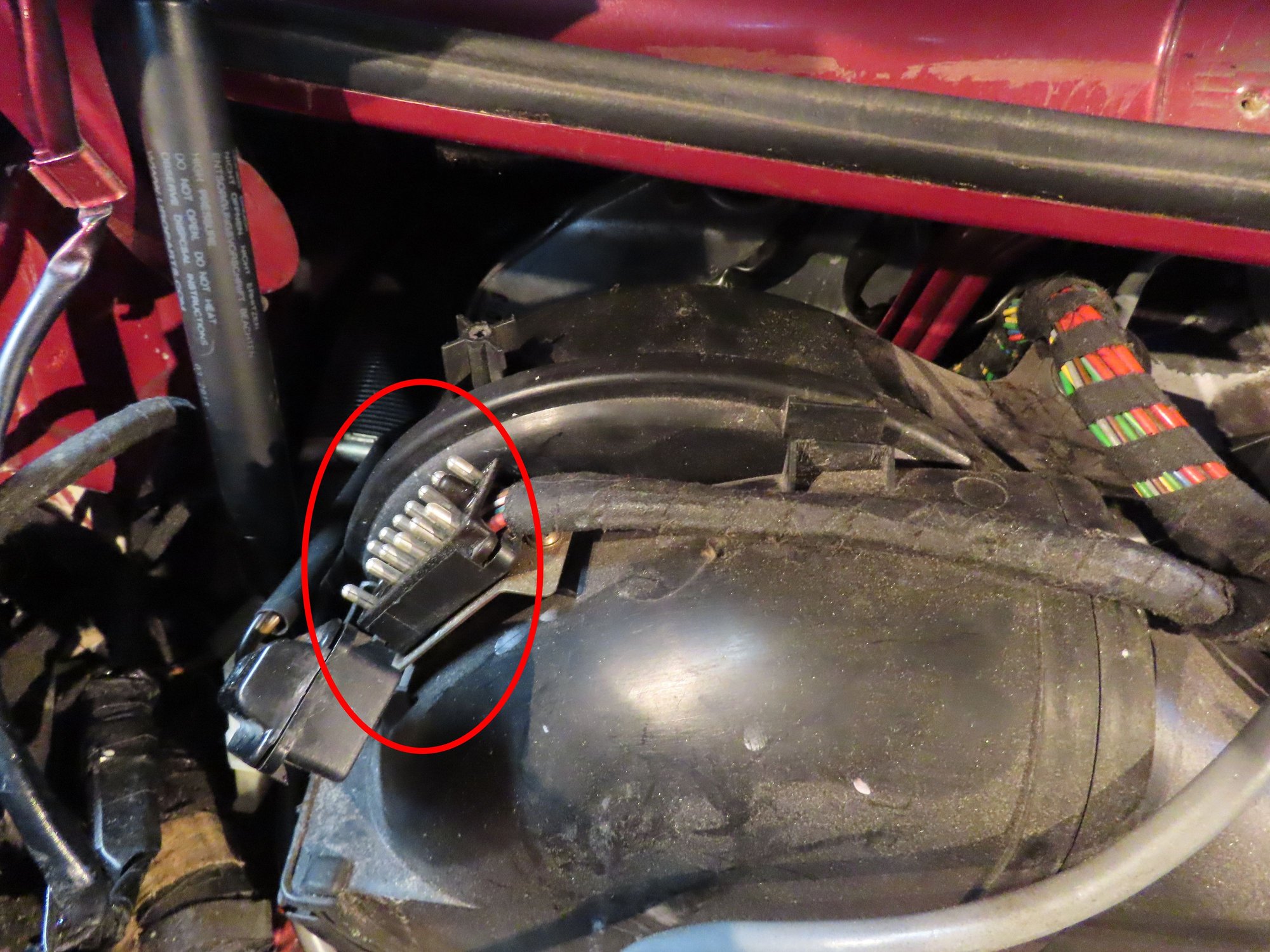

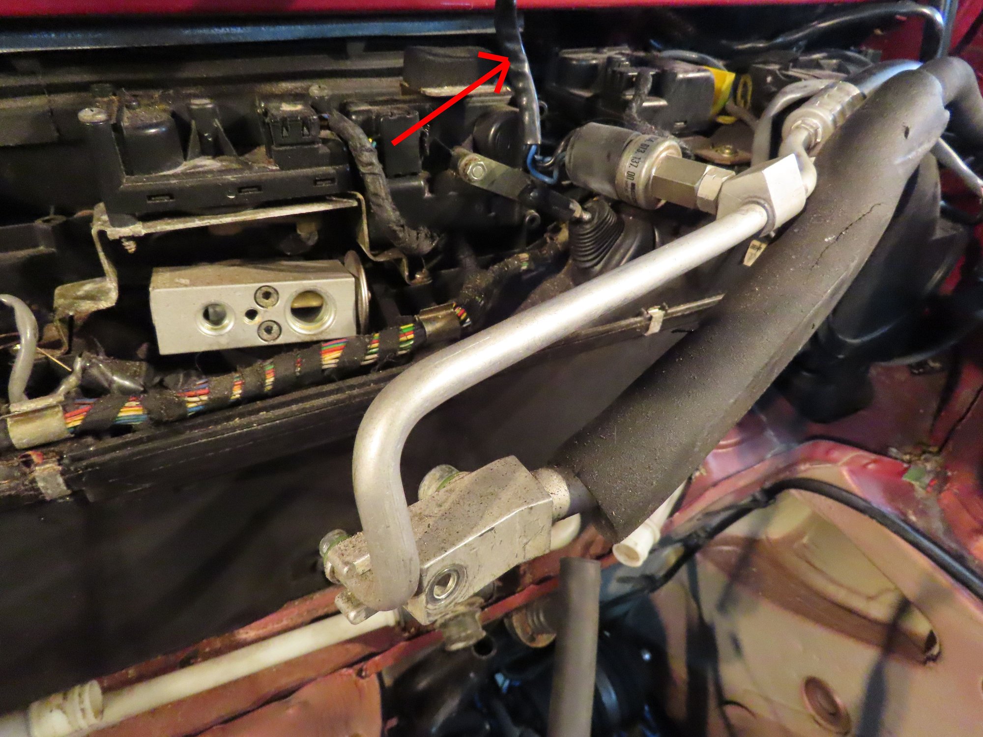

Next is unbolting the hard line from the expansion valve block and disconnect the sensor plug (marked in red).
Disconnect the plug on the end of the 'suitcase'.
