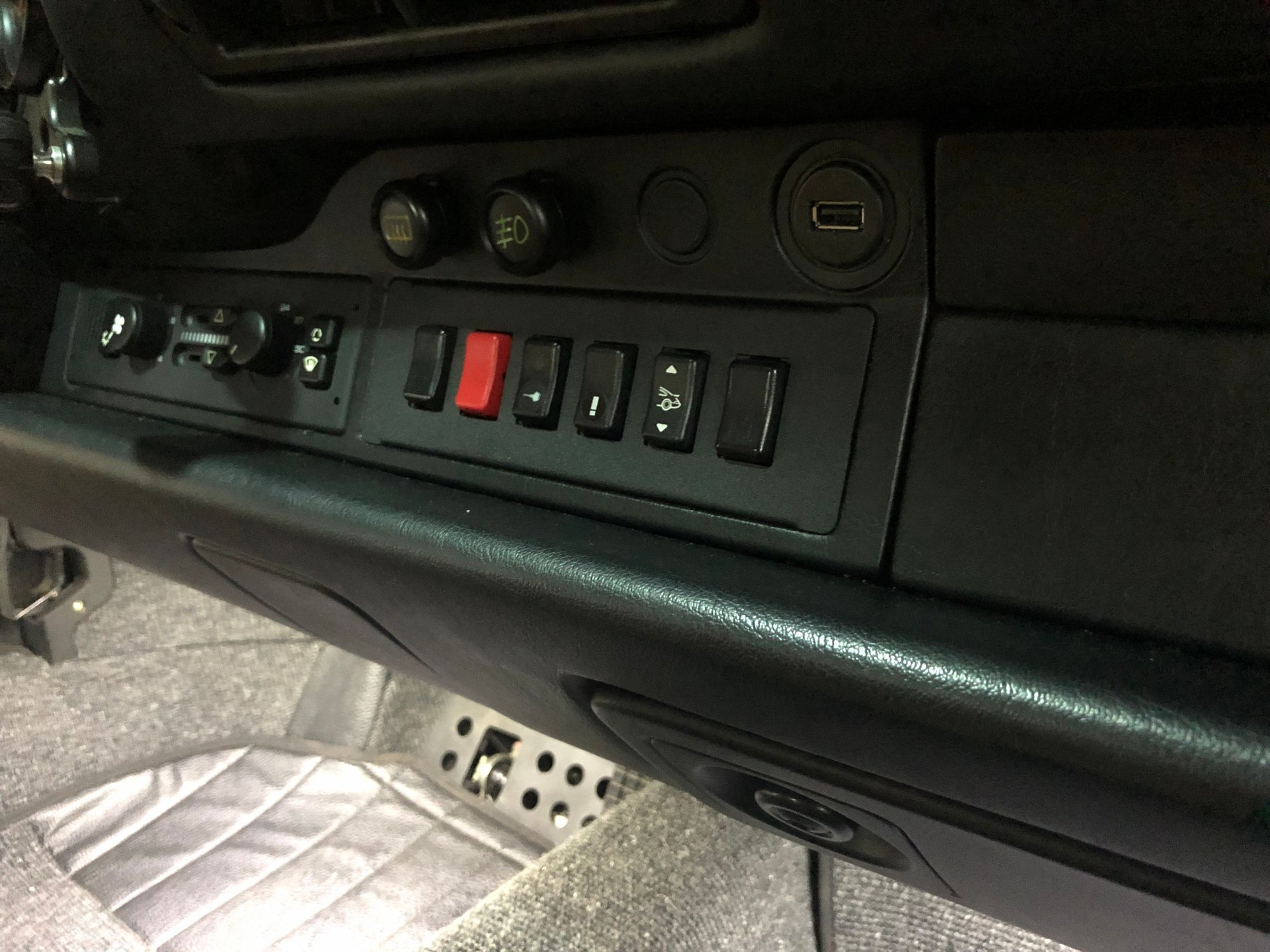

I've also done the centre console delete recently and moved all the switches to the dash.
Replaced the rotary spoiler switch with a 993 version and did the same with the rotary C4 diff lock.
It's relatively simple to do if you remove the wiring loom tape, as you don't need to extend any wires.
If you wanted to keep the radio and were not worried about the switches, you could always tuck them up under the dash.

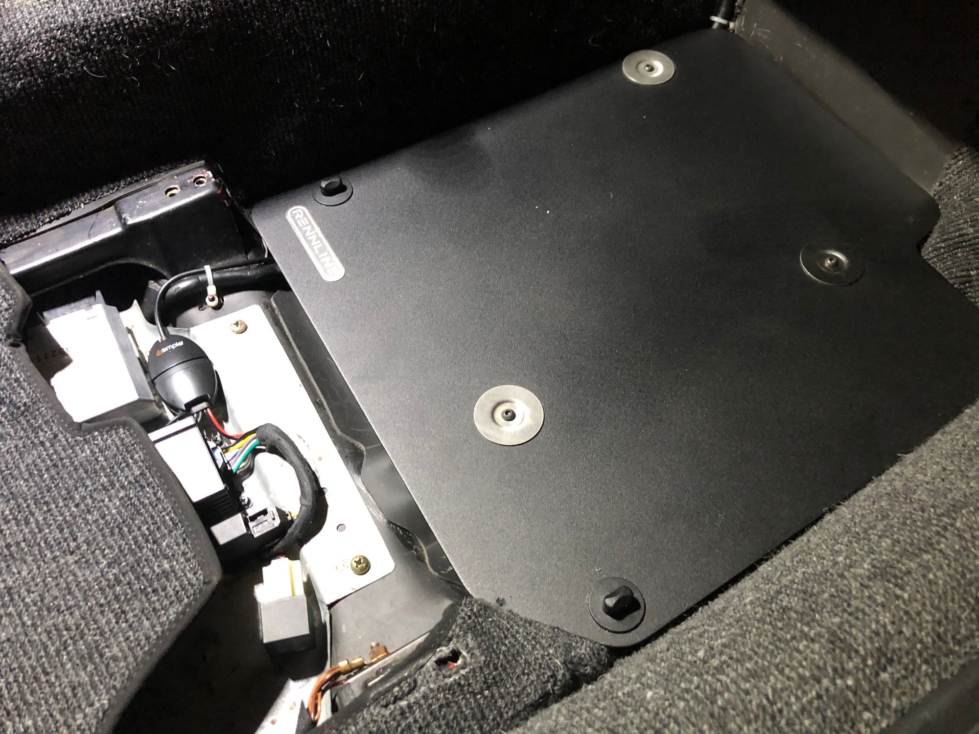

Not sure if this helps, but I sort of wanted the same thing. So I added an amp under the seat and a USB DAC/charger that is routed to a usb connector in the old cigarette lighter location. There’s probably a Bluetooth option out there but I wanted charging.
Now I can listen to Apple Music and get turn by turn through the speakers.

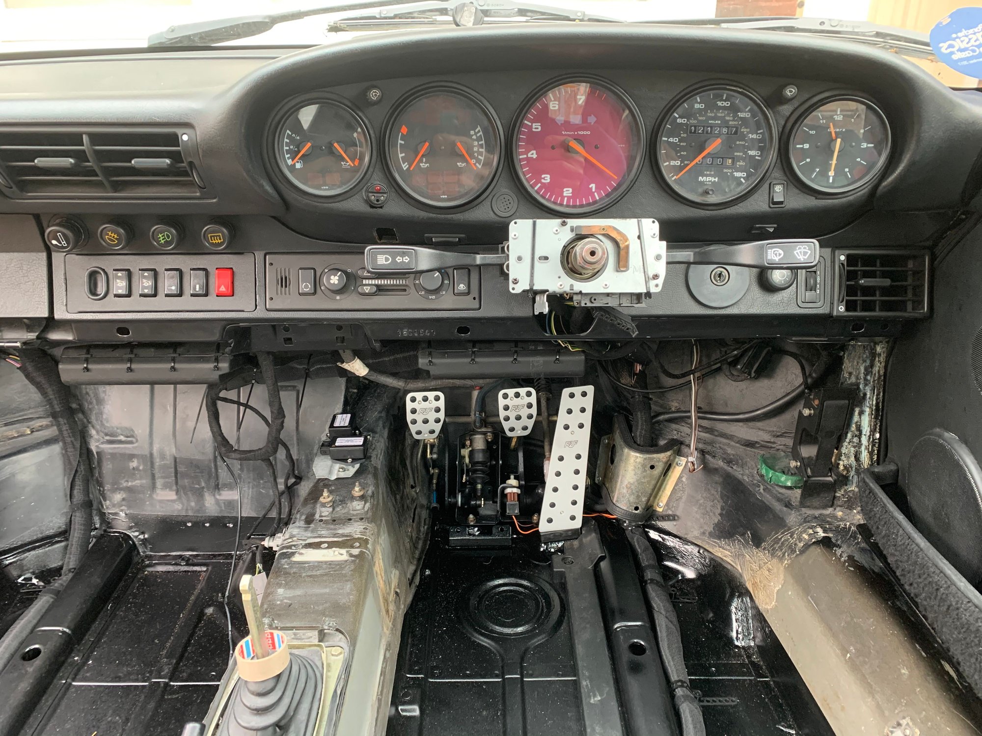

I pushed mine as far forward as possible, you can see them in my pic.
My plan is to have a very low profile centre console.
Which will be an extension of the original that'll have a handy tray ahead of the gear stick and cover the accelerometers.
