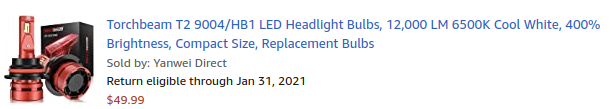

OEM headlight brightness is not that great. Going with fancy LED replacement headlights is way too much money (7 - 10% of car value ). So, I've decided to try some LED light bulbs and keeping the OEM headlights.
Got me these:
Super simple install, with no extra ballasts to tinker with. Just pull the old bulb out, and put these in. Significantly brighter than my old ones. And I mean significantly. Brighter than Xenons in my 993. For $50 can't go wrong.
No affiliation on my part, just sharing a great experience.

Just a quick update, after a few night drives, I am wondering why I didn't do it sooner. So much more light!

Did you go with the 6500k? Got any pics? Curious why this isn’t a more common mod considering the price!

I got the ones in the pic in my original post. 6500K - superbright, superwhite. Didn't do anything about fog lights. I'll take the pics later today and post it here. No warning lights what so ever. My car is '90 C2.

I'd love for this to be a viable solution, but I've always heard that non incandescent bulbs put out too much glare when used with reflectors designed for incandescents. Do these LED bulbs use tech that gets around this constraint?

Incandescent bulbs give light off from a single point and the reflector and lens are designed to focus that point source.
Also the light from the filament is of an equal intensity in every direction.
LED bulbs have multiple light sources spread over a large area, therfore the lens and reflector cannot focus the light and you get glare.
Also the light from each LED is directional, so you get dark spots.
The bulbs shown in the original post
Torchbeam T2 Torchbeam T2
have relatively small LED arrays placed in the same position as the filament on an incandesent bulb, so they are better than a lot of LED bulb designs.
However you will get dark spots since there are only two arrays of LEDs shining in opposite directions. But since the relfector and lens can't properly focus the glare will fill in the gaps...
Look up 'headlight revolution' on youtube, they have some great videos that explain the science and they show the effects of putting LEDs in old reflector housings.

We can theorize about glare and focus points, but the net result the lights do improve visibility significantly. Very inexpensive way to improve right now, while we save money for the more expensive technically correct ones. The cost of entry with these so so low and they are returnable. Try it, return if you don't like. No harm...
