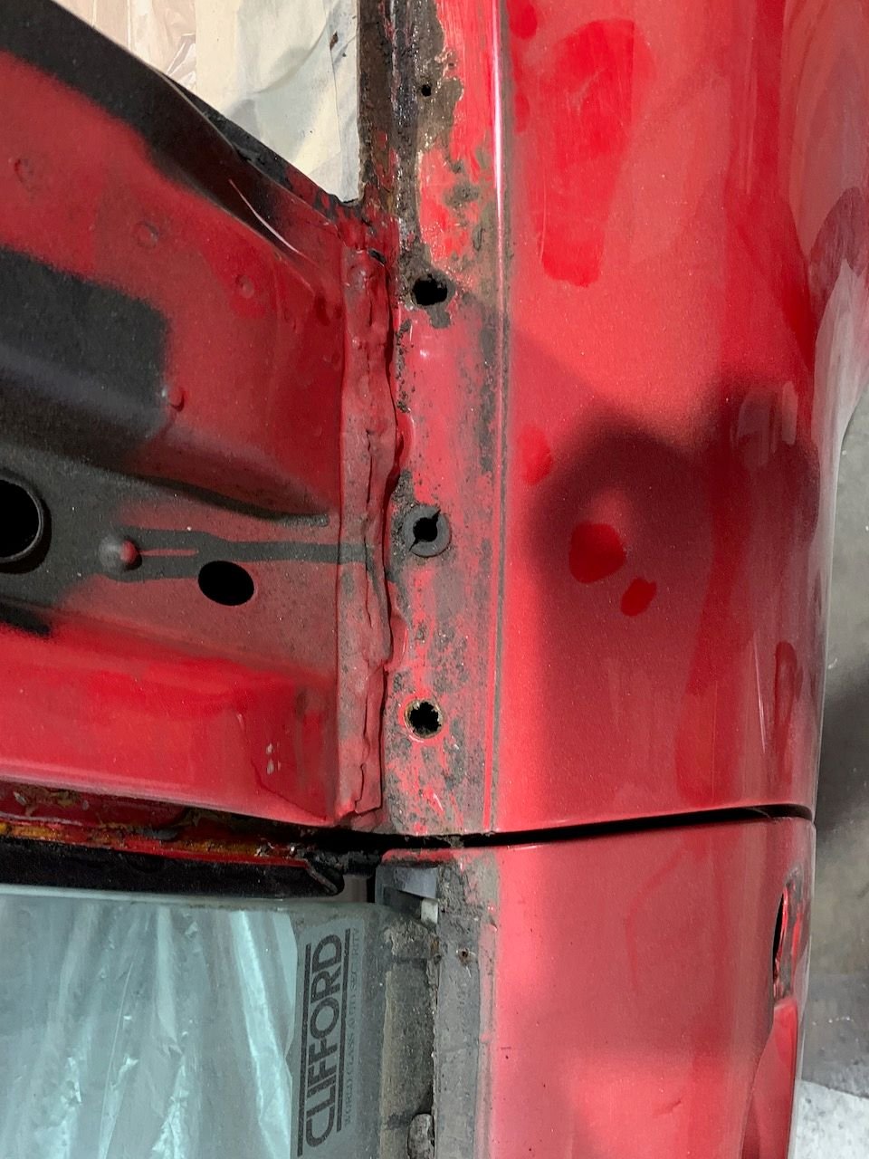

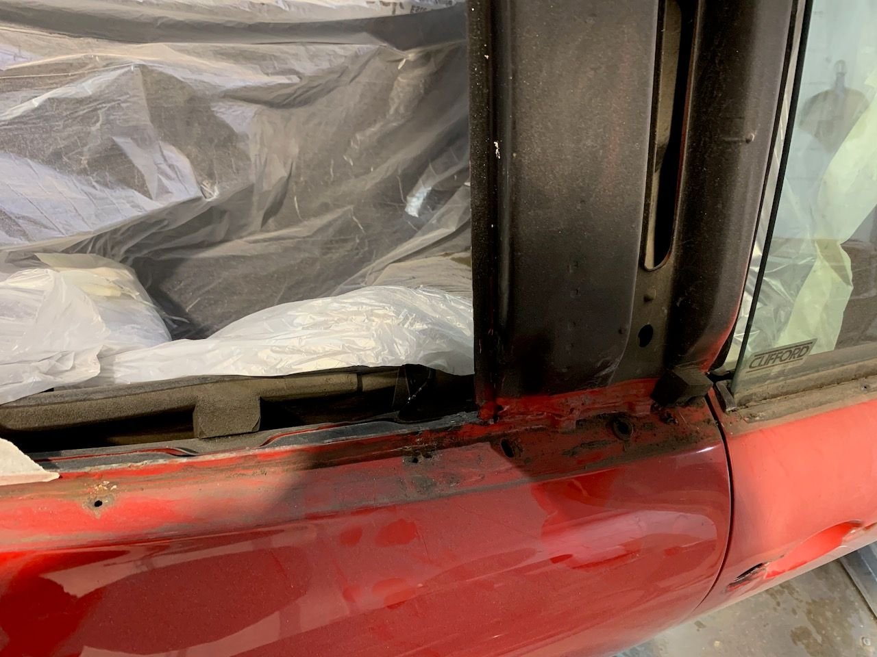

I am wondering if anyone here has swapped their Targa bar? I have a silver bar sitting in my garage that I would like to install instead of my black one,
the replacement looks relatively straight forward, except it looks to me like I have to move the oil tank out of the way.
has anyone here done that and how do I do that?

Mine came off for paint recently. I didn't do it but the pictures might help.

Please find link below to a posts I added a few years ago now on the 911uk Forum.
About halfway through you will find a description of the process I went through to remove the targa bar cover without removing the oil tank.
In short, if I had to repeat the process I would remove the oil tank.
http://911uk.com/viewtopic.php?t=112...spring+refresh
