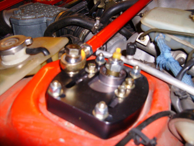

Anyone have pictures of the Ground Control specific stressbar?
I am heavily debating going with or without camber plates. I do track my car, but i am not one to bother making adjustments to the camber between track and street duty. I mainly do not like the compromise of having to adjust camber and the effect it has on the toe. I was using the KLA monoball mounts on my n/a and liked them also, only $220 for the pair also.
![](https://lh6.ggpht.com/_F5ch6Qn8yFA/SaCzIsrr3EI/AAAAAAAAATM/wUHpN_32hrU/s640/944stress%20001.jpg)

I run the Ground Control bottom-mount plates, but I purchased them with the GC front struts, which are shorter than stock, so lowering the car is not an issue at all if you buy them as a combo. I've lowered the front as much as I can without dropping it lower than the rear, and I almost never hit bump stops on the street (and I never hit them on the track). The rear is fairly low, I'm using a modified eccentric bolt from GC that allows the rear to drop much lower. Camber adjustment is very easy.
