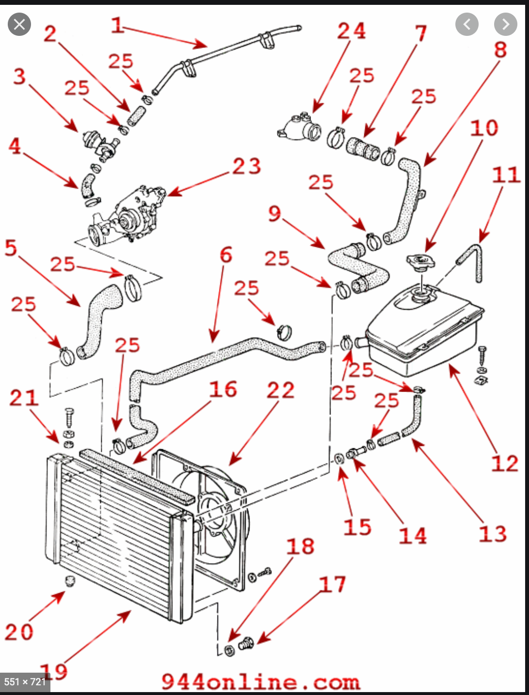

Hi all. We are working on an 83 944 5 speed (no trans cooler here). We pulled the motor so the frame could be straightened and now we are putting the motor back in. I have a question that is stumping me right now.
The Radiator has a small (1/4" ish) nipple right at the top drivers side. I would guess that it gets routed to the overflow bottle, BUT I have no matching nipple on the overflow tank. Were does this nipple get connected? I did not take pics of this specific part on tear down, and the parts fiche also does not look like what I have.
The 13, 14, 15 assembly would be the likely candidate for this nipple, but my overflow bottle does not have this connection. Can anyone share some insight for me?

it's on the side of the tank below the radiator cap.

Sweet! Thanks for that. We found the hose that was obvious now that you pointed out the location of the nipple!
