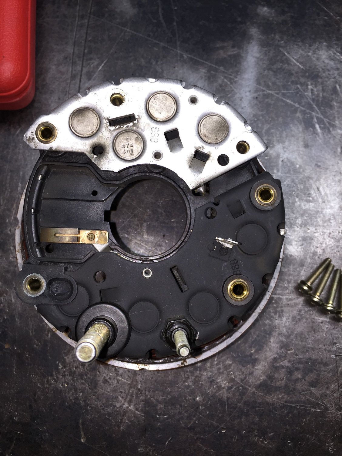

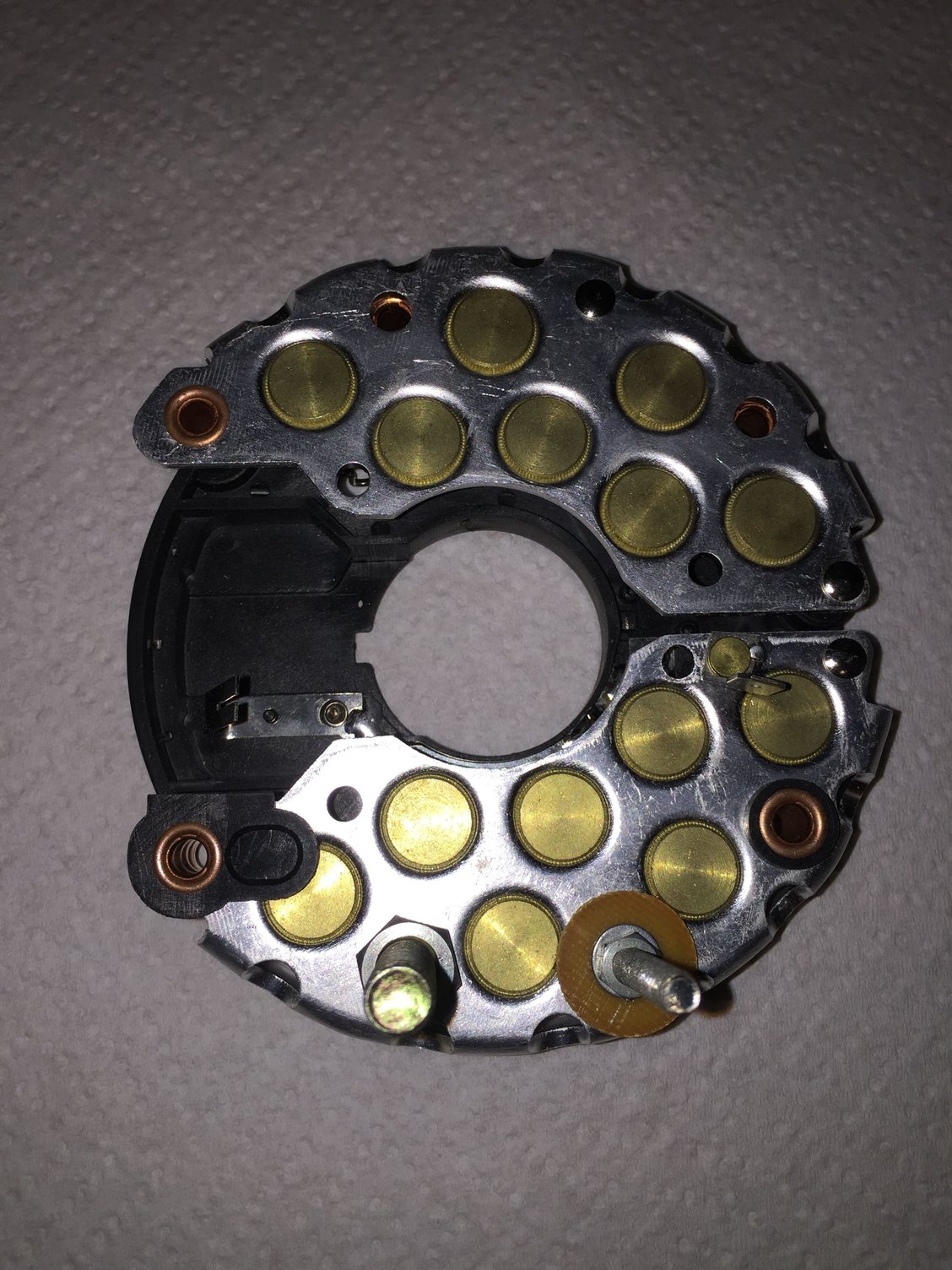

One of them is a new rectifier assembly. I have noticed it has more diodes. New one has 14 while old one has 8. The alternator is a Bosch 115A unit. Any reason NOT to fit the 14 diode rectifier?
From my electronics training, more diodes equals more capacity and better rectification.
I am used to working on GM 12SI and CS130 alternators. Bosch, not so much.
8 diode rectifer from alternator.
New 14 diode rectifier.
Thanks!

I'd test the diodes in the old rectifier pack. If they are good, save the new part for when you need it.
The Big Deal on diodes in this service is heat dissipation. As interesting as it might be to have a parallel pair for each end of each stator coil. if the diodes themselves are capable and mounted in an adequate heatsink, the total capacity will be the same as the pairs if they are all mounted the same way.

As per your reccomendation, I left the 8 diode rectifier in place. All the diodes tested good.
The alternator looks to be a Bosch reman unit fitted relatively soon before the car hit the salvage yard. I put new Nachi bearings in it for peace of mind. Everything else, I just cleaned and reused. I will have a thread shortly about it all.
