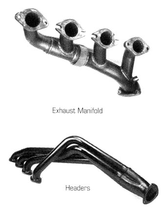

Comparing those pictures, it looks to me that the exhaust pipes would have to be modified to change to from stock pre-S4 to MSDS, vs. to the S4-headers.

FWIW,
The picture that BC posted is of the later "tubular" style factory exhaust manifold/header, this was used starting with the S4 cars in '87. Done in monel stainless tubular, a nice piece all things considered. It can handle a lot more temp abuse than any tube steel header - won't flow as well as a well designed and built header, but monel holds up incredibly well when compared to a tube steel part - regardless of the "magical mystery coating" that's applied to the mild steel unit.
Pre 87, all cars used one a variety of the cast-iron style exhaust manifolds, even the euro cars.
The cast-iron euro manifolds have been said to flow "pretty well", but I have never actually remembered to pull a pair and compare them to the US spec when I had them around. I have also never seen any flow bench data to support that claim.

GBYRON,
You are incorrect.
The tubular exhaust manifold in the picture is of an S3 928 ('85-'86). Note the number of bolt holes as being 2 instead of the S4-Up being 3. The cast iron manifolds were were used up until, and including MY 1984 (US models).
However the S3 manifolds can be bolted up the the S2 or S models with minor modifications to the exhaust system.
