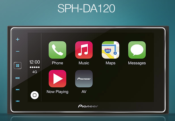

Pioneer just introduced at the Paris car show the SPH-DA120 (http://goo.gl/T9rqfa) with CarPlay functionality.
I do like the clean look. Should go very well with the flush console.
MN

^^^^^^^^^^^^^Hmmmm..........My interest in double din (flush or otherwise) console mods just went up big time!
