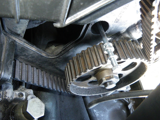

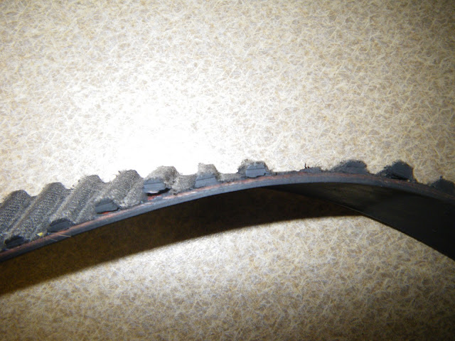

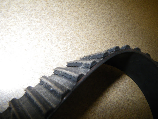

I think this qualifies as "premature failure":
http://picasaweb.google.com/lh/photo...eat=directlink
Luckily it was on an 82 - so no damage it seems.

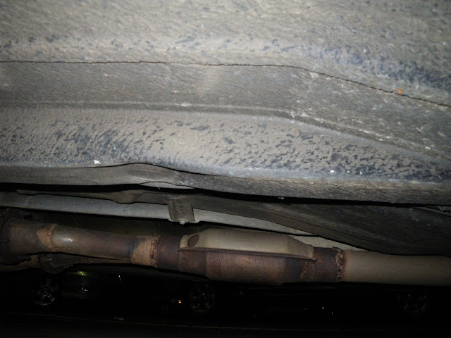

Somehow I doubt this is at factory spec:

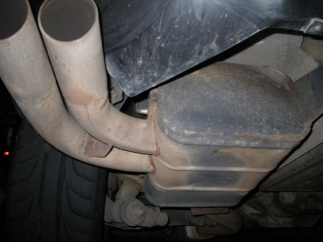

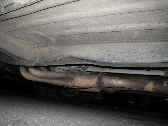

Can someone identify this exhaust? To me it looks rather like the Ansa Sport

1) Try to figure out the reason for premature belt failure. My earlier thread - Premature Timing Belt Failure - should be a great reference resource now.

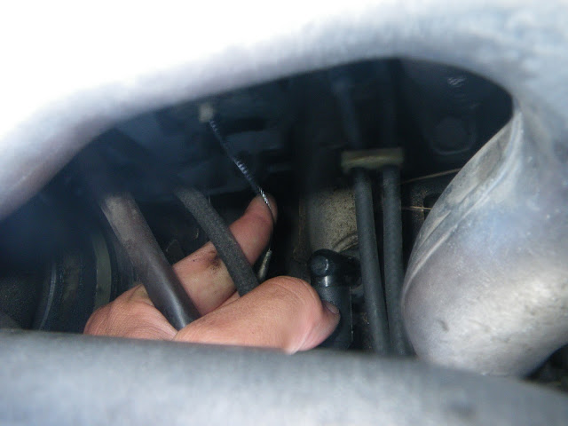

-Throttle cable (as shown, I think she's a little loose. )
-Exhaust/Cat ??? This was suggested by the shop. I think Roger's opinion that it wasn't likely an issue made sense. On the other hand, perhaps the aftermarket exhaust/muffler could have corroded inside and caused some sort of blockage?

That is an ANSA which is a very poor system very common to rust out and the cat is quite small and aftermarket as well.

Thank you for the verification - I thought it looked rather like the ANSA diagram. From the receipts, it looks like it may have been installed in the mid 80s.
I've absolutely no problem replacing it - thank you for the suggestion David. Seeing as I'd probably want to be replacing the CAT too, that price seems fair I would guess. Is there a reason you thought it a bit high?
It looks like that Y-pipe has curved ends though - so I'm guessing I would have to replace the headers too? Mine come straight back:
Alternatively, I assume the Y-Pipe could be cut and welded?
Replacing the exhaust might even quite things down a little! That would be a blessing.

Tightened the throttle cable up as much as possible - though I think the cable still has a little too much slack (deflects ~1/4" under finger). I realize there is supposed to be a slight slack to allow the idle switch to engage, but I think this is a little much. I'll have to replace the cable in the future. This improved responsiveness greatly, however.
Well Landseer, I haven't tested anything with a vacuum pump (or smoke) yet, but vacuum lines are supposed to come off under gentle finger pressure, right?
So, I think I may have a leak or two around. From what I have read, the factory vacuum lines were all plastic, correct? Some of the smaller lines are still plastic, but it looks like most of mine were converted to a sort of sleeved rubber line (sleeved with a braided fiber of some sort - looks kind of like the old style hydraulic hoses). They don't seem to be in bad shape, except that the ends are all splitting where they've been on the fittings (and so leaking I will guess)
I'll have to take a copy of the service manual page with me to look at the Vac advance/retard.
I've also noticed there's a hose connection on the passenger side of the airfilter cover. I don't see it in the parts catalog diagrams, but its obviously part of the molding. What purpose is this? Does it feed a sensor?

A smoke tester isn't needed.
Look for loose hoses. Cracks/condition of the 8 boots on the intake tubes. Seating of the AFM in an O-ring in the throttle body (run finger around inside of throttle body, if the O ring has a flat edge, it needs replacement). Crankcase breather, brake power assist hoses, all need to be crack free. These are ones that will pass large amounts of unmetered air and totally screw up running.
So will improper hook-up of advance and retard.
The hose connection is for for clean air feed to air pump hose I think on some cars.
There really isn't much more to say. No simple answers. Ante-up, dig-in and enjoy rehabbing a 28/9 year old porsche. Sometimes it will even run for a while.

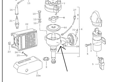

Went to replace the distributor cap and rotor. After carefully marking orientation of cables, I discovered that they were also marked on the cap itself - better safe than sorry though. These were a lot less work to replace than I expected. Simply pull off, replace. The old rotor was worn ~1/16 of an inch on the long end when compared to the new one. They appeared to be a subtly different design though (not something that seems as if it would affect usage).
The contacts on the old cap were roughly half oxidized. I am not certain if this is normal. When I placed the new ones on though, I discovered that it seems I am missing one of the tabs to hold the distributor cap down. The pin easily locks on the back side, but in the front there is no tab on the front
It should be right at the end of the arrow in the above picture, but doesn't seem to appear in the picture. Am I imagining this part? I don't see any other way for the front pin on the distributor cap to lock on.
(By looking at the length of the screw holding the vacuum timing unit on, it also seem as if there is something missing).
Since it seems like this could potentially destroy the rotor/cap, the old pair went back on and the cap was temporarily secured on this side with a pair of zip ties. Not a great solution, but strong enough to get me back to campus.

Thank you for reminding me Imo000. I had almost forgotten that after my alternator issues started. It looks like the two cam gears are good, but the oil pump gear (correct name, right?) looks very far gone. I now understand these pictures a heck of a lot better. Those edges are a lot sharper than they look!
I forgot to look at the gear on the crank - I'll have to do that in the morning before class.
Pictures:
Edit: Regarding the exhaust/headers - its something that I may do in the future (leaving the headers, but replacing backwards from there), but more urgent changes (gears, alternator) are taking precedence.
