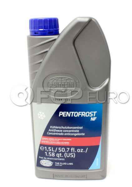

Correct OEM coolant for the Porsche 928 is Pentosin/Pentafrost NF.
It's available most places ....1.5 liter bottles are the ones I use. It's blue.
ONLY ever use distiled water....always distilled only. Also remove both water jackets in the block...you will be surprised how much those hold and the car will hold the proper volume o mixed 50/50 if you fully empty the system. I was unable to reach the drivers side with stock manifolds on the 86 but with headers it was reachable.

Correct OEM coolant for the Porsche 928 is Pentosin/Pentafrost NF. It's available most places ....1.5 liter bottles are the ones I use. It's blue.
Do you have a source for that? I see on their spec sheet that it's referenced to Porsche part numbers, but I don't see anything linking it specifically to the 928. When I look up those part numbers, all but the last are obsolete. I don't doubt you, it's just confusing trying to connect the dots. Greg Brown recommended Porsche 000-043-305-75 but that's now obsolete. And ironically, it's not on the Pentofrost NF spec sheet. Thanks
