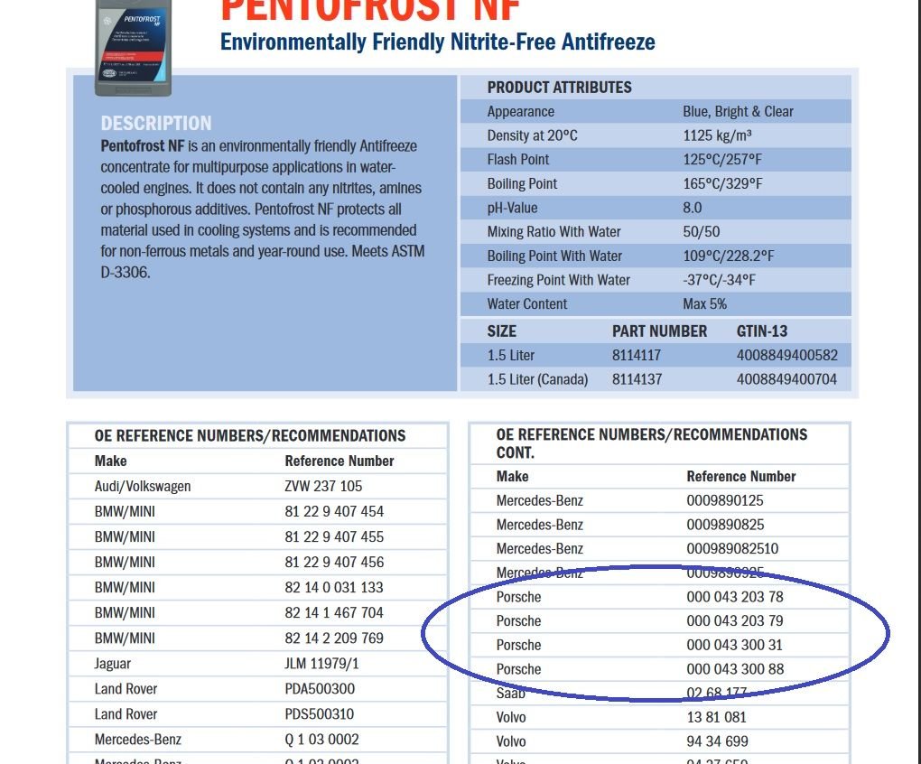

Originally Posted by NoVector
Do you have a source for that? I see on their spec sheet that it's referenced to Porsche part numbers, but I don't see anything linking it specifically to the 928. When I look up those part numbers, all but the last are obsolete. I don't doubt you, it's just confusing trying to connect the dots. Greg Brown recommended Porsche 000-043-305-75 but that's now obsolete. And ironically, it's not on the Pentofrost NF spec sheet. Thanks
I googled Pentofrost NFand found plenty of places. NAPA auto parts sells it.
