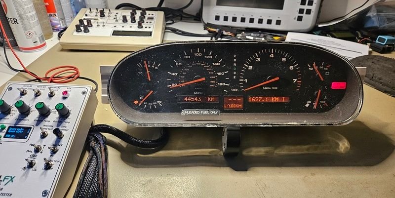

Hi all.
I am repairing a 928 digital instrument cluster, and I would like to convert it from kilometer to miles. This is the European version without possibility to change between km/miles with the stalk.
In such a conversion, I need to adjust the odometer to show the correct mileage in miles.
Are there anyone with in-depth knowledge in how the mileage is coded/stored in the 9346 EEPROM in these instrument clusters? If so, could you please send a PM to me.
Thanks, and cheers from Oslo,
Tore

Old Jan 26, 2026 | 07:19 PM

Old Jan 27, 2026 | 03:58 AM
Bergvill F/X's Avatar
Bergvill F/X
Basic Site Sponsor
Joined: Jul 2025
Posts: 88
Likes: 16
From: Oslo, Norway
khalloudy, thanks. I have already sent an email to Mr. Jenniskens, and hope he will be able to reply.
The instrument has part number 928 641 163 02, with software version K26.
Cheers,
Tore
Old Jan 27, 2026 | 12:29 PM
hans14914's Avatar
hans14914
Joined: Aug 2003
Posts: 2,679
Likes: 356
From: Indianapolis
I really like your bench test assembly. I would love to see some more pictures of that in action.
Hans

Old Jan 27, 2026 | 03:03 PM
Bergvill F/X
Basic Site Sponsor
Joined: Jul 2025
Posts: 88
Likes: 16
From: Oslo, Norway
Hans
Thanks, here's another picture.
Cheers,
Tore

Old Jan 27, 2026 | 09:49 PM
PC-85-928S's Avatar
PC-85-928S
Joined: Jul 2011
Posts: 1,032
Likes: 202
From: Long Island, NY
Did you make that tester tool?
