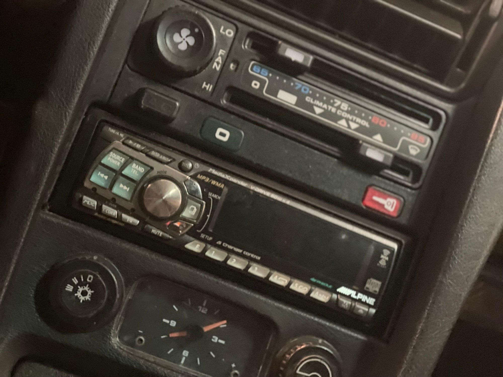

I just took these pictures of my 89.
The ODO reset is on the console. The green button.
the bottom button on the left is for the rear wiper.

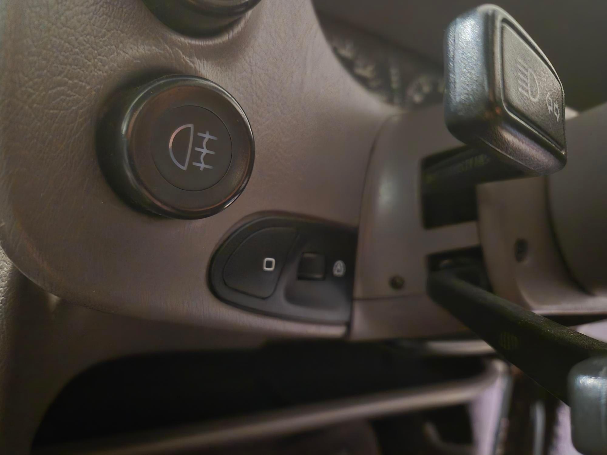

My 90 GT zero button is bottom left under the fog light switch as Bilal928S4’s picture shows.

Hold that small button down next to the thumb wheel. That will reset it. My 91 euro GT was setup that way.

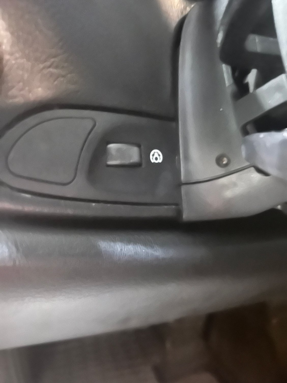

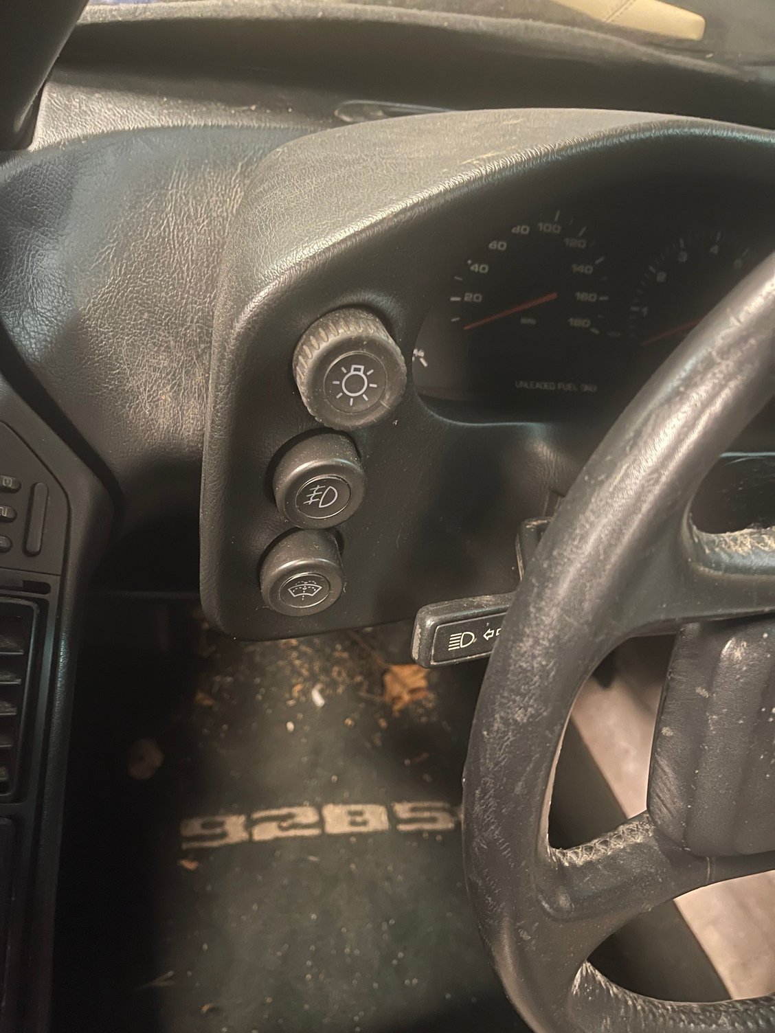

Thanks guys. Here is my issue: attached are two pics of the set up on my car. Pushing the last button on the left under the light switches does nothing and I don’t have any button buy the thumb wheel as you can see. It is possible the push to reset know on the left of the pod is not working
Pushing last know does nothing
No button by thumb wheel

The 90+ has the button per your picture. Make sure it is connected properly after you replaced the cluster. Or the switch is faulty.
Hope that helps.
