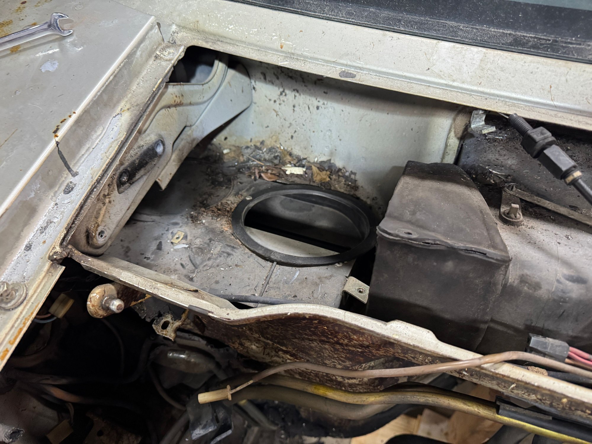

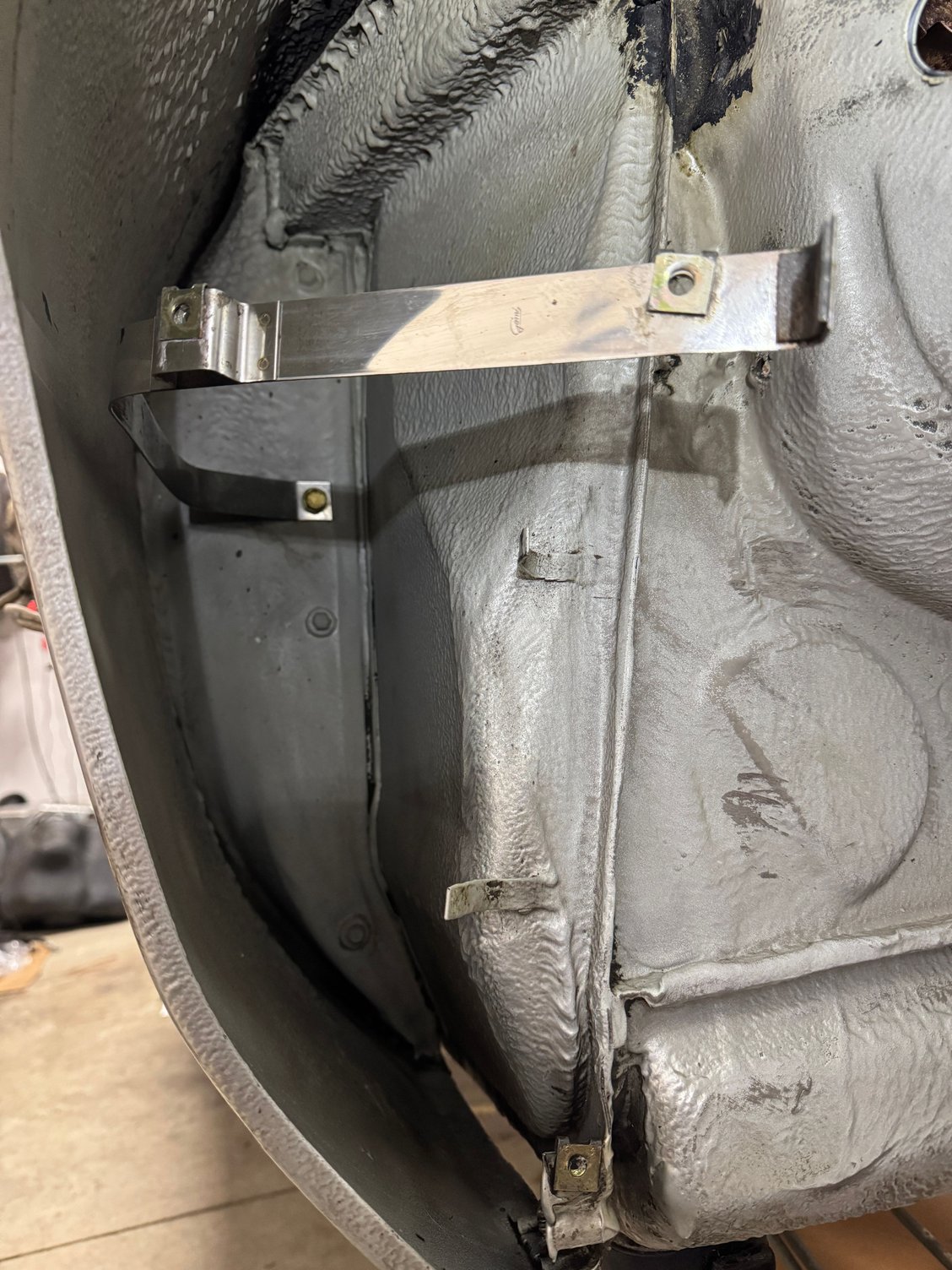

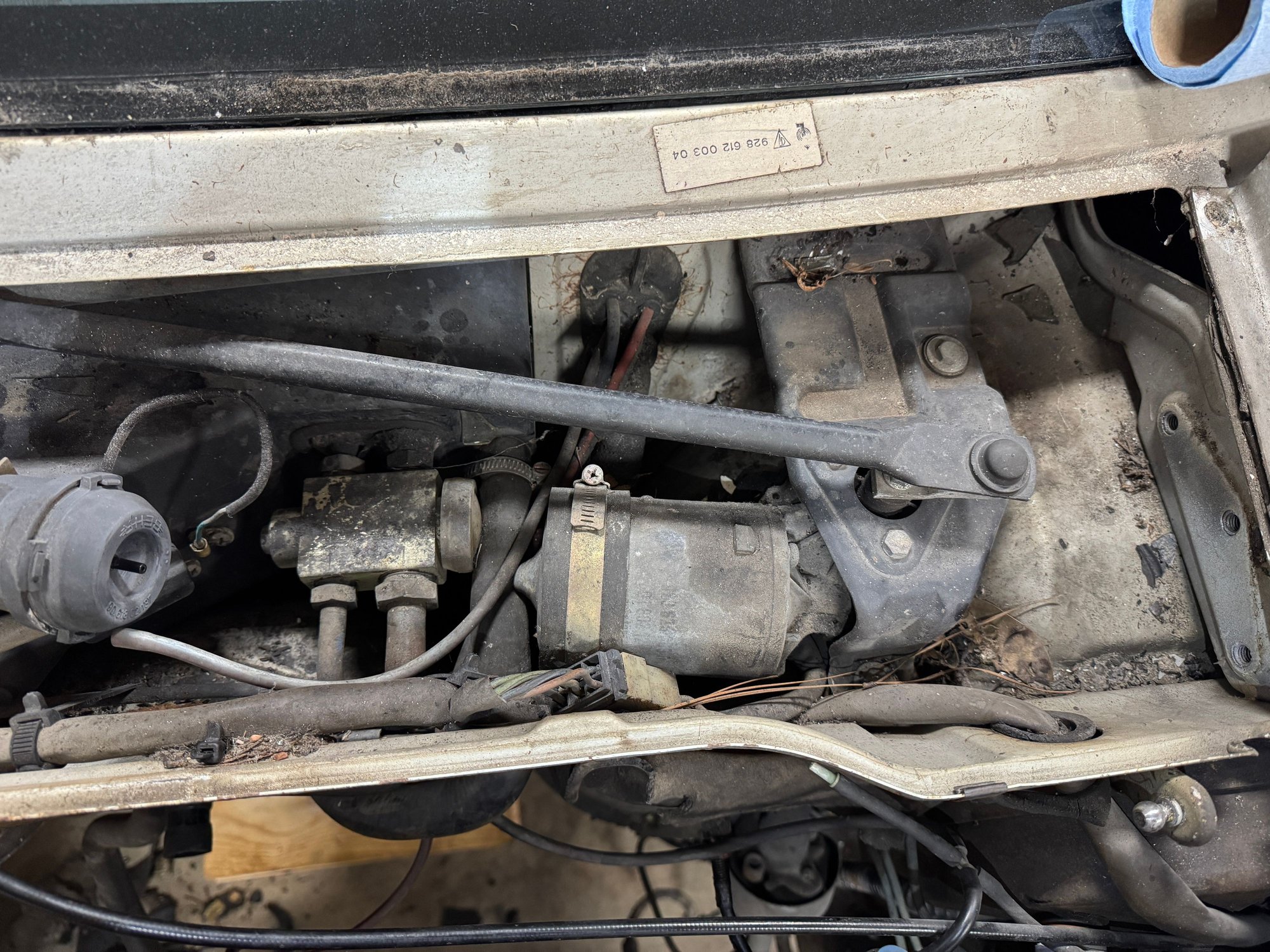

Default Upper HVAC Refreshing
Whew…it may not look like much but that was a lot of work and I still need to finish it up. I can at least see the light at the end of the tunnel. I’m taking this opportunity to go ahead and install a new blower resistor. As outlined in various posts and vendor directions, on early cars, it is necessary to pull pin 8 out of the harness and move pin 6 to its place. You will see the brown electrical tape showing this conversion. I also checked the vacuum actuators on the fresh air flap and center locations. Both held. Took apart the center actuator and cleaned the pod and coated the diaphragm with a little DC111… @Mrmerlin ’s favorite at safe-guarding long term rubber condition. Deoxit’d all the connection. Still need to pressure test the heater core and evaporator, reinstall resistor and install the freeze switch. I think I need to find a mounting solution for the new freeze switch, as the mount is not the same as later 928s. Most importantly, I cleaned and cleaned, which took the vast majority of the time. My hands are killing me.
I also threw in a pic of the windshield washer fluid fender area for fun.
Before and after pics below

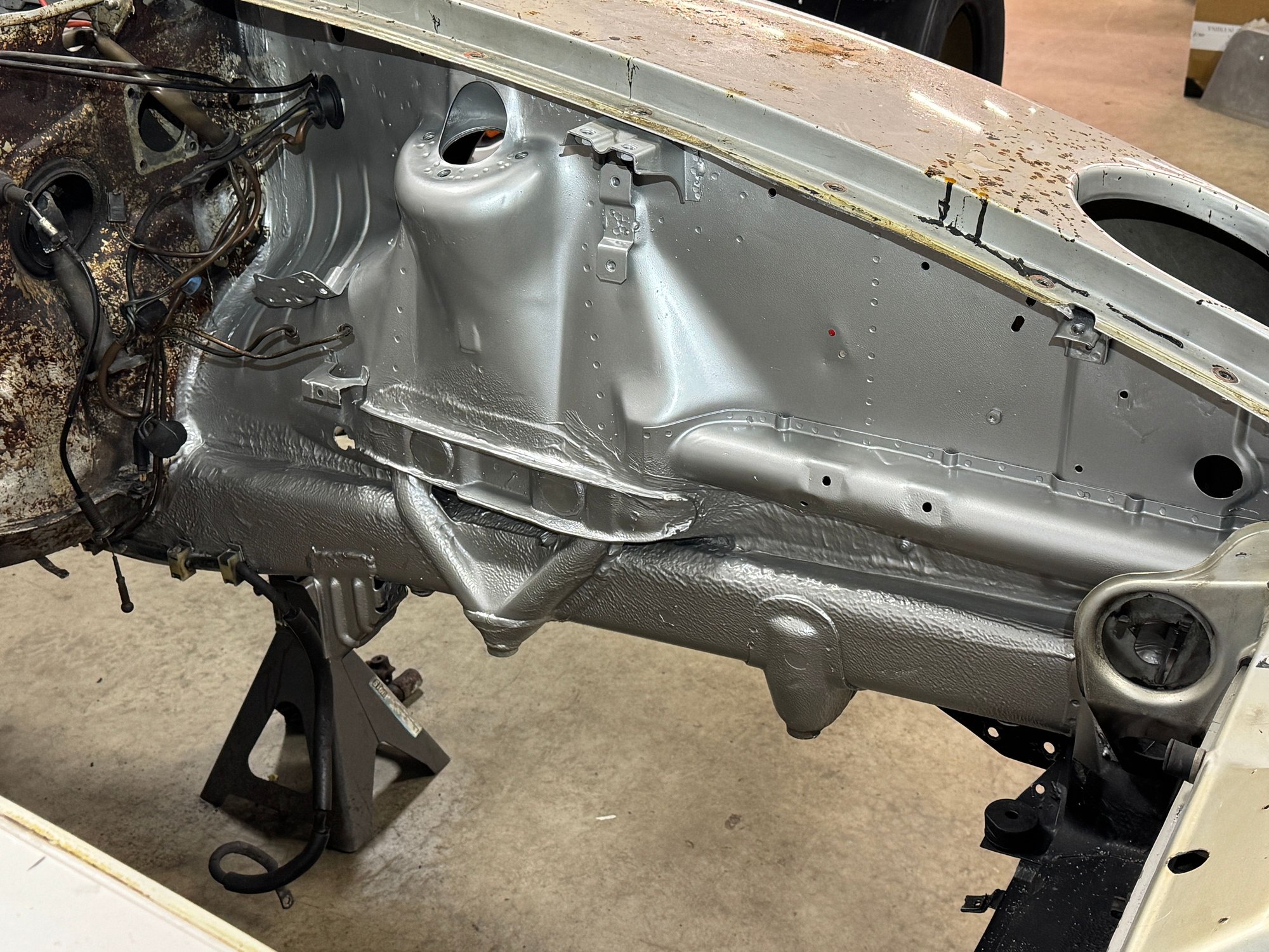

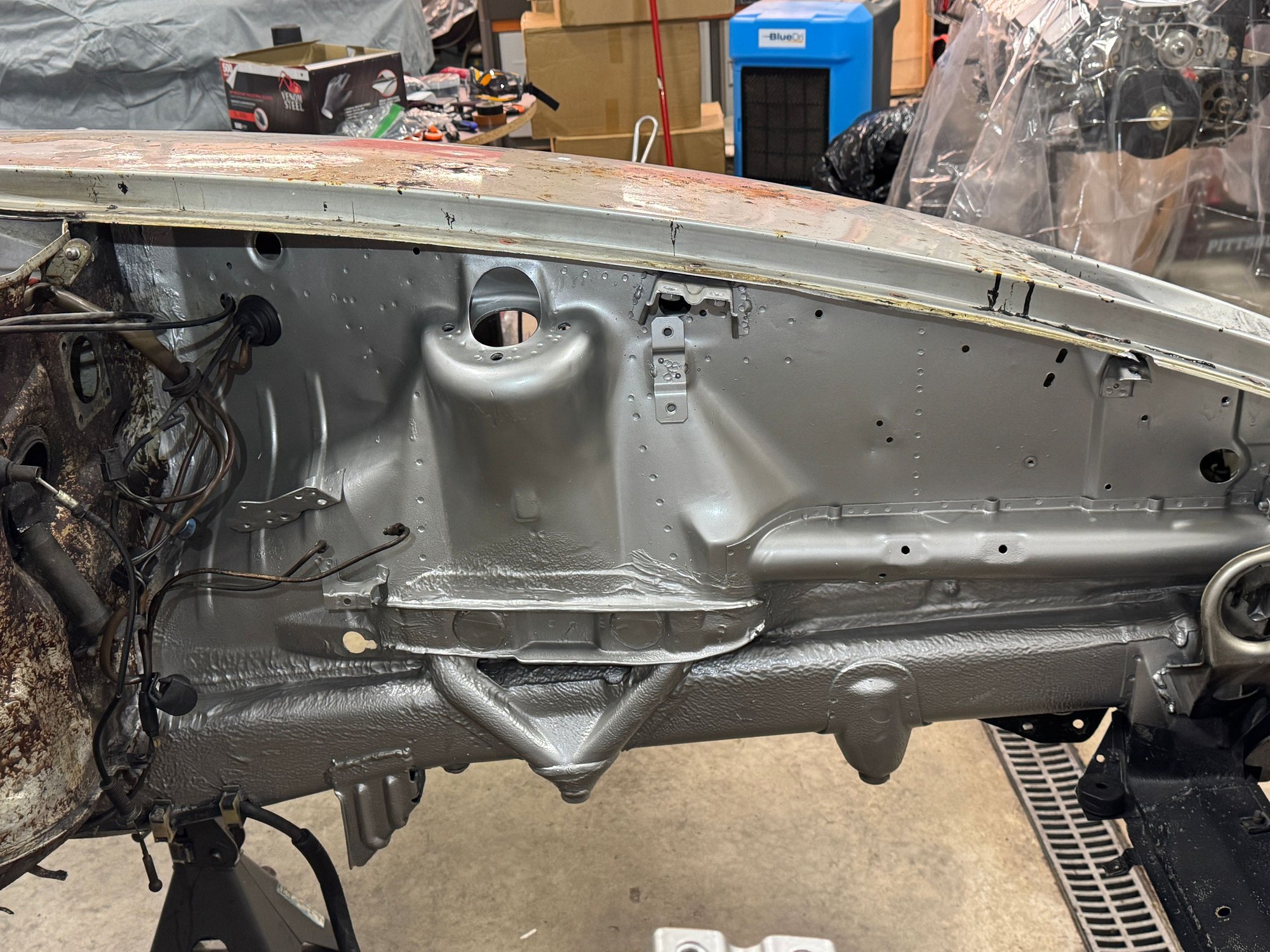

Default Painted and Need Some Help
Hey all. Got the engine compartment painted. I have a new appreciation for professional painters, however, I’m pretty happy with the result thus far. Next up is the firewall barrier.

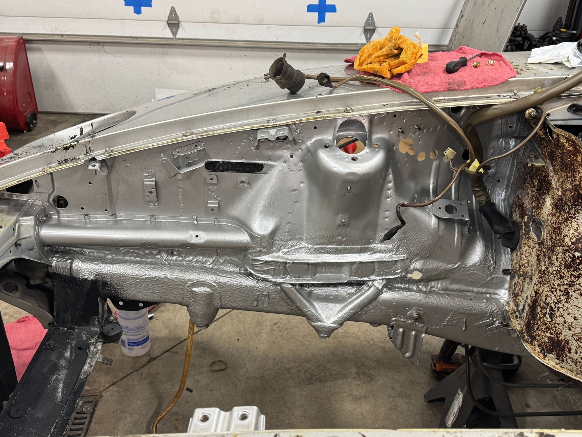

Old Jan 17, 2025 | 05:34 PM
  #120
streetsnake's Avatar
streetsnake
Joined: Apr 2022
Posts: 1,391
Likes: 582

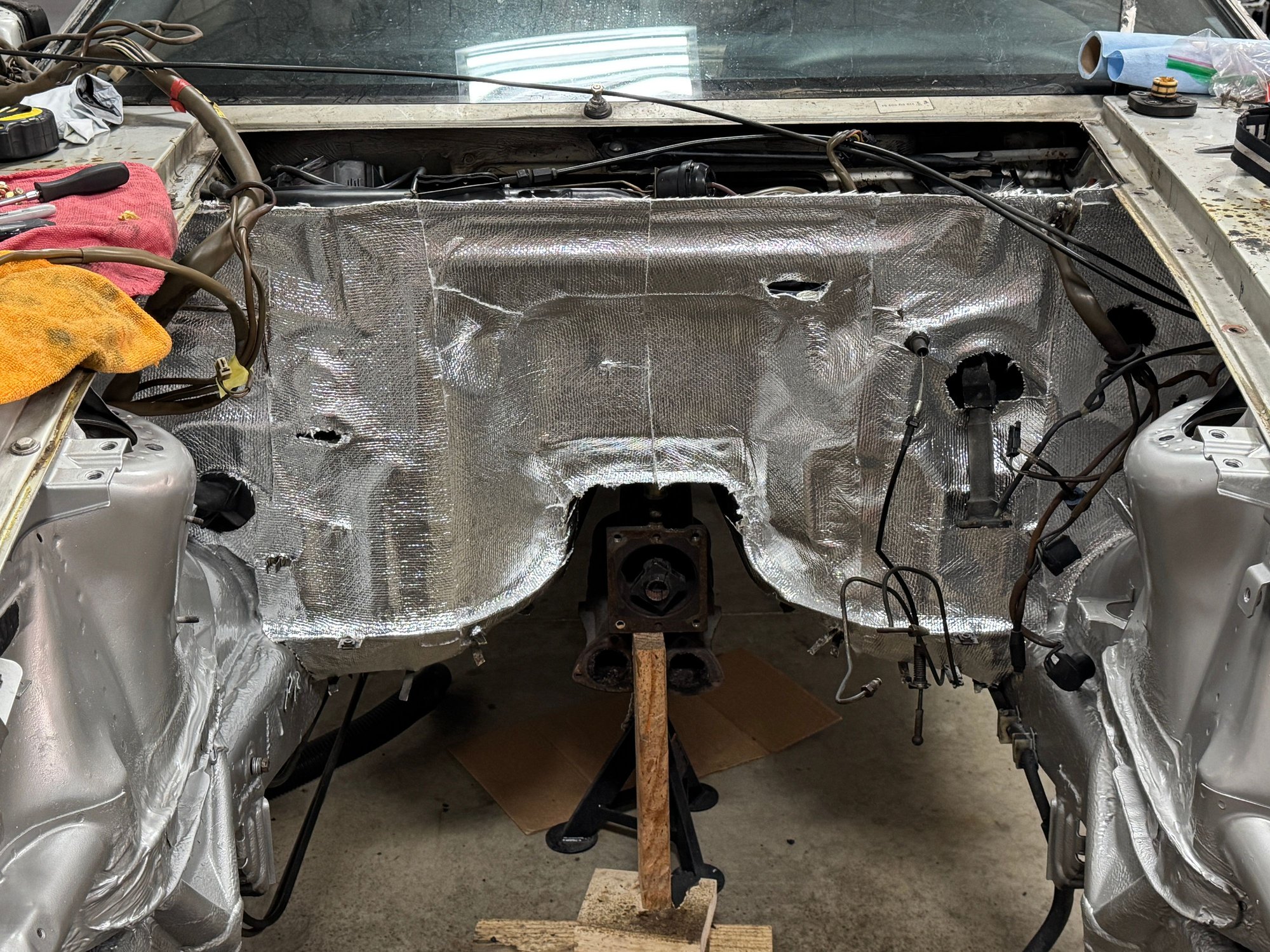

Default Firewall: Not Finished, be Kind
So, this is a bit of a pain in the butt. It isn’t as easy as making a template, at least with the DEI Heat Shield material. It fiberglassed backed “fabric” and doesn’t allow much give as you are working around the various contours of the bulkhead. We ended up doing sections with large-ish strips. I still need to go back and trim out all the holes and recesses, cut along the top border to allow for the molding to slide on, and paint the top section black to better match the original. I also harvested the top aluminum strip from the parts car to better secure everything.
Question: should I use DEI’s “tape” to go over the seams or do you think it will be fine as-is?
