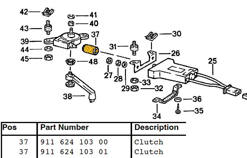

I have done some research and there are several posts about a "clutch" failure. I dont remember the specifics but scan through this search result: site:rennlist.com inurl:928 sunroof clutch.

There can be sunroof motor clutch issues, but that is not what is described. (You eventually create a clutch issue if you are treating a stuck switch as one-touch and not stopping it after the sunroof closes...the motor keeps running and the clutch burns up.)
