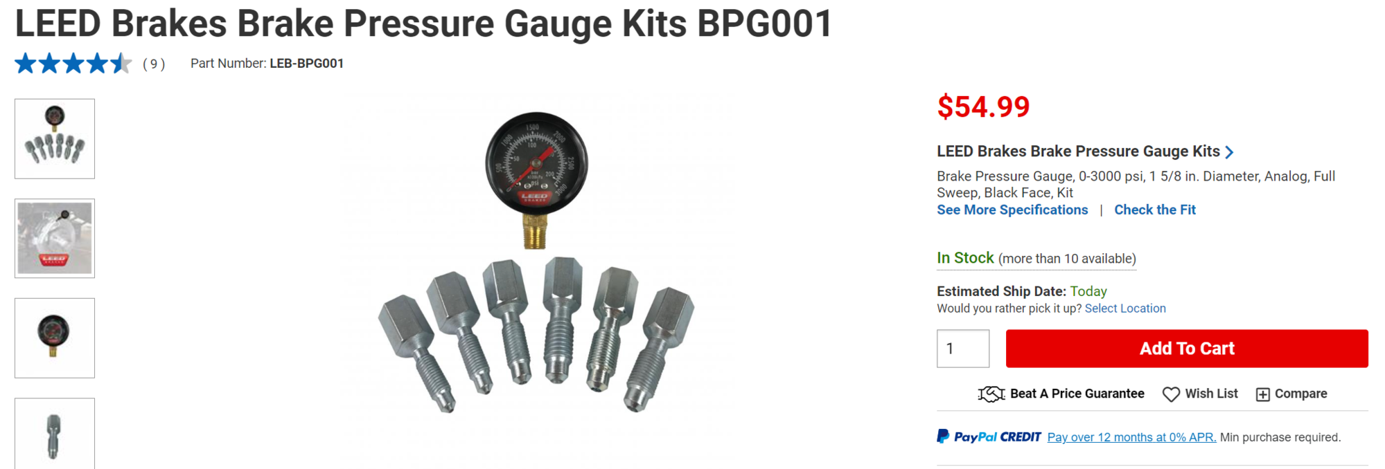

As a brake performance enthusiast I rely on a set of gauges like this. They screw into the bleeder and provide hard data.
BTW I did change the bias valve on my S4 brake setup and it does make a noticeable difference, car dives less but you have to be a skilled trail brake'r and can't rely on the ABS because the 928 has a rather simple, blunt and low resolution 3 channel abs system that will not save you in all situations like a modern ABS system can. The rear fluid channel is shared for the left and right side. ABS tech and processing power progressed exponentially in the early 90's. The 80's Bosche ABS system found on the 928 is a carry over from the Bosche system that Mercedes was using in the late 70's.

Fluid pressure measurement at the rear caliper(s) would be the data that would point a finger at the calipers or at an ABS system limiting rear pressure.
