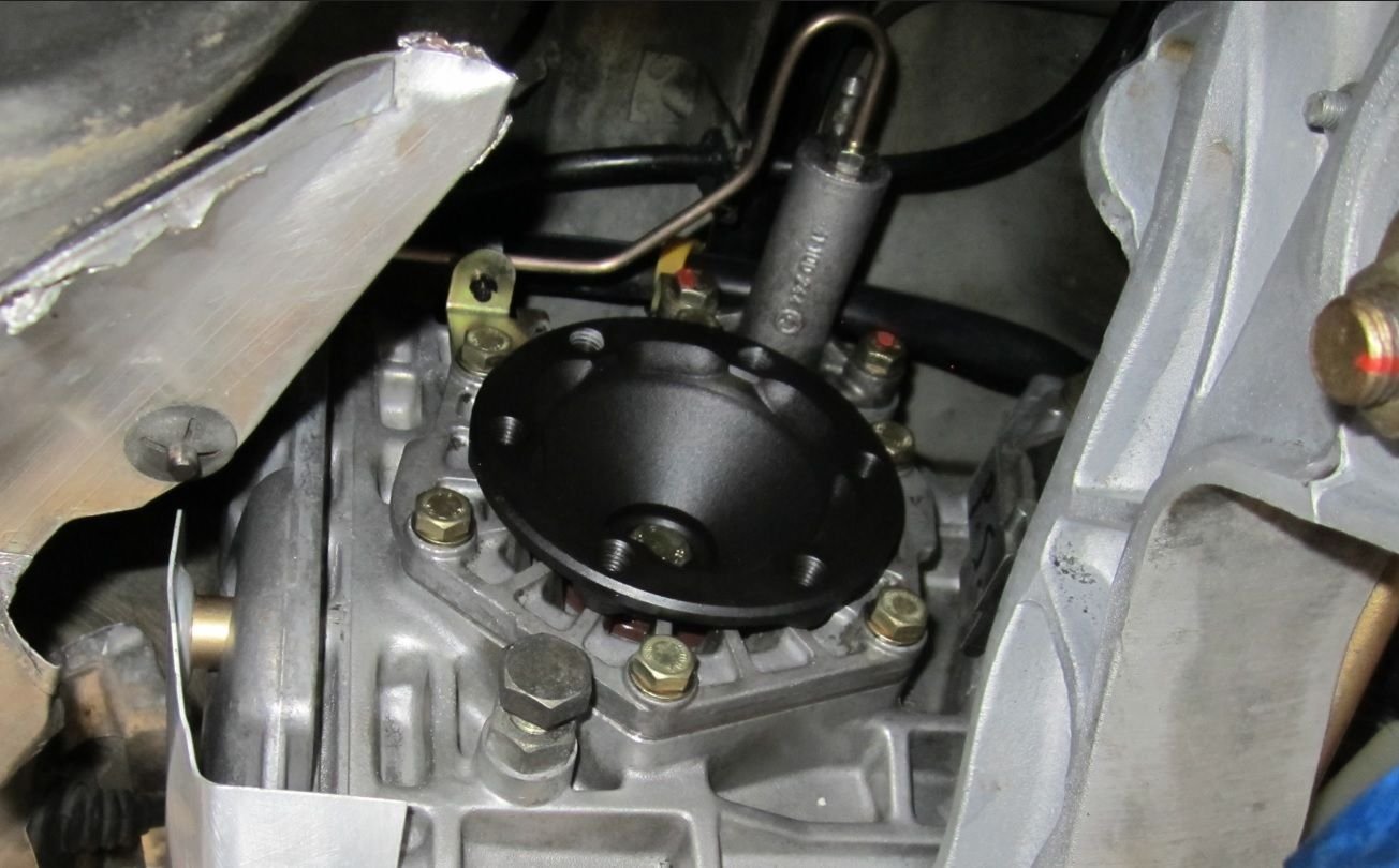

Here's a picture of the cylinder location. The only thing that's in the way is the half-shaft, but you can feel your way around it. My $.02, due to PSD pressure, always wear safety glasses, and also remember brake fluid can do a number on paint.
There's some more pictures in this thread: https://rennlist.com/forums/928-foru...l#post16414454
It's good to hear Herr Stein is still rebuilding these!

I think there are 2 main differences between the diff in your photo and my car:
1) mine has 30 years of muck and corrosion that i haven't cleaned off yet
2) the slave on your car appears to be on the side of the diff, next to the drive shaft. On my car, it appears to be on the top of the diff (i think my 1990 was an early use of the PSD and perhaps the slave moved in later cars?). In both cases, the drive shaft needs to be removed, so maybe once i have done that, i am able to get enough access. Those drive shaft bolts are not keen to come off at the moment.

All slave locations are in the same, for all models, all years, and all countries...passenger (right side) directly above the axle.
Lowering the axle may make access easier, but is not necessary.
