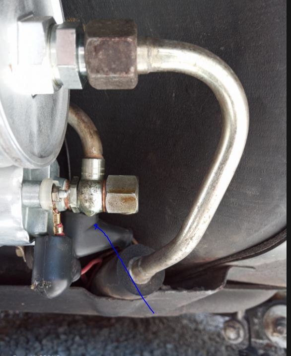

Can anyone help with why my fuel pump is dripping?
they are bot very slight leaks/drips but i want them resolved.
the crust washer is new/good.
the hose clamp is tight.
the fuel pump is new.
I have a crank no start problem so i replaced the fuel pump among other things.
Any ideas on why i have 2 drips/leaks would be much appreciated.
is the pipe clogged?
is the fuel filter backed up?

Is that rubber hose the factory part with the right size metric ends or are you using SAE sized hose and trying to clamp it tightly? If the latter, that's problem #1.
From the banjo fitting, it looks like things have not been fitted quote right and there's an angle at that fitting. With those being metal pipes that don't have any give, they need to be squarely aligned and tightened to seal. If that's as good as you can get them, Metric Hilti Bonded Sealing washers from Amazon instead of metal crush washers will resolve the leaks.

I agree with Pete on both accounts. And to me it even looks like the inner copper crushwasher is missing all together. Take it apart and change all the crushwashers to new ones..
