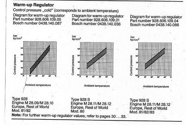

So I suspect my WUR could be the culprit.
I did a cold control pressure measurement : it gave about 0,8 bar (11,6 psi) while ambient temperature was 32 ° Celsius (90° F)….
Is this a correct pressure? According to the WUR heatup diagram, I should have a cold pressure of about 1,6 to 1,8 bar ( 23 - 26 psi) with that high ambient temperature
Does this influence my cold start ?

Here is a picture of my WUR (0 438.140.036 ) where you can see that the pin is driven quite deep by default.
Shouldn't the difference rather be about 1 mm with the top of the case :

I measured the cold control pressure and warm control pressure with engine running :
* at the cold start (temperature measured on case of WUR = 18°C (64°F)) : cold control pressure = 1,1 bar (16 PSi) -> WSM spec = 1,3 bar (18 PSi)
* warm control pressure = 3,6 bar (52 PSi) -> WSM spec = 3.,4 bar +/- 0.2 (49 PSi +/- 3 PSi)
* system pressure was 5,6 bar (81 PSi)
* rest pressure
after 10 minutes 3.2 bar (46 PSi)
after 20 minutes 3.1 bar (45 PSi)
after 30 minutes 3.0 bar (43 PSi)
after 60 minutes 2.7 bar (39 PSi)
So these seem to me all correct numbers....yet, starting the car cold with coldstart valve connected provides a hard start
Is there another component that can cause a hard start??

Your warm-up regulator has the adjustment "pin" very deep into the regulator, as you suspected.
I'd get this pin back to the correct starting depth and then adjust the pin to get the proper fuel control pressures.
You get the control pressure low enough and this will also blow the injectors open when the engine is cold.
The system pressure is reduced by the control pressure. This is what the injectors "see".
So, if you have 5.8 bar of fuel pressure and the control pressure is 1.0 bar, the injectors "see" 4.8 bar of pressure. If you have 5.8 bar of fuel pressure and the control pressure is 2.0 bar, the injectors will "see" 3.8 bar of pressure.
