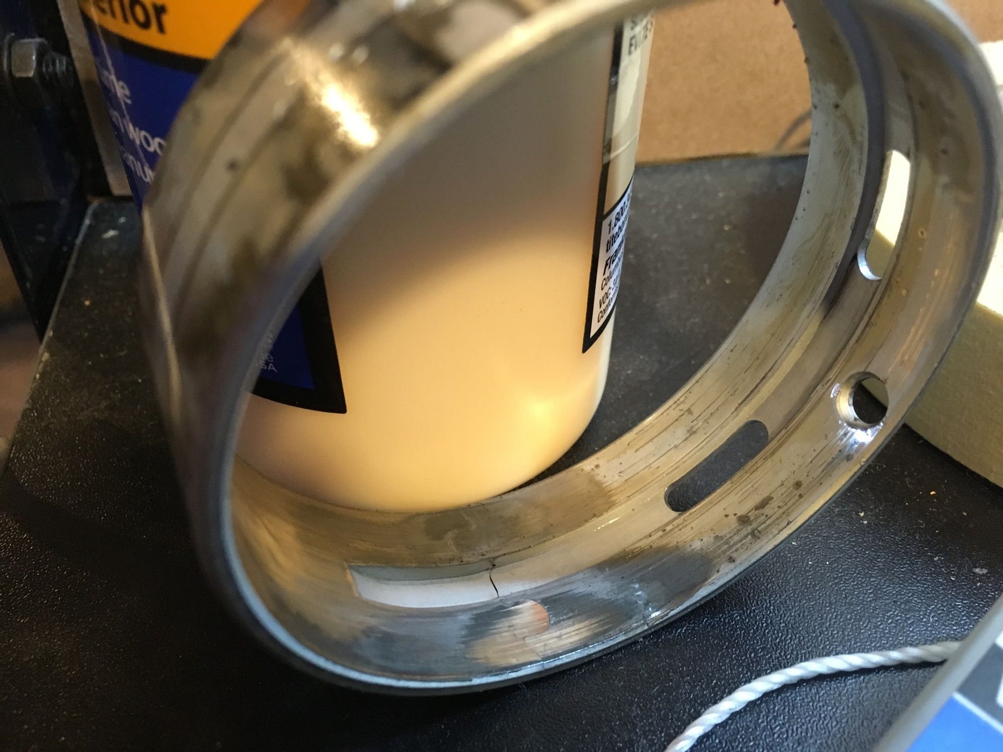

Glad I dug into this:
Here’s what I found:
All oil rings stuck. The car had REALLY thick oil in it. To the point of when I pulled the plug out nothing came out for 30 seconds.
small crack and worn front bearing:
The rest show wear enough to replace:

Good catch.
Re front bearing there is a join with a key feature that looks like a crack but is normal. Note its tricky locating the bearing when you reassemble as you need to locate the roll pin in the hole that is presumably there to stop bearing movement/rotation.
Note also in case you are thinking about getting the crank journals polished, there has been much discussion about sludge entering the oil galleries and being difficult/impossible to remove completely. There has been previous discussion about this contributing to engine failure. When i redid my bottom end I had the journals polished before i realised this but if i were doing it again i think i would leave them as is unless there was major damage. Greg et al can say more about this - i only have a data point of 1 and still havent restarted my engine to know if i did a good job!
