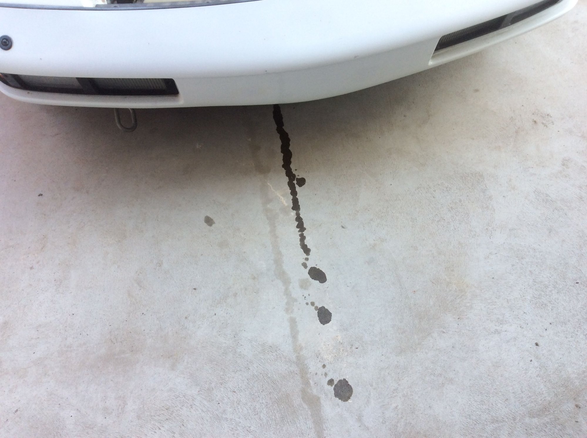

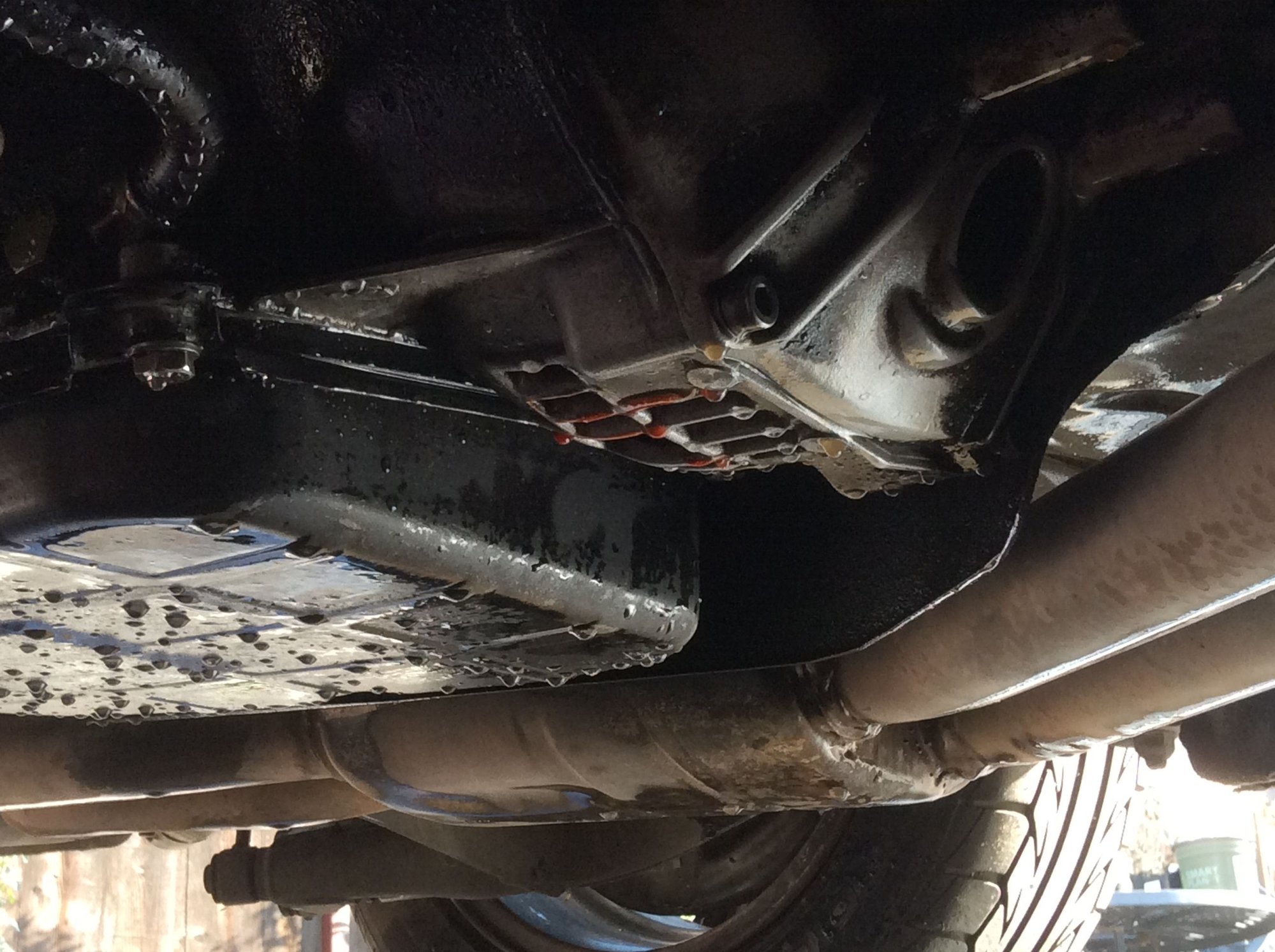

my trans is leaking like it opened a vein
maybe unrelated, but I just did the vac line refresh, and the 6 way was broken on half, so the trans was not getting any vac prior.
could it be that reintroducing vacuum caused a leak?
could it be the torque converter?
see pic of location of leak, any guidance is appreciated

pull the trans and TT as a unit rebuild the TT and reseal the trans,
remove the pinch bolts first.

I had the same in the past, it was the Tranny pump o-ring behind the TC. Tranny needs to come out to replace

Trans pump seal, torque converter seals and bearings, rebuild trans lines, and there are a few parts you wanna replace in the transmission while it is out (that can be done from the outside) at the very least.

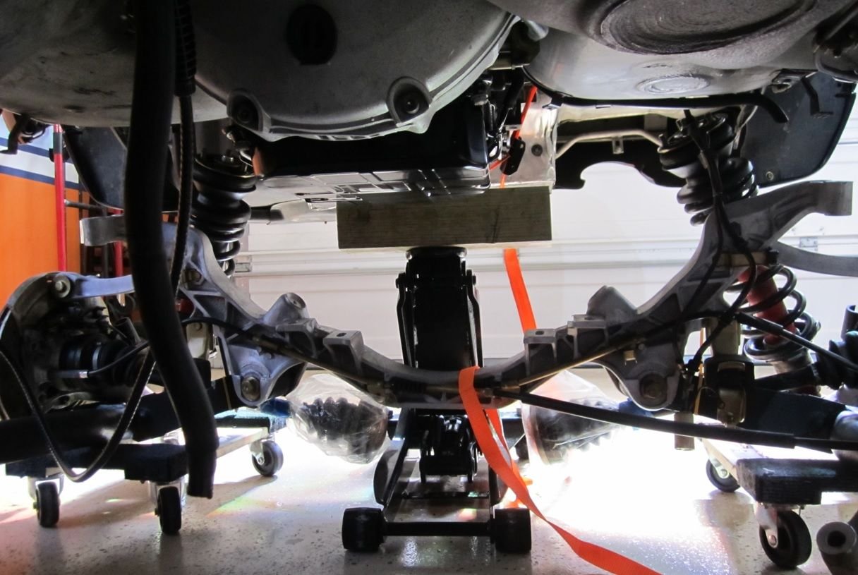

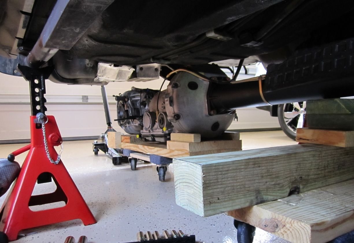

Yes, this is very doable on jack stands. And the whole read cradle comes out...as ONE piece. It's really very simple once you see how you do it.
Get some furniture dollies like the movers use.
Heres a good set of videos...
This is very doable on stands...and no special tools required, just time.

If the front oil pump O-ring is hard and leaking, all the other internal O-rings and rubber piston seals are exactly in the same condition.
I get these transmissions in, for rebuild, when they no longer function from O-ring and seal leakage, which causes the band and clutches to slip more, wear more, and burn up.
A 3K rebuilt can end up costing 6K, when using the Genuine Mercedes pieces.
Rebuild the transmission and replace all the internal rubber parts....you will be over 50% of the way, with it out and partially apart, anyway.

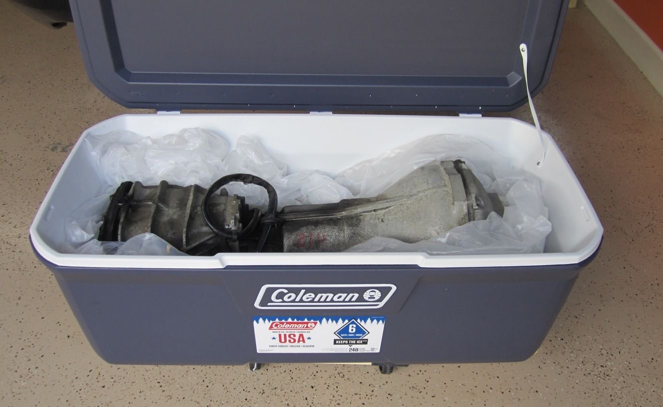

Hi Brent - You're fortunate that you live in California and Greg's not too far away. Whether you drive your transmission down to him for repair or freight, a 150-court cooler is the way to go.
I'm with Jeff (Speedtoys), furniture movers made the job much easier - whether it was lining up the transmission w/ torque tube attached or sliding the rear suspension around.

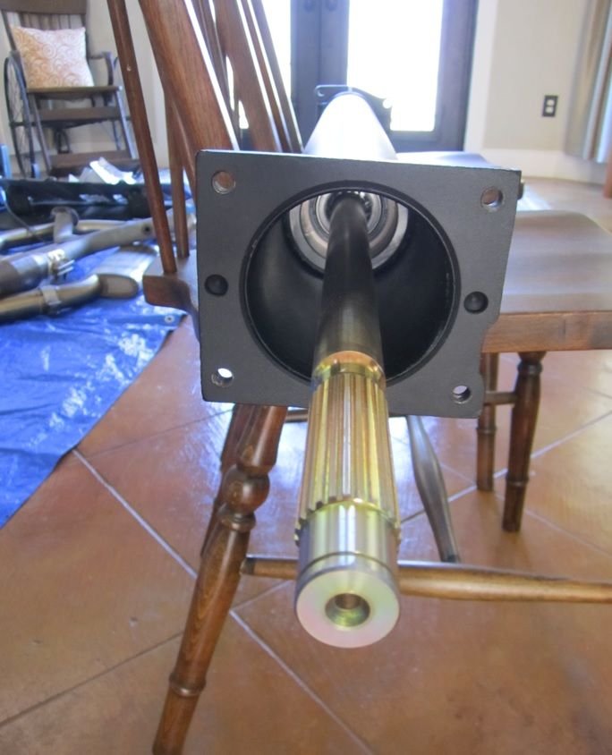

I would have your torque tube rebuilt at the same time - either by Greg or send it to Constantine. When you ship that, you use a pool noodle to protect the splines.
Anticipate a lot of crumbling rubber pieces that will drive the cost up. E.g., the ABS sensor grommets.
In addition to the video's Jeff posted, I found Dwayne's write-up incredibly useful and accurate: https://rennlist.com/forums/928-foru...re-w-pics.html
