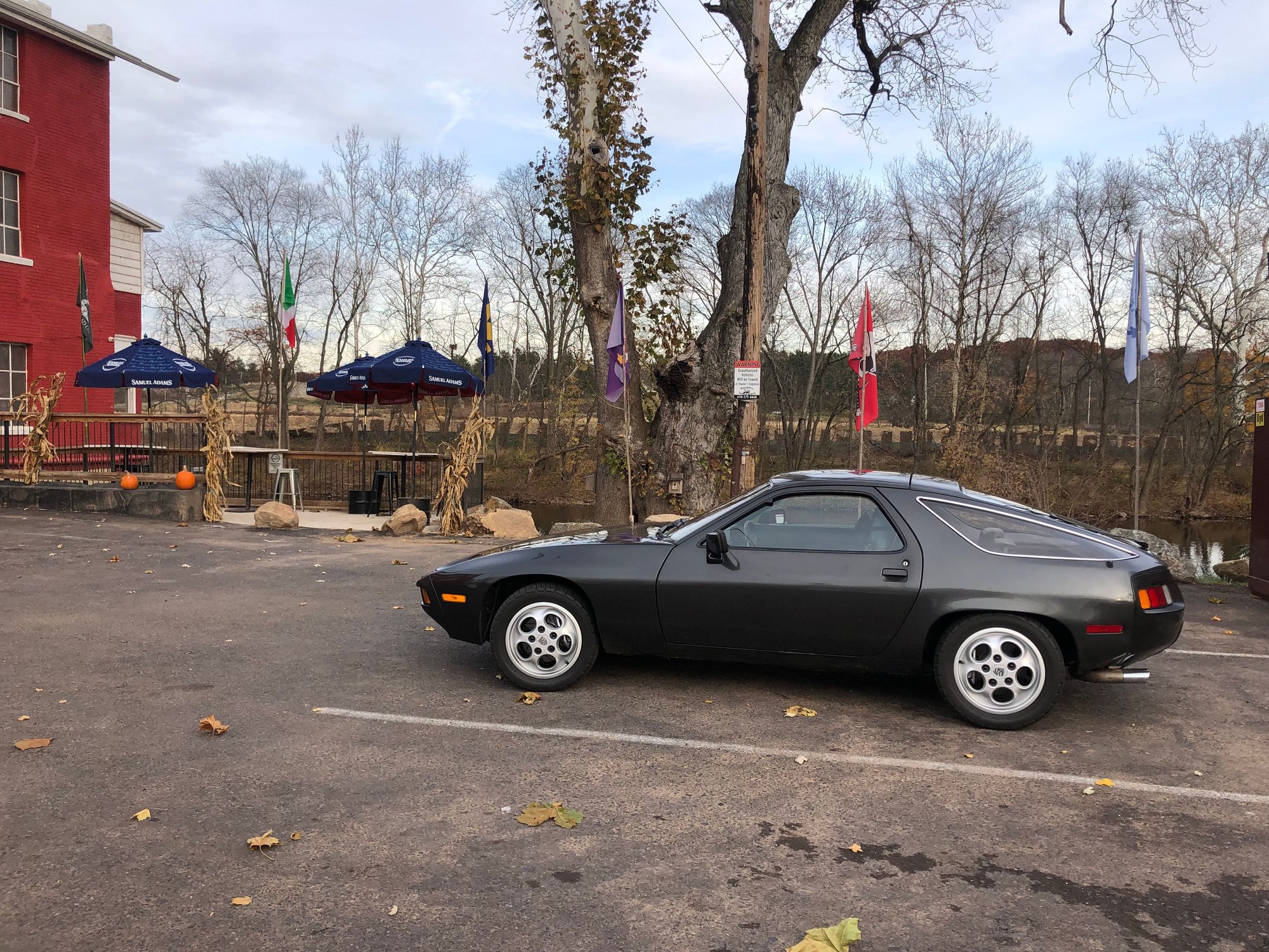

Been lurking here for while so time to get my feet wet. Car is 1979 USA very original as best as I can tell, build date 05/79. Bought it from son of original as the story goes, who became unable to drive. Unfortunately, only paperwork I received was some invoices from 2014 and 2016 for work performed at Porsche shop in Broomall,Pa. They only put a couple 100 miles on it when I purchased it in Sept. 2019 so it sat for 5 years. I got it running and had Stan do some of the necessary stuff to make it safe. (he is the man)

Don’t worry, we all had to start somewhere! Car looks good.

Wow, that's a nice one. I am jealous.

@cpierso Beautiful black '79! I disassembled my WUR and saw much sludge/junk in there after buying a set of CIS fuel gauges showing extremely high cold pressure. After cleaning it extensively several times, the cold pressure improved but still too high. Stan also helped tremendously. I ended up sending the WUR/FD to (specialTauto.com) for rebuilt of my specific units. Awaiting for spring to install and check. Hopefully, you will get it running well soon!
