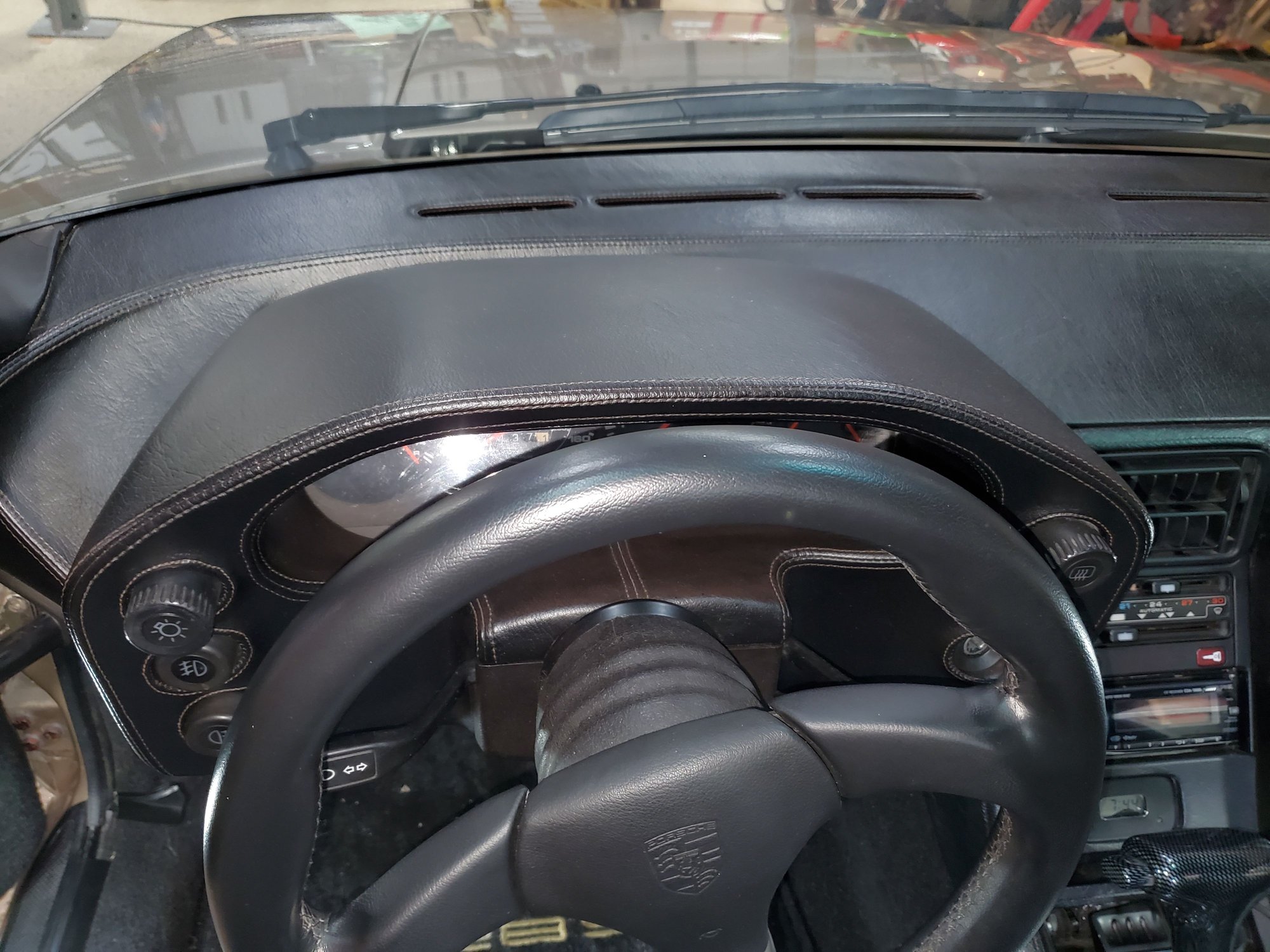

Have it recovered in leather. Looks a lot better and lasts a lot longer. I've done this on all 3 of my 928s.
Convertible was done by Rob Budd, on the white car I ordered one from Mark Anderson, and the bronze car came with it already done.

i have tried about everything. Best to just get it recovered....best thing i did was sending mine off to classic9 and using black Alcantara
the issue is with temp changes and the expansion/contraction involved. it may look fine on your bench in the garage but bring it inside to a warm environment or sit it near a heater (think dash in the sun), the split WILL reappear....and vice versa ..hot to cold.
or raise the pod/binnacle so its out of your sight line
