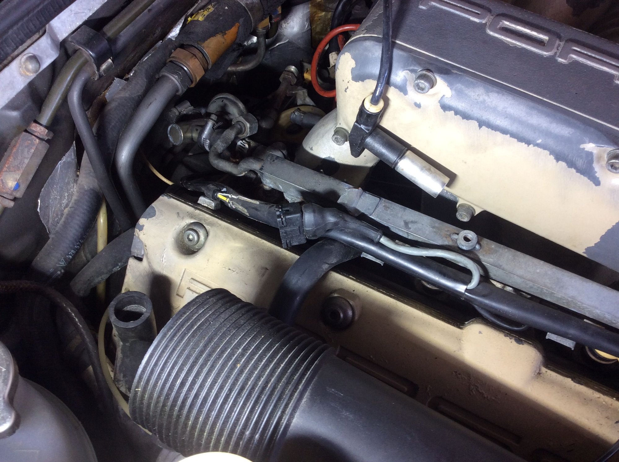

87 five speed, trying to change the crank shaft sensor on the flywheel, removed the hamper and pressure regulator then went after the sensor, took out the Allen head and tried to remove. Thought I traced the cable to the right side of the fuel fail to a plug, so trying to unplug the cable plug fell apart! Finally got the sensor to move and with PB Blaster and a lot of twisting the sensor came out! But I found that the plug was not the one I had undone and tracing it it seems to run up under the manifold, so what is this for and have I really screwed up?
Plug and three male pins, sensor does not go to this plug.

Rear knock sensor.

The PS injector rail is in dreadful shape. The knock sensor bracket is missing and the connection to the fuel regulator is crushed. You need to replace it.

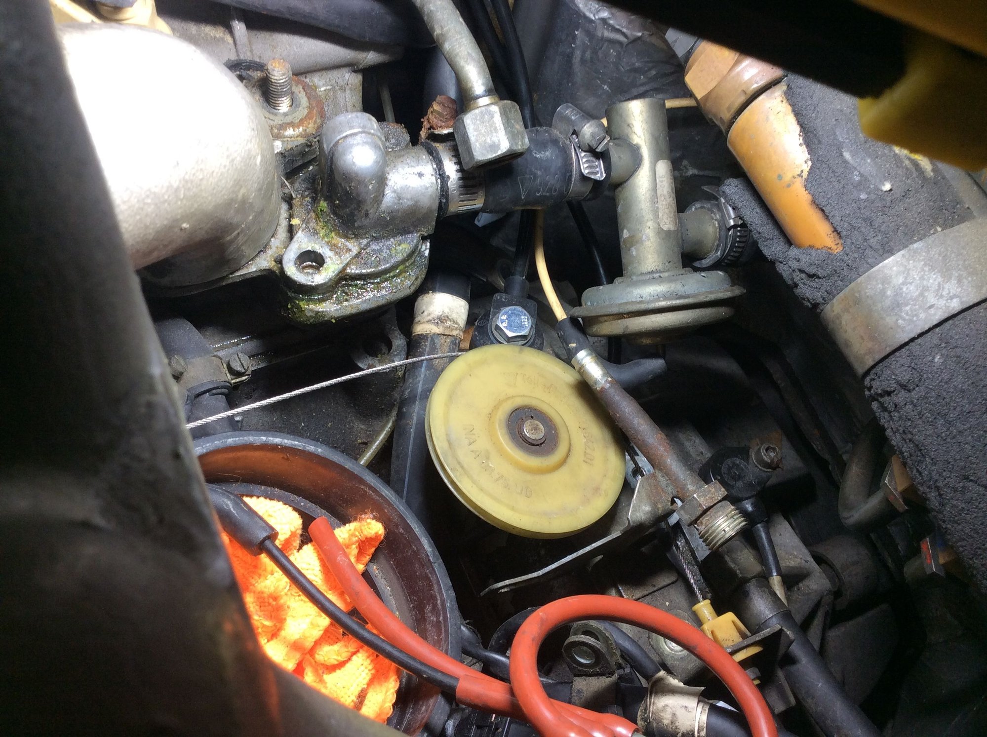

Well it was the rear knock sensor(KS) plug, and some of the gas hoses look bad, just got new ones in. I did clean the grounds on the big white wheel bracket. So what I have done is used the left side bolt that is longer to anchor the knock sensor, the white wheel is free and I can plug the KS into the left side harness. I realize that it is in the wrong spot but hope to fool the computer while I get this car going. So all I see happing is retarded spark or maybe it will fool the ECU but I will lose some knock protection. I will not be racing or running hard so I think I can get by with this until the intake is pulled for a rework. Is this totally dangerous? I really just want to get the car running for now. New hoses, reworked ECU and MAF, cleaning all grounds and fuses with three new relays.

The fuel line is OK it is the angle that makes it look crushed, the KS bracket is missing. Here you see the placement of the KS under the shiny new longer bolt next to the white wheel.

IMHO, you're better off leaving it unplugged, loose the 6 degrees timing which wont hurt, and save up on that full top end refresh to remedy this.
KS position is important to their operation..and this wont pick up knock right or at all as expected in this position...

Yeah, that's not where the knock sensor goes. It goes in the center of the engine, almost directly below the butterfly in the throttle body.
If you remove the large rubber elbow to the intake throttle, you can gain enough access to put in a new rear knock sensor.
