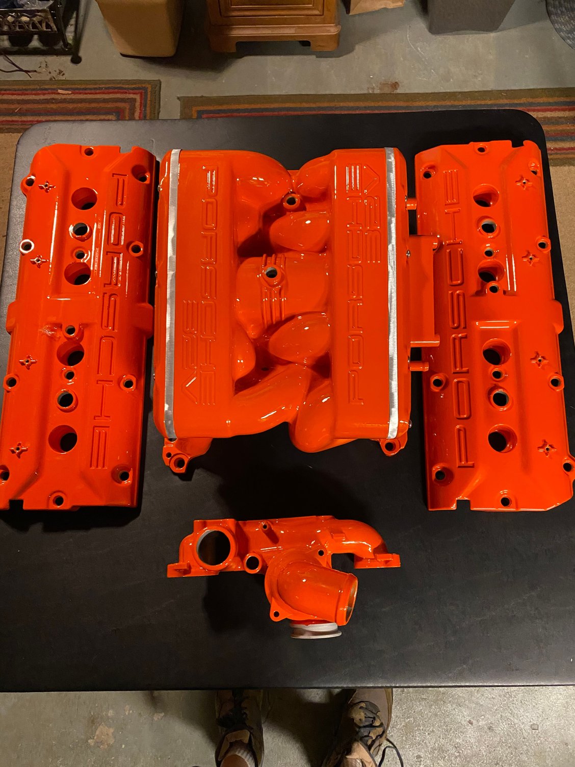

Default It’s a HEMI right?

Not really; but it is kind of a semi-hemi.

Hemispherical combustion chamber = Hemi.

Mildly concave combustion chamber = semi hemi.

The color is right. Valve covers even look kinda similar in shape between the 928 and the new hemis.

Those look great; who did the work?

http://www.kkfinishingco.com
Kris

Wow. Looks awesome!

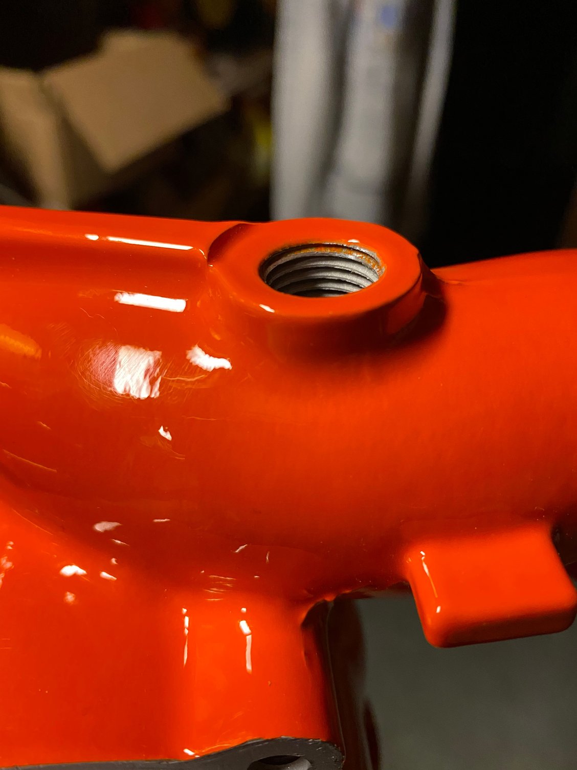

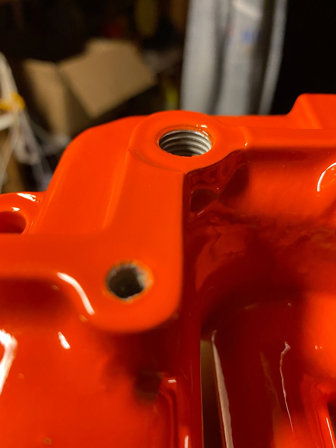

WOW thats some nice PC work
NOTE on the that water bridge ,
make sure to remove the coating under the anchor bolts and the sender surfaces,
so the unit will be grounded, otherwise the temp 2 sensor can give false readings, same for the pod temp sensor,
good luck on your refresh !

Awesome. Looks like Clemson orange!

To be a bit pedantic ('cuz that's what I do), "HEMI" is a trademarked marketing term.
The M28 motors don't have truly hemispherical heads, as noted above.
But they do have some similarities, both appearance & technical.
