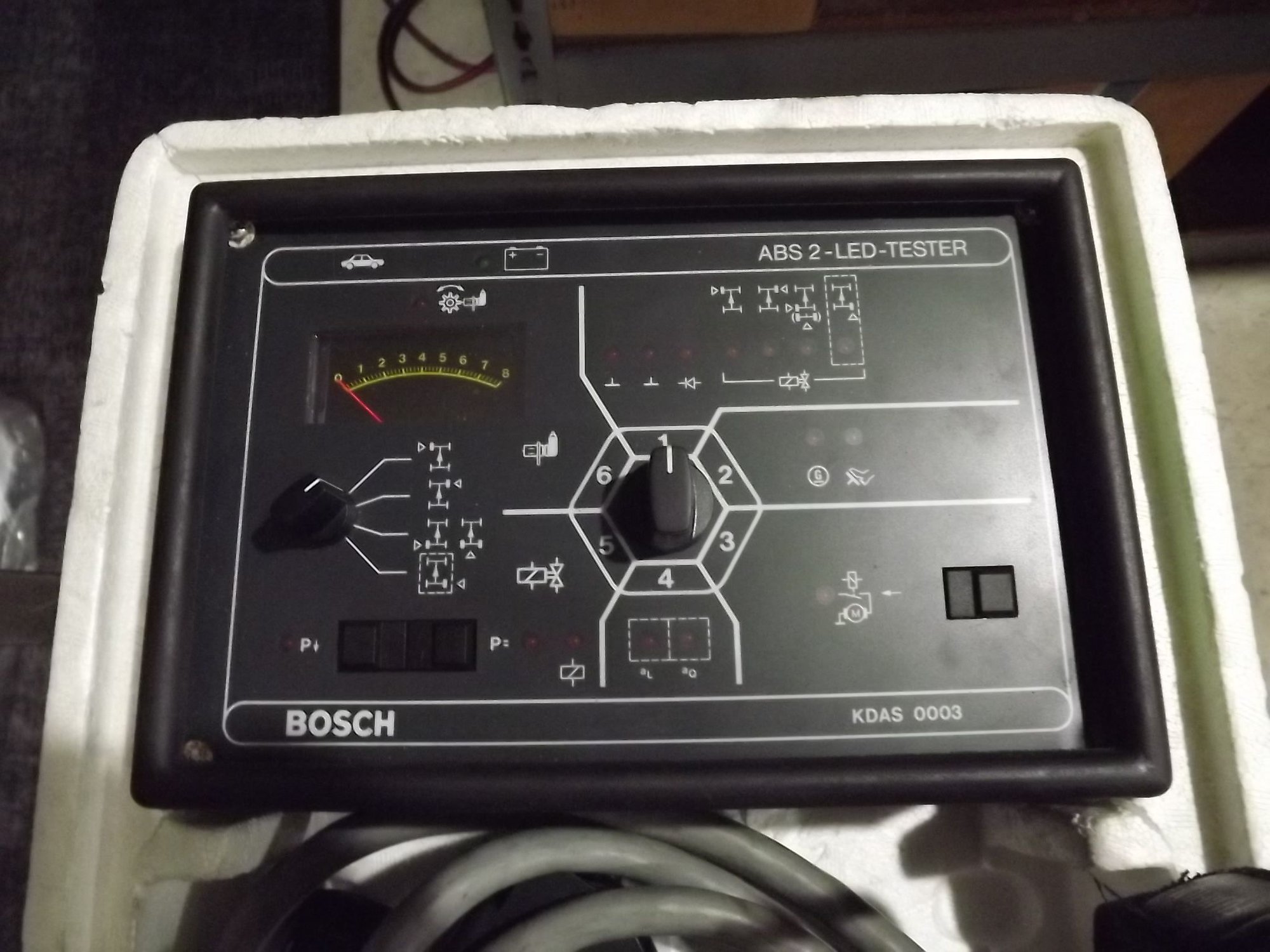

Old Mar 30, 2021 | 05:04 PM
GregBBRD's Avatar
GregBBRD
Former Vendor
Joined: Feb 2005
Posts: 15,228
Likes: 2,529
From: Anaheim
Originally Posted by javiherdepa
And what is Greg's tool?
This:
Bosch ABS tester
This unit plugs into the harness (replacing the computer) and checks everything, including the harness.
Intermittent problems can still take time to isolate.
Sometimes we need to drive around with the tester hooked up and monitor different wheels sensors/other functions to find the problem.
For instance, I've got a 928 here (which just came from another shop), which lights the ABS light about every 5-10 miles.....and then immediately resets the light, if you cycle the key.
Extremely intermittent....as some of these are.
Even with the tester, that could take some time (and luck) to isolate.
It would be great if the tester had a memory (which one could go back and read, in order to see what just messed up), but it is way too old for that technology.
And being just a simple mechanic, I'm way too stupid to add that function in.
