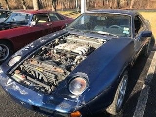

In the process of reseal/gasket TB WP ect on the running > 100k miles M28.21 motor 4.7L from the 1984 Euro S parts car (Blue/Blue),
Gears Certainly look shot to me. All have indentations on the edges from belt wear you can feel with your fingers. Belt was fine. The Oil pump gear is the worst but even on the crank gear (steel) I can feel wear. Will have to check the gears on the sister engine that came out of the White donee car. Hopefully there in better shape. If not what are my options? Refurbish or replace?.
Rt facing
Left facing
OP
OP

Yes, all those are bad. There's not really any refurb option once the teeth are visibly cupped like that. Make sure you get a steel replacement oil pump gear.
