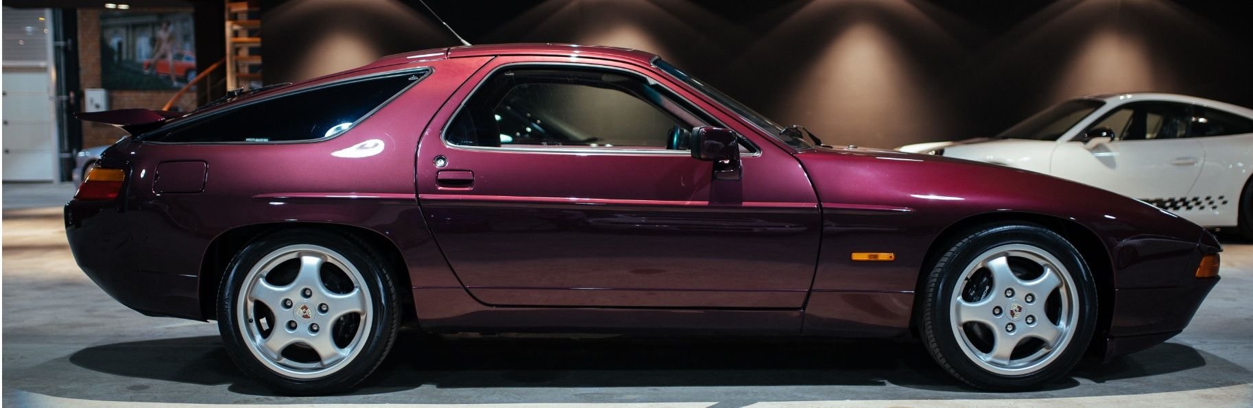

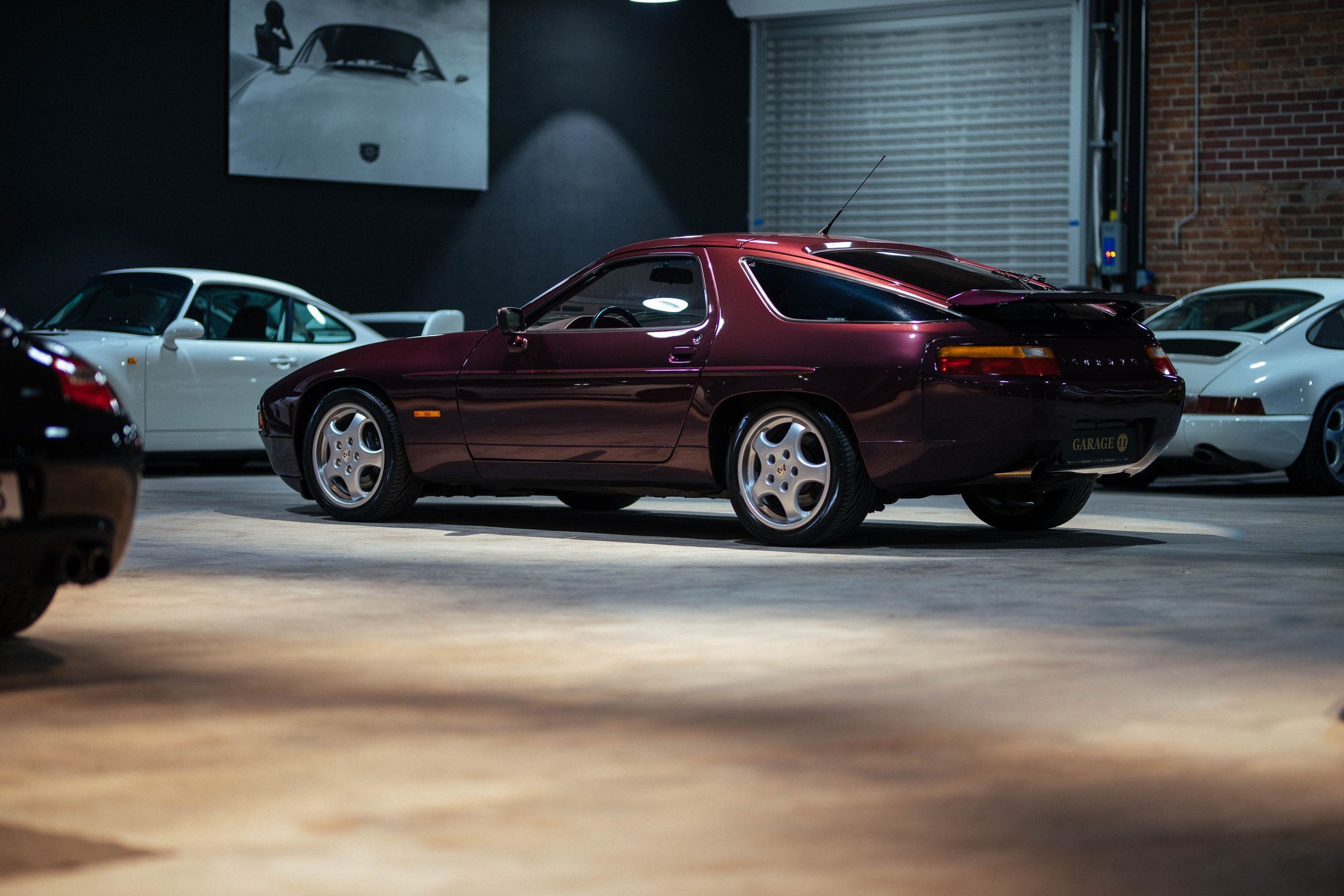

My name is Tomas and I am the prowd owner of my 2:nd shark, this time it was an 928S4-91 Automatic.
The car is (was) in a fantastic condition until an accident stroke me. A driver in a BWM hit me in the back and the car is now in the workshop. The rear bumper needs to be replaced + some minor body work.

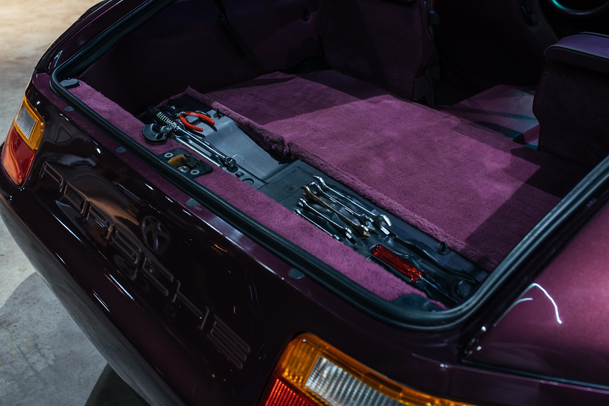

Now the question: on my car the rear bumper has a big Porsche inscription between the taillights. (928 505 123 22) but the workshop informed me that they got a rear bumper model w.o. inscription proposed by the Porsche agent (928 505 123 22 G2X) instead.
Does anyone know if there has been a replacement of the spare part and most important: is this design ok for my ear model or will it lower the value of my precious ??
Below how it looked before this sad day....
Kind regards
Tomas Wiak
All comments are highly appreciated.
My precious....

To the OP's question --
The original rear bumper shell has been out of production for a while now. The replacement since offered from Porsche is the fitment for the later GTS cars, and includes a red reflective insert connecting the tail lights. On an earlier car (1987 to 1991) it's a telltale that the car has been damaged and the shell replaced. Your car is not a US car, by appearance (side markers) or license plate in your picture, so I'm guessing you are not in the USA. 928 International here is a very reliable supplier of used parts, and does quite a bit of international shipping so worth a phone call. Their number in the US is 1-714-632-9288. Your other option is to shop for a used shell closer to home.

Geeee, you have a knowledge as a dictionary. The telltale about the damage is the worst thing. Need to sleep on this. Many thanks for the input !

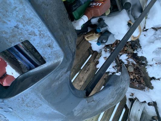

I have a rear S4 PU cover that will need to be stripped but should be presentable.
You pay the shipping its yours from 19027 USA.

if you can post a picture of the PU you have it would help,
mine has a small part that was trimmed off around the exhaust tips,
Mine is a lil bit warped but i think that can be fixed by pouring boiling water on it ,
its has a slight wave around the letters,
and needs to be fully walnut shell blasted.
You can see a slight wave in the letters at the ORS,
hot water will reform it
.and the edge that was cut off around the muffler tip you dont see that part as the tips cover it .
