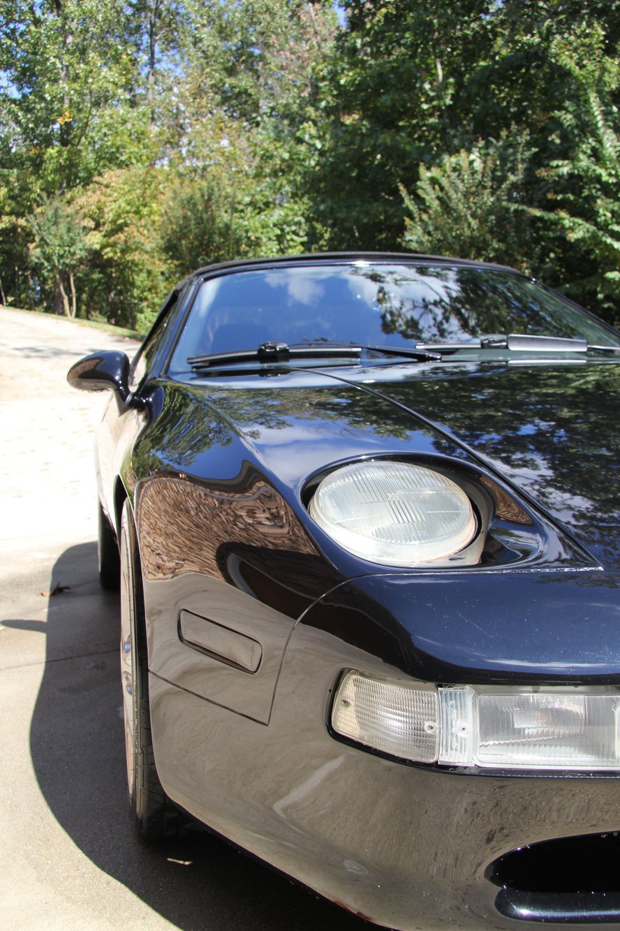

An 8" et 65 is about ideal. These being 8.5" if they had the same offset would be 1/4" further in and further out, so 6mm or so, but then the offset difference of 65 to 52 is another 13mm, together that's 19mm or about 3/4". Visually, I think these are going to stick out from the fenders too.
Personally, I don't think using those is a good idea unless you have your ride height set at the OEM 4x4 look and have the front fender lips rolled. My car is set a bit low, but I ahd an 8" et52 wheel on it and the tire caught the fender lip in a medium speed turn with a bump in the center. I swapped those for an 8" et57 wheel, rolled the fender lips and haven't had that problem since.
Here's my 8" et 57. These wheels you're looking at would be 11mm further out. (wheel is turned a little in this photo).

Do you have a supplier of the wheels with the correct offset please, if so could you send me the link as it would be much appreciated and she’s sitting very pretty mate, if I do say so myself looks naughty
