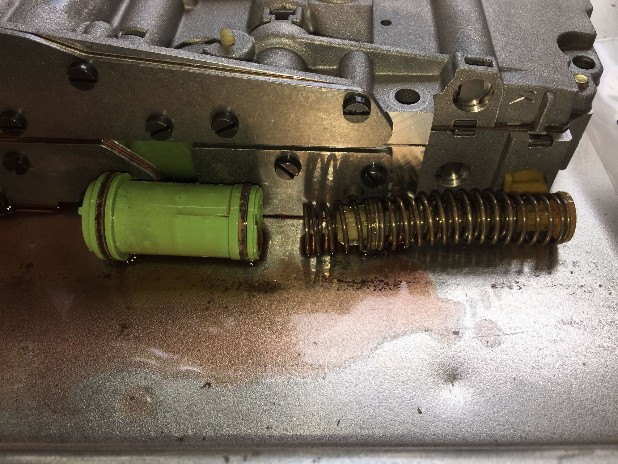

Originally Posted by karl ruiter
I suspect your improvement was as much from getting a cap on it as it was from the adjustment. The cap is required for it to hold vacuum and work correctly. The caps don't hold up spectacularly well over time.
Agreed. I put a new cap on the modulator on the Red Witch in July of 2016, and by late October it already had cracks.
Originally Posted by GregBBRD
Yes, you have them.
On the pistons inside the valve body....behind the side plates. Not listed in PET. Only available from Mercedes.
A-HA!!!
I know exactly what you are talking about. Thanks!!!
The dark rings on the green plastic piston are the teflon seals in question.

Originally Posted by 993turbo
Actually a huge improvement in the way the car shifts. Like driving another car. :-)
Yes, the adjustment did not fix it, the cap did.
When the cap is removed, there is not a vacuum signal to the modulator and the transmission shifts very poorly.
A-HA!!!
Yup, that's them.
Except they start life white. (Some have colored dots on them to help identify which one is which.)
Like any piston ring, they wear. This allows more fluid to flow past them.
Just installing "fresh" Teflon rings makes a rebuilt transmission shift much better.
"Rebuilding" a valve body is completely different than taking one apart, cleaning it, and re-assembling it....
Yup, that's them.
Thank you! I have already started down the google 'rabbit hole' of trying to find Mercedes part numbers for these teflon rings. I will replace them at the 1000 mile fluid change after I get the Red Witch back on the road.
