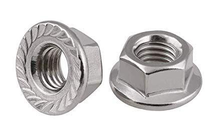

I am rebuilding the front suspension on my 79. I misplaced one of the nuts that hold on the lower ball joints. I was thinking of just buying 4 new metric nuts. They are M12 1.5. Are these factory nuts tapered at the top for a reason? They don't appear to be locking nuts? I was considering replacing these with either regular grade 8 nuts with lock washers, or a grade 8 serrated metric nuts if I can find them.. Any thoughts on the matter? Thanks a lot.

I believe they are jam nuts. If I was in your place I would call one of the 928 Parts suppliers and get a replacement nut or substitute a Grade 8 Nylock nut. The serrated nut would most likely move the alignment settings as you tighten it

The original nuts are Conical Lock Nuts.
https://www.belmetric.com/metric-con...ruddq6s4k687q2
Porsche now (or did, last time I trusted Porsche for fasteners) ships serrated flange nuts.

Great, thanks a bunch guys! Looks like these are the original nuts. I think I will order some new ones for good measure. How does a locking conical nut work? Is the thread tapered at the top of the nut or something so that it squeezes itself on? Are these better than just using a standard nut and lock washer? Just curious is all. I'm trying to finally get this front end rebuilt. I am trying those newer upper and lower control arm bushings from powerflex. The original set I got from them were too big.and would not fit. I had to assist them with some detailed measurements and they remade me a set that fits perfectly. Makes me feel like I was one of the first to try their 928 bushings (bought them a while back). There are guys on the list that say not to use poly bushings, but there's no turning back now. Personally, I think my front suspension, between the Koni's and poly bushings is gonna rock. Only time will tell!
The top opening is distorted, oval.
They are better than a standard nut and lock washer, because they cannot come off quickly if under-tightened.
